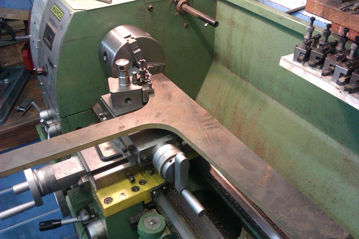

          #803574
            Before I took the slide off I took a couple more photos
            This one shows that it should be possible to use the existing studs to mount the slide sufficiently so that it can be used to drill & Conterbore either a plain plate or the tee slotted one.

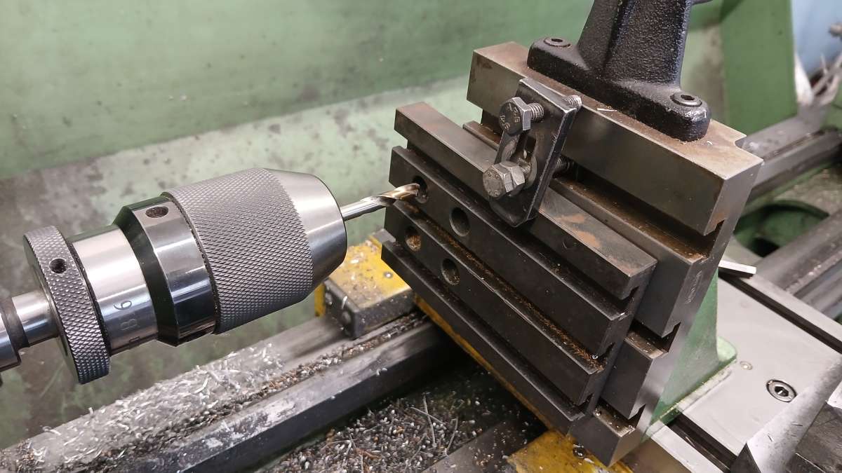

            20250619_092851

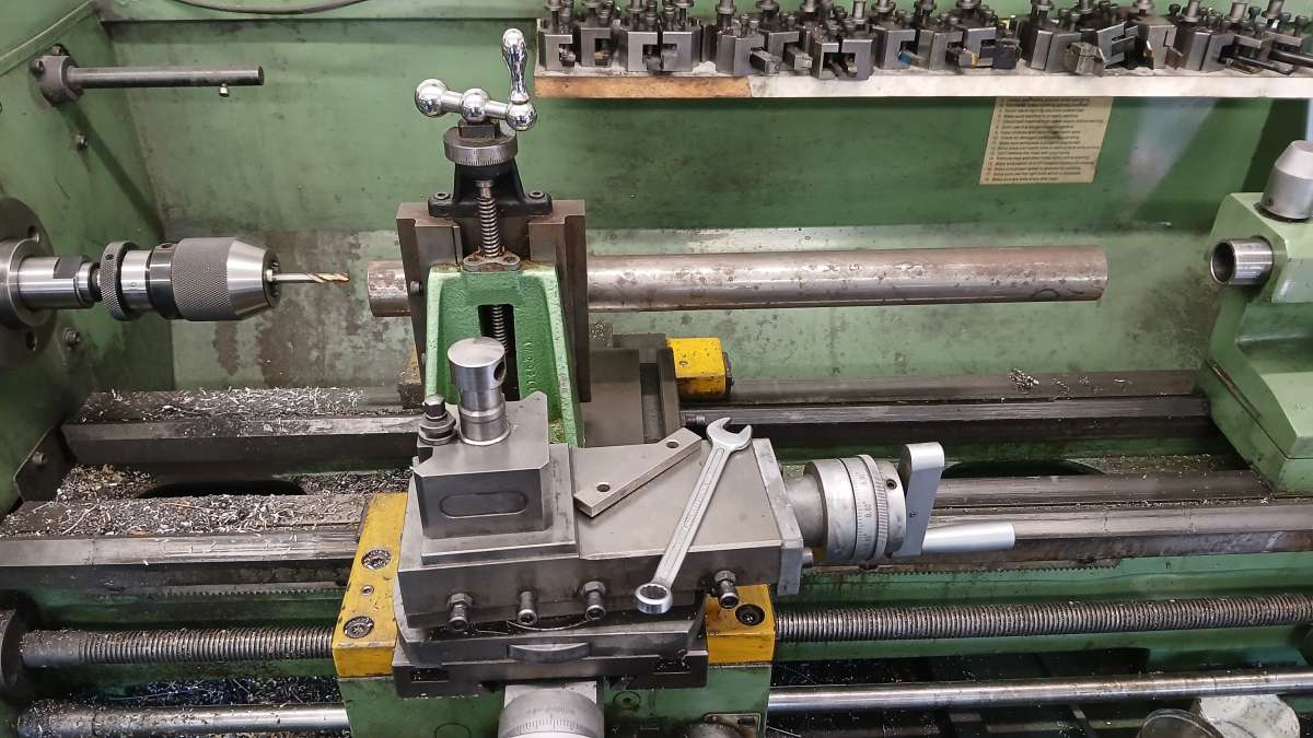

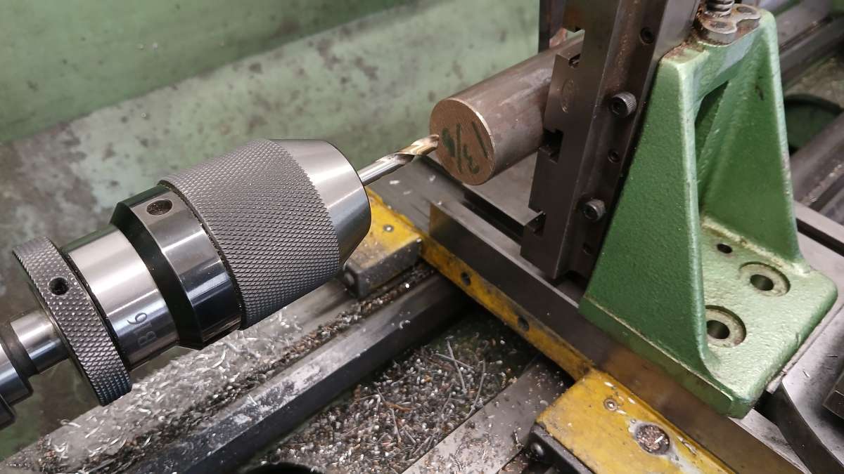

            And another example wher “any mill” is not going to be better than a milling attachment. If you want to drill or mill the end of a long bar that simply won’t fit under the spindle of your mill then a vert slide will usually accommodate a long part.
            20250619_093435
            20250619_093443
            Though if the part is not too thick that it can’t go into a toolpost then long items cam also be held in that

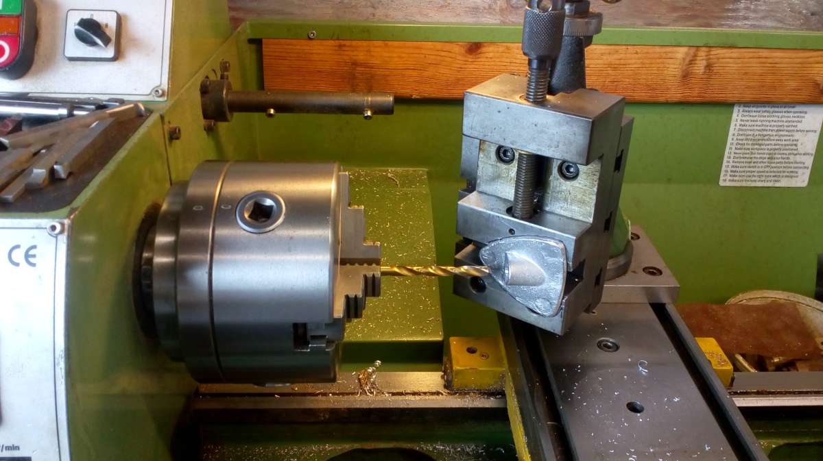

              I did quite a bit of milling on the small Myford Speed 10 that I used to have, and brought over the Myford Double-Swivel milling slide and vice that I’d used when I bought a Warco WM250V ten years ago – I chose it on the basis of the broad T-slotted crossslide, the powered cross-feed for milling and the baseplate Warco sell that’s reasonably easy to mount the Myford milling slide on.
              The T-slotted crossslide top gives you a lot of flexibility over where you mount the milling slide – for example, you may well want to mill part of the workpiece protruding from the vice which could cause you to place it differently from when, say, flycutting a flat surface of a component.
              Plenty of folk will always say it’s very limited as compared to a proper mill, and they’re right – but I can’t see that I’ll ever have the space for a proper one although I spent years in my twenties running one for my daily bread. For model engineering, and some full-size that I’ve done, I’ve always managed to find a way to do it – so far.

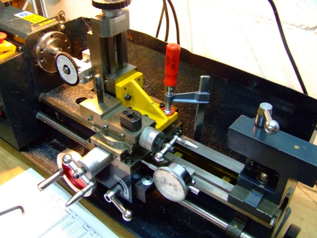

                I agree that vertical slides work well within some limitations. As always reduce overhangs as much as possible, lock the slides that are not being used (some additional clamps can help) and take fairly light cuts.
                The picture is milling the lobes on a camshaft using a mini lathe with an additional clamp. The DTI to set the depth of cut is clamped to the bed.
                Milling with a Mini Lathe
