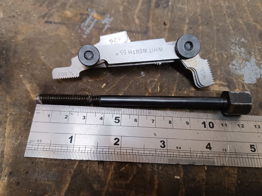

      I was tramming in my Twin MillDrill and i overtightened the cam lock head bolt and broke it.
      Where would be a good place to get one? Its 110mm 1/4 BSW 20G with about 50mm of threads.
      Can anyone suggest somewhere? I assume it needs to be hardened bolt?

        Need to get one of these?

          Looks a bit of a one-off with a head that size.
          Could you get by with a ¼" UNC bolt? if so Spalding fasteners sell them
          https://www.spaldingfasteners.co.uk/1-4-unc-grade-8-10-9-hex-head-part-threaded-bolts-yellow-zinc-plated/
          Is the hex head on yours 7/16" 0.438" UNC or 0.445" BSW?

            I'd think it tough rather than hardened – you want accidents to break that, not the more critical parts.

              Thanks. The head doesnt matter at all. Any old hex head will do. So yes, i can almost certainly use the spalding one.
