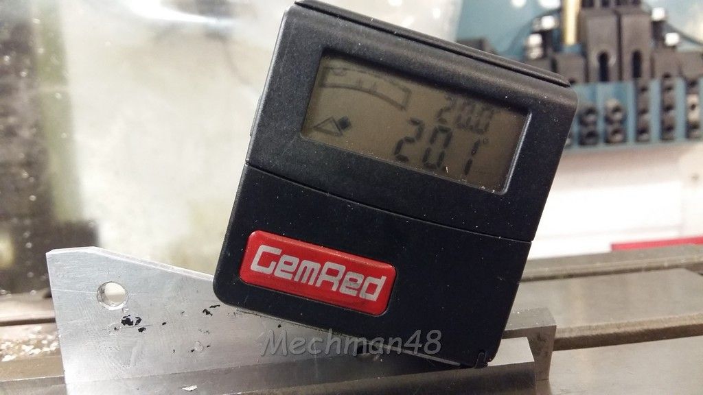

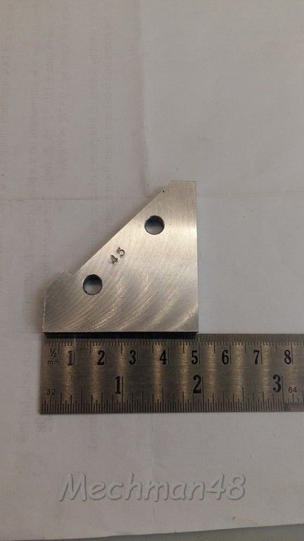

                                            mechman48
                                              @mechman48
                                              Like others I have a couple of ways of setting angles; Stainless protractor with pivoting straight edge, Digi gauge, M & W protractor /rule, plastic protractor ( from school pack ). Using the digi gauge I always set the zero relative to the mill table. I have since made a set of angle gauges using trig' some previous write up a member had written up ( can't remember where dont know  )     & checked relative to the Digi gauge, all within +/- 0.1* which is more than acceptable for my use. I would like a sine bar, but would I use it… probably once a year, if that thinking . a couple pics of home made set …
                                              George.
                                              Edited By mechman48 on 14/08/2020 11:53:32… flippin smiley!

                                              #490589
                                                Posted by mechman48 on 14/08/2020 11:52:46:
                                                Bad news: confirming George's angle gauges with that Digital Gauge is no cause for celebration! Good news: as there's no reason to doubt Mechman's craftsmanship, his gauges should be more accurate than that type of Digital Gauge. Although digital display precision is 0.1°, accuracy is more like ±0.2°, meaning home-made gauges should outperform the bought item. I'd bet money George's do!
                                                Although it doesn't matter for many applications, a 0.1° angular error is non-precision. Some tasks are more demanding! Waiting for rescue mid-atlantic a 0.1° navigational error makes the search area about 1100 square kilometres. Could be a long cold swim…
                                                Apart from tapers, tramming and other right-angles I can't think of any home-workshop jobs needing high-accuracy angles. What's the most accurate angle the team had to set, and why?
                                                #490596
