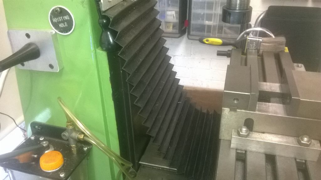

      The rubber sheet which covers the Y axis screw behind the table my new mill is pretty stiff and unwieldy It doesn't take well to being crushed up when the knee is high and close to the column and I have already managed to put a rip in it when it caught on the back of the vice. Can anyone suggest a lighter more flexible material – is leather a possibility?
      Thanks, William.

          I suspect that anything water / oil / coolant proof would suffice; as you say leather, plastic table cloth type material, thinner rubber sheeting etc.
          George.

            The way cover on my Warco VMC mill (aka Chester 626) suffered the same splitting as yours, William. It was swiftly replaced with a concertina type from ArcEurotrade, as shown here.
            Way cover
            I was able to use the existing tapped holes and the job was completed in a few minutes. It is far more flexible than the original and in over four years has resisted all the swarf and general gunk that the machine and I have thrown at it.

                  I destroyed the original rubber cover within the first 30 minutes or so of using the machine. it has been replaced by a piece of leathercloth which I find to be very effective and have only replaced once in the last 10 years (due to be replaced again in the near future). I have only covered the top of the knee and left the vertical column uncovered as i find that i use this space for a magnetic clock stand on occasions. Replacement of the original thick rubber sheet has given me an increase ib Y-axis travel.

                    I use silicon baking sheet,it's about 18 pounds from a kitchen store or supermarket.
