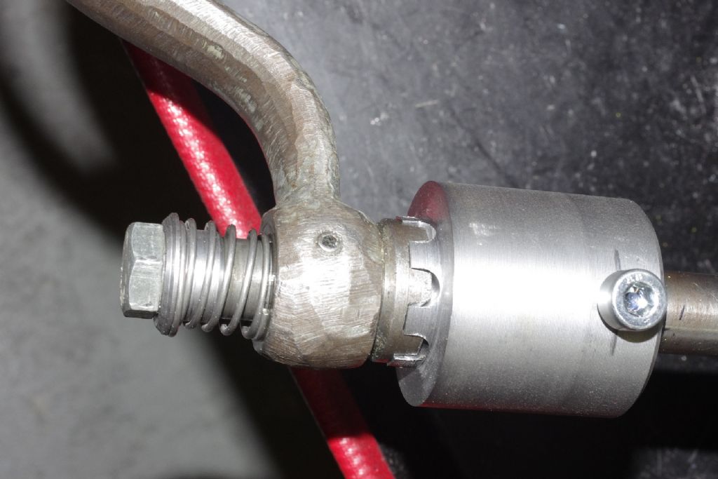

        All, my son was given an old – and very knackered – Schumacher R/C car to rebuild as an engineering project:
        He's stripped it, and we've been making various parts like turnbuckles, a layshaft, spring perches, bushes etc., and bought a few parts too:
        We are however stuck with the side plates for the ball differentials, two of which are cracked. A hardened washer fits on the non-drive side. They are apparently very rare and difficult to find in undamaged condition. They were available in aluminium as an extra cost option.
        The problem is the castellated output ends. We turned up a test piece, and transferred the tapered tooth profiles onto the plain face with paint. Then used a razor saw to make vertical cuts, followed by a wood chisel to bend and chop the segments out. The output stubs are 8mm diameter, so filing to clean up is very difficult.
        Obviously this gave an appalling result, but since it's aluminium, and the corresponding castellations on the output stubs fit (kind of), it will work. The differential halves are forced togeher with a screw and nut through the entire assembly, so the output stubs cannot fall off:
        Question, is, how can we make a better job of these castellations? I can only think to buy a thin diamond wire, place it at the bottom of the cuts, and try to saw the cut-out bits across their bases. It would be a simple milling operation if the segments weren't tapered.
        Any ideas? Thanks in advance.

              Dr_GMJN
                @dr_gmjn
                Sorry guys I didn't explain that very well.
                By tapered, I mean that the gap at the middle is smaller than the gap at the edge, ie the sides of each castellation – in plan – are radial lines from the centre:
                The gap towards the middle of the part is approx. 1.6 mm wide. So if I had a 1.6 mm milling cutter, and made a cut from one side of the part to the other (again in plan), I'd get straight sided cuts, not wedge shapes.
                I don't have a rotary table.

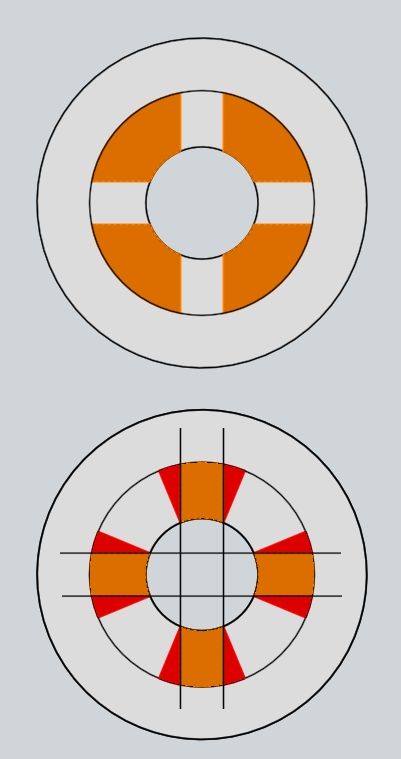

                              Do they need to be tapered. I would guess from a power transmission point of view they will be well over engineered.
                              A suggestion might be to modify the existing stub axles to simplify things.
                              Mill the existing outboard pieces as per the bottom diagram to remove the red bits. It's four straight cuts (two "vertical, two "horizontal) with a small milling cutter.
                              Then make the new components to the top design. This time only two cuts straight across. Without dimensions, I don't know what size cutters you might need, but if the gaps between the teeth in the centre are 1.6mm then a 1mm cutter will probably suffice.
                              PS thanks for the question, solving your problem has made me think again about the design of  adog clutch I have made.

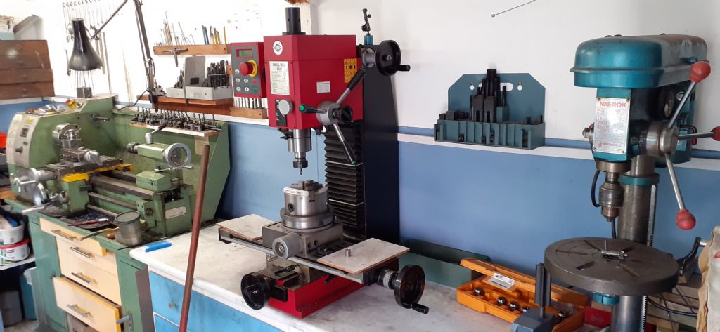

                                Can anyone recommend a rotary table then for an SX2P Mill?
                                Like I said I've not got one, but it would be a nice toy to play with and then it's a simple matter with a 1.5 mm diameter milling cutter.
                                #557903
                                Anonymous
                                  Posted by Dr_GMJN on 11/08/2021 15:06:33:
                                  Not specifically as I'm not familiar with the mill, but offer the following points for consideration:
                                  • Get a bigger rotary table than you think you need, a lot of room can be taken up with clamps
                                  • A vertical/horizontal mounting table is useful – I use vertical as much, or more, than horizontal
                                  • My rotary table has a 1" parallel hole in the centre; to my mind that's more useful than a Morse taper, as it's simple to make location spigots and fixtures
                                  To illustrate the points, here's a horizontal setup:
                                  Note the central rod; simply stock bar with a 1" spigot turned on the end. The clamps under the gear only just fit on the table. And a vertical setup:
                                  Andrew

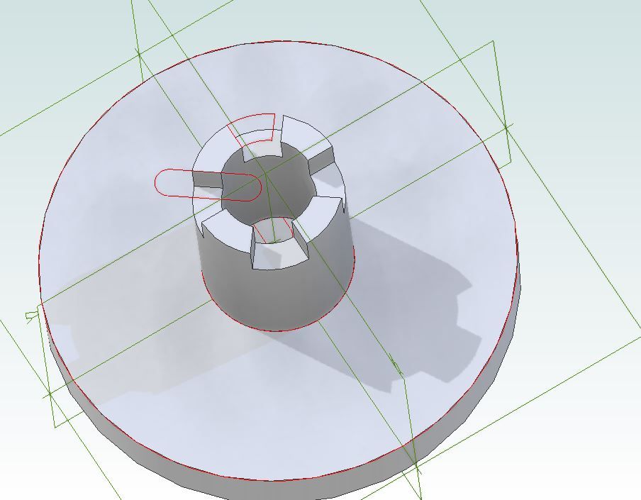

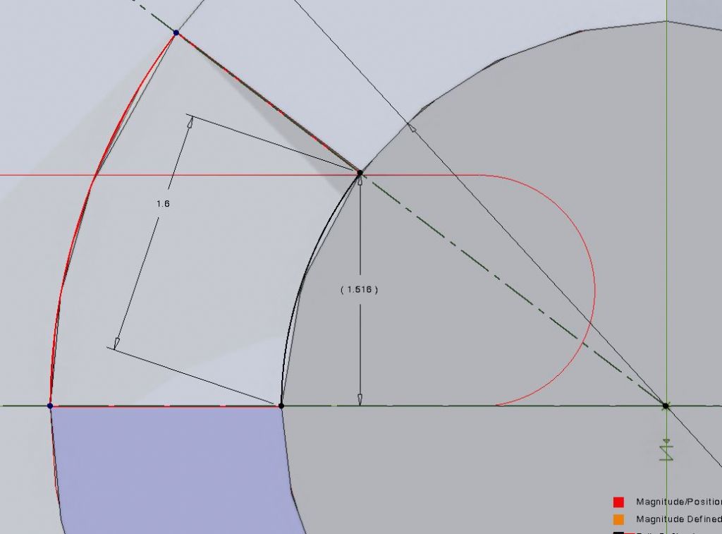

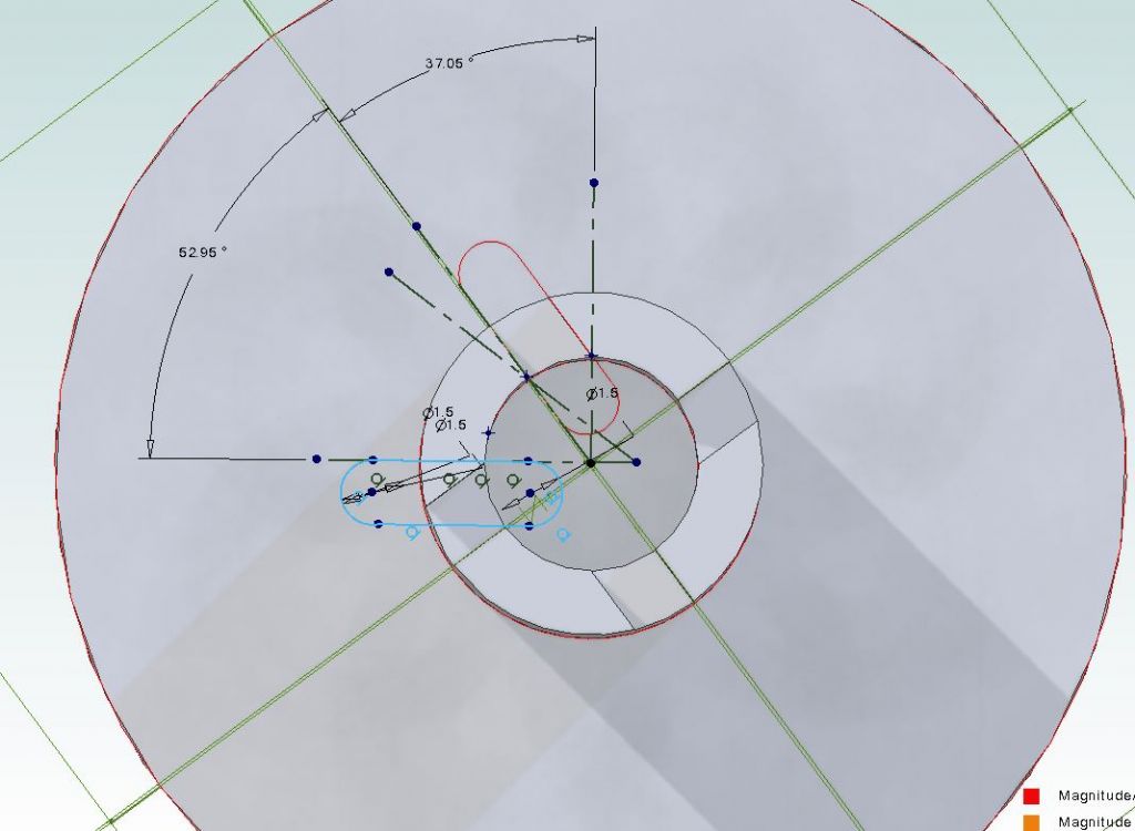

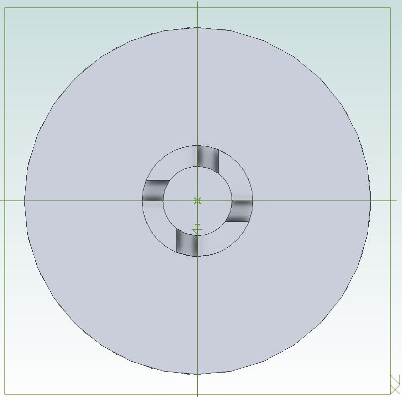

                                      #557907

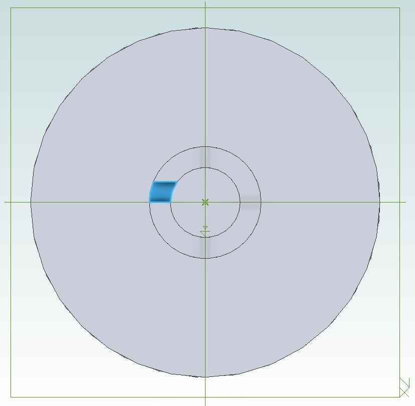

                                        You don't really need a rotary table for that, infact you could do it by just rotating the part once, either way a simple printed out paper disc and pointer would do.
                                        First thing is to look at the part and asses how it can be machined, simply by rotating slightly you will see that the radial faces can be lined up with the X and Y planes.
                                        A bit of CAD to draw out teh shape, I've assumed a 5mm hole and shown your 1.6mm gap. Which a 1.5mm dia cutter will just fit through so offset by half cutter dia and machine one face, probably go down in 0.5mm steps
                                        This will leave your part looking like this

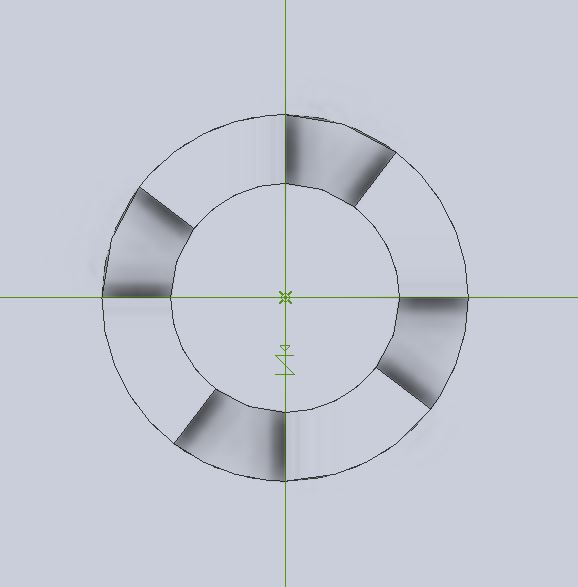

                                        You can either leave it in the same position and make another cut in X coming in from the right and offset 0.75mm below the x axis then two cuts from top and bottom either side of teh Y axis. Or if tooling permits rotate 90deg and make a cut repeat twice. You will end up with 4 slots forming 4 of teh dog faces
                                        Now rotate the work by the complimentry angle of the 37.05deg, offset below X axis and make a cut.
                                        Which and then do it three more times by rotating 90deg or cutting in teh other three axis and part will then look like this
                                        Edited By JasonB on 11/08/2021 16:18:40

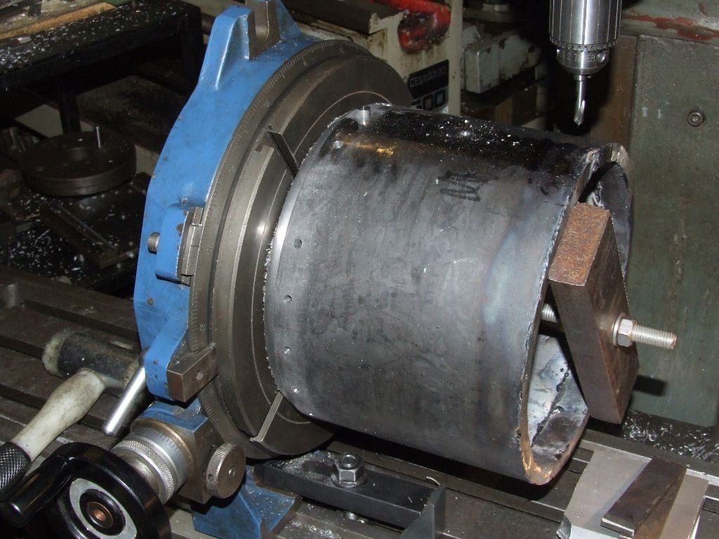

                                        #557913
                                          As a rule of thumb I would say go for a rotary table approx the siz eof the mills table front to back so maybe 5" diameter. My reason being that with limite dhead room on some of the bench mills you can soon run out of head room particularly if teh table is vertical.
                                          This is how the SX2.7 is set up at the moment from rounding a couple of rod ends. 6mm dia cutter sticking out no more than 20mm from the collet. yet there is only 1" of vertical movement left in the head as the 150mm R/T (larger than table size) and 5" chuck stack up.
                                          Also a little video of the progression of the cuts to form your dog clutch
