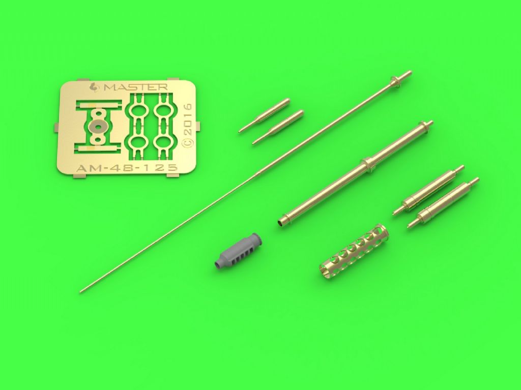

                                      Interesting links – thanks. Couldn't help but notice this in the second one-
                                      With the addition of CNC, Swiss machine tooling areas began to include turrets, gang slides, and secondary spindles, improving speed and accuracy. When parts are rotating at a speed of up to 15,000 RPM with live tooling up to 10,000 RPM and tolerances anywhere between ±0.0002” (±0.00508 mm) and ±0.0005” (±0.0127 mm), Swiss machines have the ability to support high volume requirements with just a single skilled machinist.
                                      A far cry from a Myford for sure!
                                      Ha, I'm a sucker for that aftermarket stuff Doc, especially the resin !!
                                      Master don't do the aerial as a separate item – it's in with the chain gun parts
                                      Without checking it I would say the thinner part is no more than .3mm and yes it's turned along it's full length. As you say some remarkable items at very reasonable prices considering what it would entail to do like wise even if able to!
                                      Edited By Ramon Wilson on 26/01/2022 21:55:14

                                        That aerial is just insane if it’s turned. Some of their 1:72 machine gun cooling jackets are unbelievable too.
