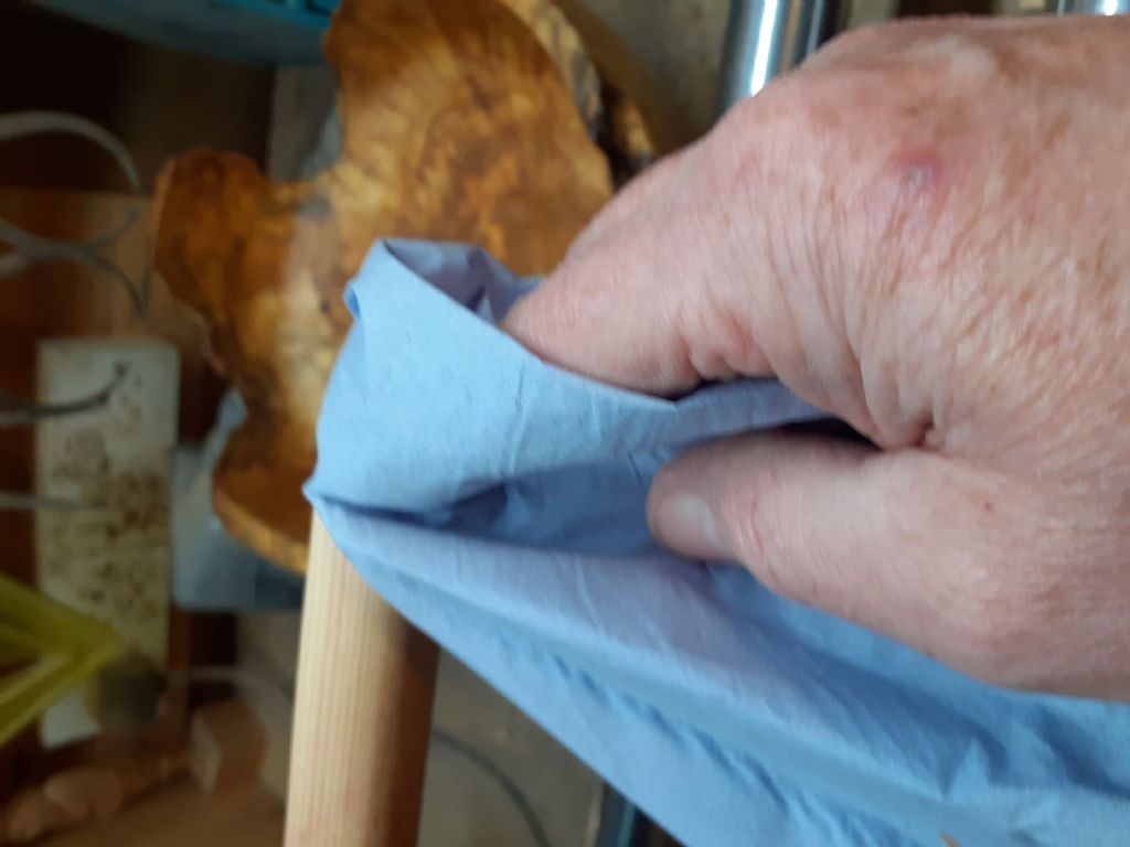

                          Posted by ChrisB on 09/05/2021 13:28:39:
                          Nice work Stevie, not necessarily the way I'd go round it but still good job. As for the above comments regarding the polishing cloth, I would do the same as you did, but with a paper towel.
                          Paper towels may rip easy but you also will be surprised how strong they can become when bunched up or even wrapped around something. It does not take much for the finger to be pulled into the works before the paper can give out so please do not do it.
                          I would hate to see someone injured

                              Posted by Steviegtr on 09/05/2021 22:44:45:
                              Posted by Derek Lane on 09/05/2021 19:54:46:
                              Yes i see what you mean. So what would be the best way to polish the bar end.
                              Steve.

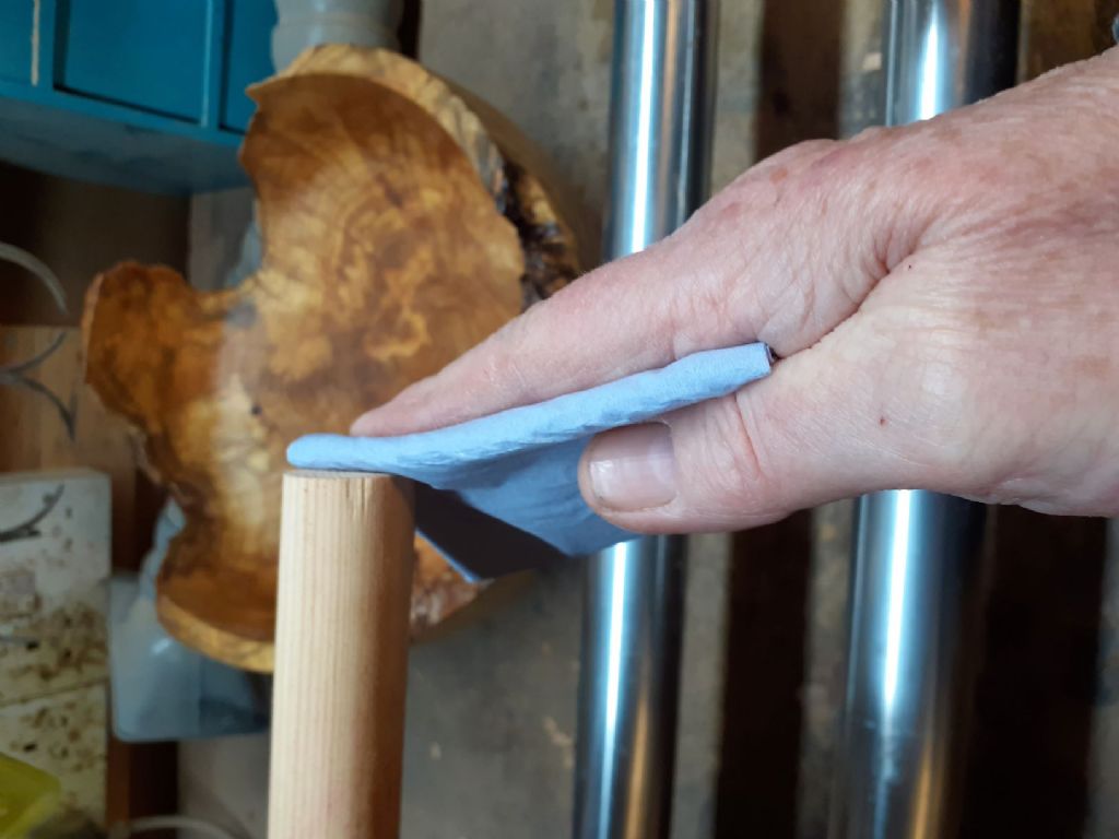

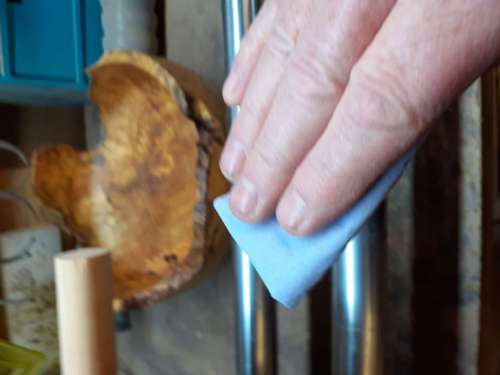

                              With all sharp edges removed from the part hold the cloth or paper on the flat of the fingers using your thumb like a small clamp if the cloth or paper catches it will just pull out of you hand and not pull your hand in. With woodturning we hold the cloth at the7 o,clock so that it is pulled away if held on top everything is being pushed towards you hand.
                              Easier to show than explain will try to take a photo tomorrow sometime

                                                      Steve as promised I had to use the wood lathe to show what I meant.
                                                      The first picture is how you held your cloth the second and third is how I hold it with the pad of either paper or cloth as you can see nothing wrapped around my fingers if it does catch it is pulled out of my hand and not pull my hand in with it. This can also be used with abrasive papers.
                                                      I hope this makes my explanation a little clearer Sorry about picture quality as well as being sideways
