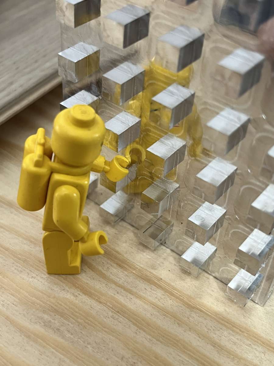

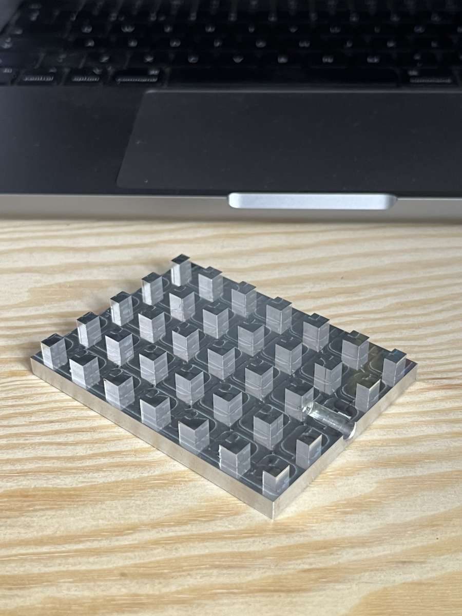

      Managed to run a little job on my CNC today. Very happy with the surface finish:
      IMG_7955
      Couple of short videos of the machining and the optical illusion here:
      https://youtube.com/shorts/K1NHng7rXFQ?feature=share
      https://youtube.com/shorts/aL5zWVPkLDQ?feature=share
      Next comes the inspection for goodness.
      Fingers crossed, although if its not right I cold use it to make waffles I suppose 🙂

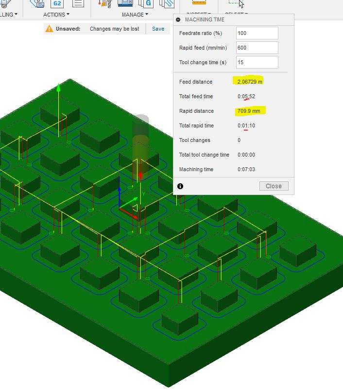

          I didn’t understand the logic of the cutting paths.  Why didn’t the path go straight down the x planes and then across all the y planes. Wouldn’t that have been quicker ?

            I did notice a similar situation on the Warco stand at the show, it seemed totally illogical to me.
            #820952

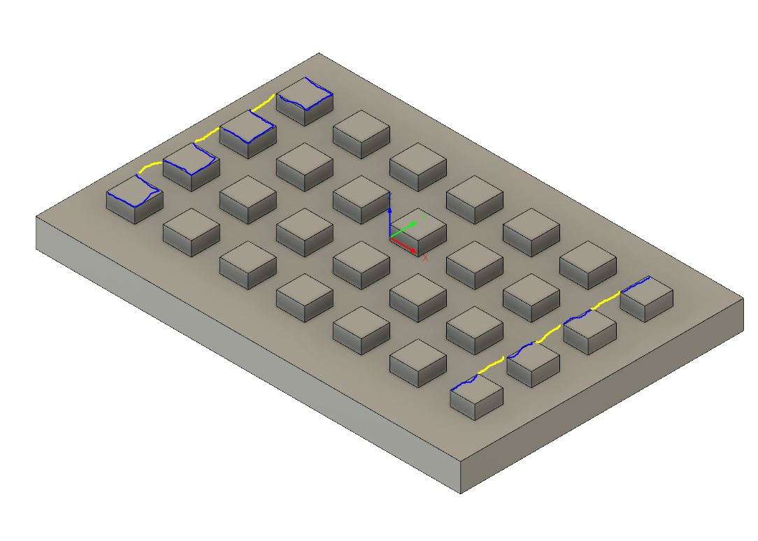

              CAM works out the quickest option which sometimes can result in what seem like unusual moves.
              Looking at the video it seems to be finishing 3 sides of each upstand them moving (at rapid rate) to the next so 3 sides cut and then one non cutting move. So approx 75% cutting and 25% non cutting.
              If it were to straight line the cuts, then it would be one cut one rapid, one cut one rapid so approx 50% cut and 50% non cutting.
              So fairly easy to see the CAM picked the shorter option.
              Blue is cutting, yellow non cutting you can see the far end does mor ecutting to noncutting which is what the video has it doing
              paths
              Tried it myself using contour an that actually does 4 sides at a time, lots of blue cutting and not much yellow non cutting. If you look at the cutting time box the proportion of cut to non cut is 3:1 but as rapids move that distance faster than the cutting speed the ratio is actually 6:1 as far as time goes.
              paths 3

                  Well Im glad Jason can explain it. I was going to say ‘Thats what the program decided, I assume its doing the correct thing…’ The roughing path was also a bit unusual, but then when I 3d print stuff it also goes around the plate in an order I wouldn’t have usually used.
                  The thingy is supposed to allow me to quantify the errors in my machine. So lots of posts that I can mic between which should be certain distances. Only of course I made the distance between posts just to small to get the mic into, so Ill have to measure it using the surface plate, a height gage and som jo blocks… <sigh>
                  I think my mill is very repeatable, but not actually as accurate as I want. I suspect much more expensive leadscrews might be in my future 🙁

                      Can you measure it with a vernier caliper, or its digital equivalent, able to reach into the channels?
                      If you have, or make, a suitable plug-gauge, although it won’t give absolute readings, it would be a rapid way to test for repeatability along the length and width.
                      I know CNC machines are made to very high accuracies and a CAD/CAM file is even more spot-on, but how does the process eliminate backlash on all this to-ing and fro-ing?
                      The heading photograph shows a wonderful optical illusion. I assume it is actually like Jason’s rendered image of it, but how does that curious refelction effect arise? It looks as if covered with a sheet of glass, or submerged in still water.

                            Very-near calibers are not accurate enough to really tell me the answer.
                            setting up on the surface plate is more faff, but will be able to give me repeatable measurements to 0.0001″ with care. Gage R&R studies for this part are not in scope (yet) tho.
                            My machine has approx 2.5 microns (0.0001″) of backlash. I say approx because it’s very hard to measure that small.  if it needed it the controller has programmable backlash compensation built in, a bit like a manual machine turning the handle past and approaching from the same direction.
                            It is like Jasons model – the optical illusion arrises because the surface finish is stunning.
                            IMG_7957
                            Im very happy with that, less so that the beautiful surfaces are where they are supposed to be in space…

                              One reason for going round the posts rather than just up/down and across is that it avoids the need to deburr the pillars after CNC machining.
                              Julie

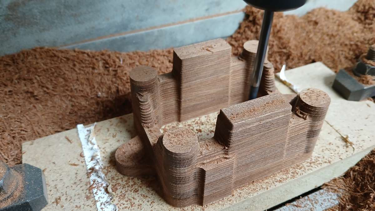

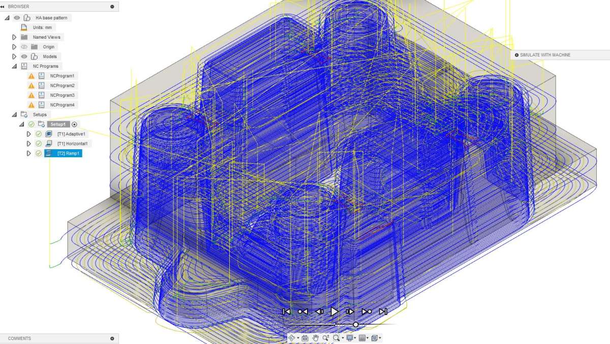

                                It can be quite interesting to follow the toolpaths that are generated and then start to tweak them which I tend to do to get the run time down. Often it is a toss up between taking bigger cuts & risking leaving steps on the surface against smaller cuts (stepovers) that will give a smoother surface but take longer.
                                No shiny stuff for me this morning, I went for dusty and matt. It is the pattern for an engine sole plate approx 135 x 77x 48. A quick look at the paths shows that the adaptive was 40m long cut at 650mm/min and the ramp finishing cut 60m long and cut at 750mm/min. With that amount of cuts the tool paths all become a bit of a blur but it is possible to follow each one in real time or even slower. The wide spaced ones in layers are the adaptive and the very closely spaced the finish ramp.
                                path4
                                Top leveled and ready to start the adaptive with a long reach cutter
                                20251021_090628
                                Adaptive complete and just starting the ramp. You can see the 1.5mm steps left by the adaptive

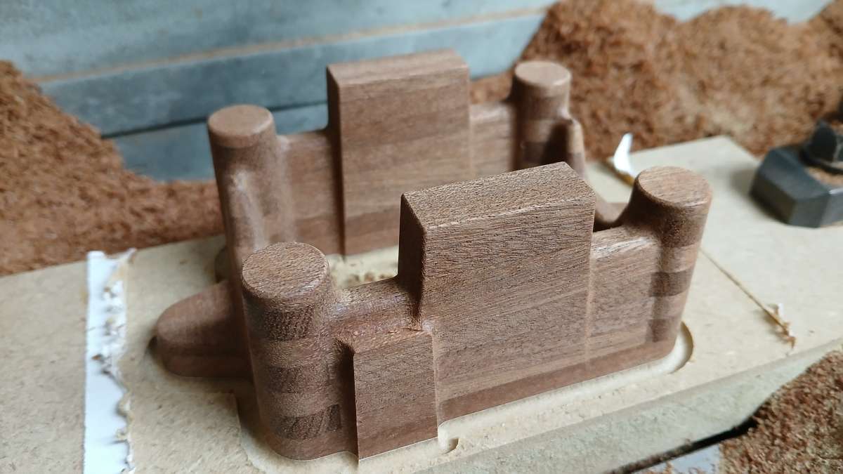

                                Job done, hardly needs sanding
                                20251021_120819

                                  I go for Julie’s reason as in Jason’s argument, the cutter has to cut the length of the side of the square plus 1*diameter of cutter for each face 28 times.  But I am sure I must be wrong.  Ask a postman how he would deliver letters if each square were a block of 4 houses! (perhaps not)

                                    Yes “cutting length” is measured to the ctr of the tool so things will be different than my basic example. Many factors to consider such as block size, width of gaps, cutter diameter, cutting feed rate, rapid feed rate, feedin/out, etc.
