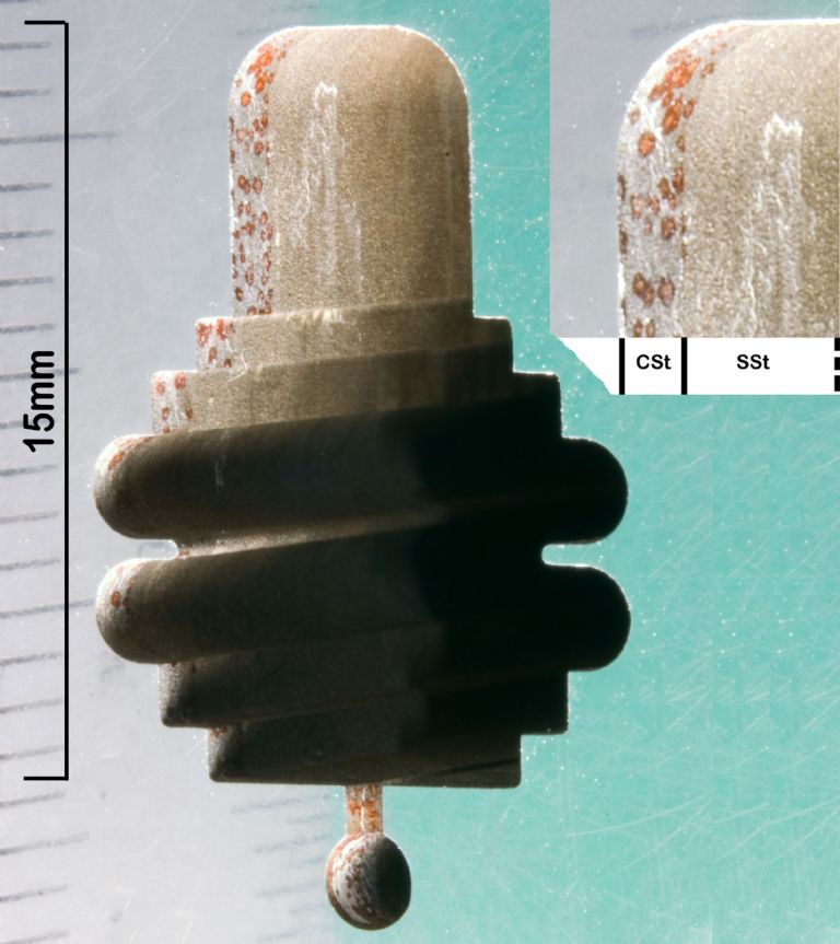

      I have wondered about this pattern of rust spots. They are on the inside edge of the 1.5mm gauge plate marked CSt, see inset.
      Gauge plate has a probable carbon content of around 1.3-1.5%.
      The rest of the block is made up of several hundred stainless steel 'shims', marked SSt in the inset.
      The surface is rough, a result of the EDM wire cutting erosion.
      What puzzles me is why are the rust spots that shape, variegated in colour, and loosely distributed the way they are?
      Shouldn’t the rust appear uniform?
      By the way, the hole (2mm dia) at the bottom of the image was were they initially threaded the EDM wire.

          I have seen patterns like that before.
          First thing it reminded me of is how rust forms under paint. Where a small hole in the paint lets water and oxygen in and allows the rust to start. I then understand that the difference in oxygen levels between the hole and edge of the rust spot causes a small electric potential. The potential then promotes rusting.
          The other is rust spots on the stainless kitchen sink. This was caused by very small iron filings, from a angle grinder. They stuck to the sink surface then over night rusted and caused blob stains like above. This is rusting is promoted by galvanic action due to the dissimilar metals.
          So my guesses are either there is a coating on it that is imperfect and electrolytic rusting is happening. Or the surface is contaminated by very small metallic particles which are causing galvanic rusting. You say it was cut using EDM, well that creates a lot of very small metallic particles. Both the metal being cut and from the copper electrode.

            I also had a similar pattern on a stainless sink that I flushed some tiny Potassium Permanganate crystals down. I assume it acted like a strong oxidiser with the pattern where the tiny crystals had lingered. EDM I assume will have similar electron movements very dependant on steel composition and spark pattern??

                I understand that rust will appear on the surface of stainless steel if the surface oxide coat, which prevents chemical reaction taking place with the underlying stainless alloy taking place, is breached chemically. A good example of this is where stainless cooks knives put into a dishwasher will sometimes be left with rust spots in random places, this doesn’t happen every time they are washed but only when something chemically breaches the stainless protective oxide layer. Metallurgists will be able to explain much better than I can.

                      The wire cut EDM process is done with water. Either power flushed or submerged. If the distillation of the water is slightly out or the part left a while after cutting you get the results shown. As far as I am aware only the very early Japanese "Sodik" brand machines used a paraffin type dielectric like a normal solid sink EDM (spark erosion) machine At the end of the day it is down to slight impurities.

                        I am a biologist rather than a chemist but I have always understood that "stainless steel" is resistant to corrosion because a very thin layer of chromium oxide forms "instantly" on the surface of an object – when in the presence of oxygen. This layer is impervious to water and it prevents any water around the object contacting the iron in the steel, so no corrosion can occur.
                        This layer is normally self-repairing if the object is rubbed, but the repair process requires oxygen, so without oxygen it stops, and corrosion starts if there is water around. In the sea and sometimes in fresh water or underground there is normally at least some dissolved oxygen but this can get used up by, for example, plankton or bacteria – so, no oxygen, but some water = corrosion.
                        So stainless steel is not at all reliable in marine environments, and can prove unreliable in some other places , including the bottom of chemists' sinks!

                          No iron? If so it's not steel. 304 (austenitic) is otherwise known as 18/8, meaning 18% chromium, 8% nickel. The rest (apart from a trace of carbon) is iron. The clue is in the name, if it didn't contain iron it wouldn't be steel.
                          All sorts of things can make stainless rust, amongst these are cold working (bending or drawing), welding, getting contaminated with non stainless (from grinding in the vicinity)

                                Stainless steel requires passivation with acid to dissolve the ferrous particles from the surface. Pickling in citric acid will work well and is more environmentally friendly than some of the other methods. Passivation is particularly important when the SS is in a salt water setting, and the chemicals in an EDM would not be much nicer.

                                  In my example about the rust spots in the sink, I actually used acid to remove the iron. Incidentally I also got caught out by scrubbing the toilet bowl u bend with a brillo pad. It left a grey patch, which I removed with citric acid toilet cleaner. Thankfully before my wife saw it.
