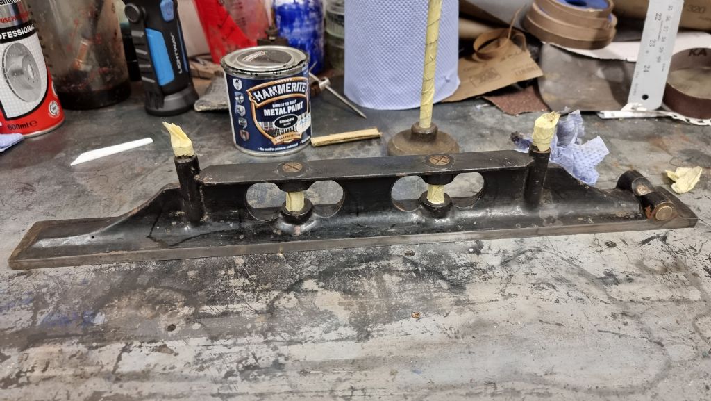

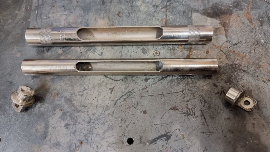

                              Possibly, having installed the vial, while the plaster of paris is still moist, to rotate the vial until the bubble moves as close as possible to the centre (highest position. )
                              Once the plaster has set, the end to end location can be adjusted by rotating the level by 180 degrees and adjusting until it gives the same reading which ever direction it is facing.
                              As long as it shows the same "out of level" in both directions, it will not matter too much if the "datum" surface is not absolutely level.

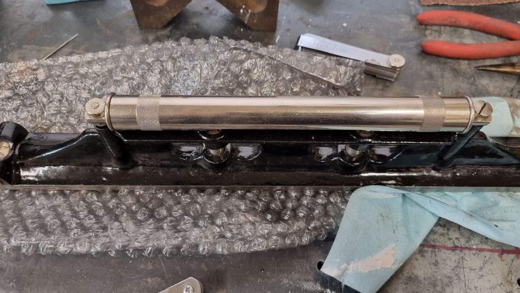

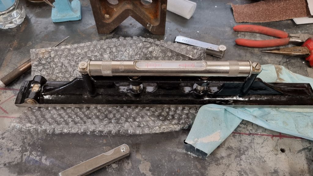

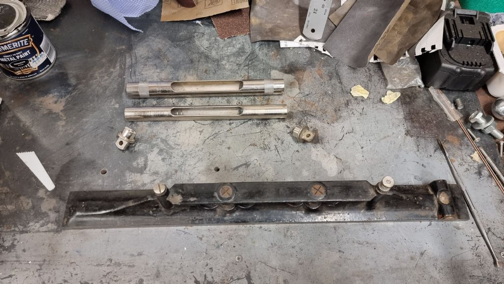

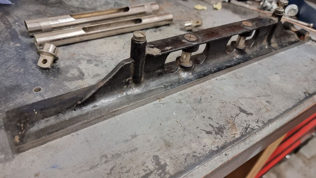

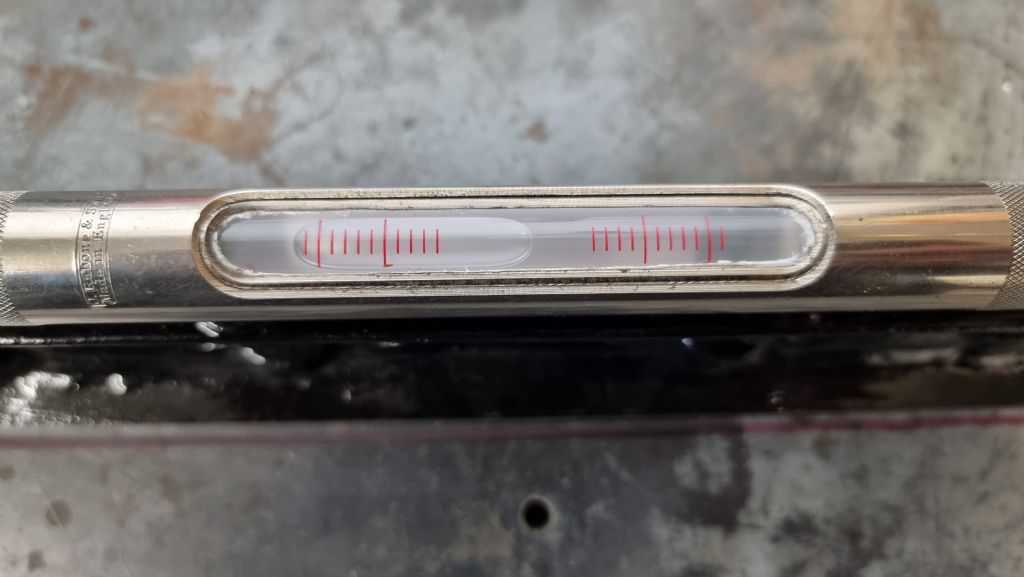

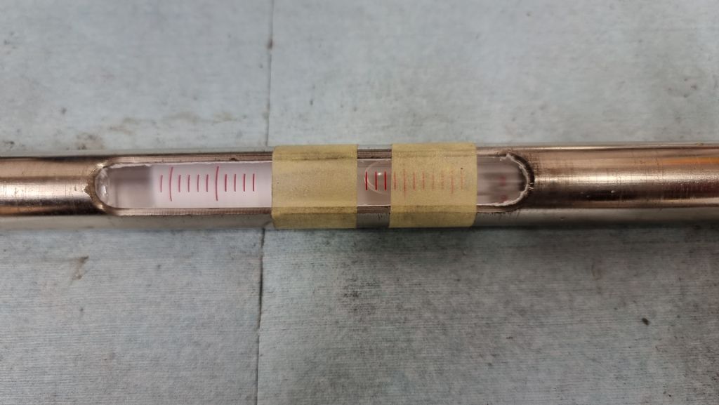

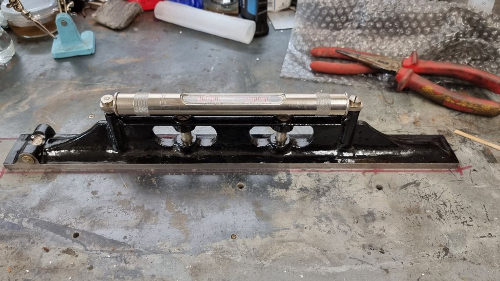

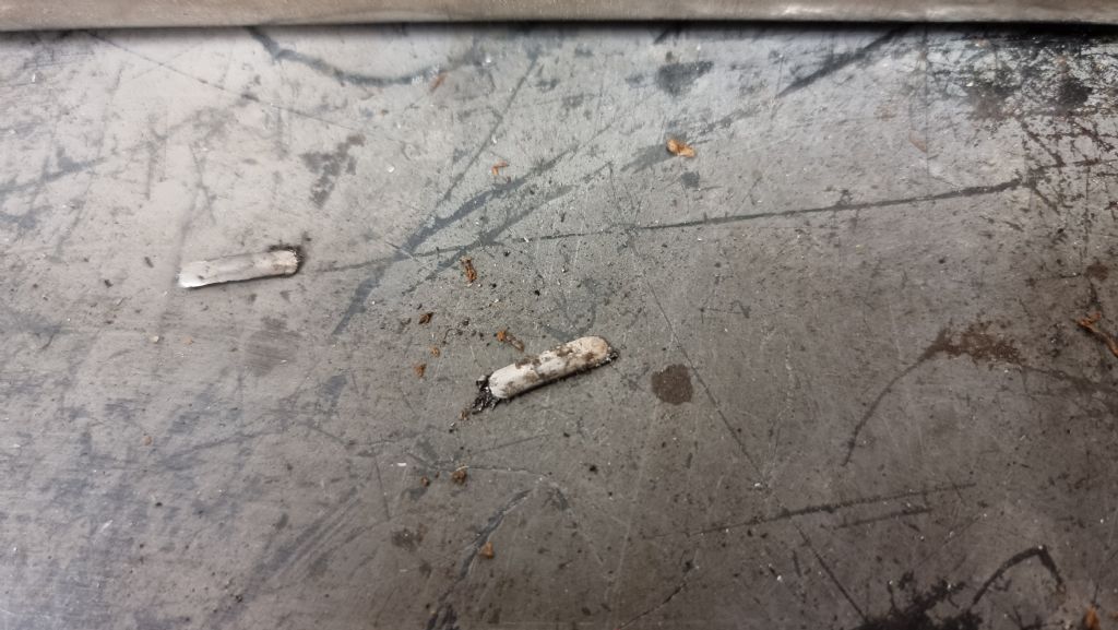

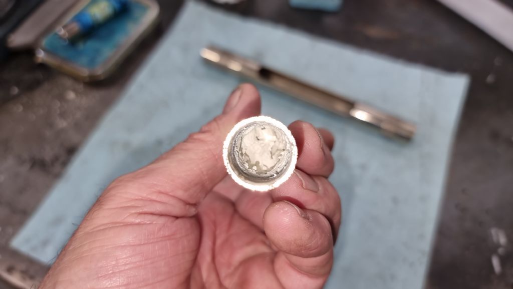

                                      Well guys. I have managed to repair the Level. I will attach pictures below. As SOD or someone said, not everyone wants to watch Youtube video's. So the photo's will at least show the thing being repaired. But honestly. We say a picture paints a 1000 words. But how many words does a video paint. Just saying.. I recorded over 6 hours of footage. Spent much of today editing down to 25 mins. Regards all. Yes they are very difficult to set up. I ended up on the mill bed. I have no Granite block or anything like that. The rotating & adjusting took around 1 1/2 hrs. Will put a link to the video, once it is up & running.
                                      Steve.

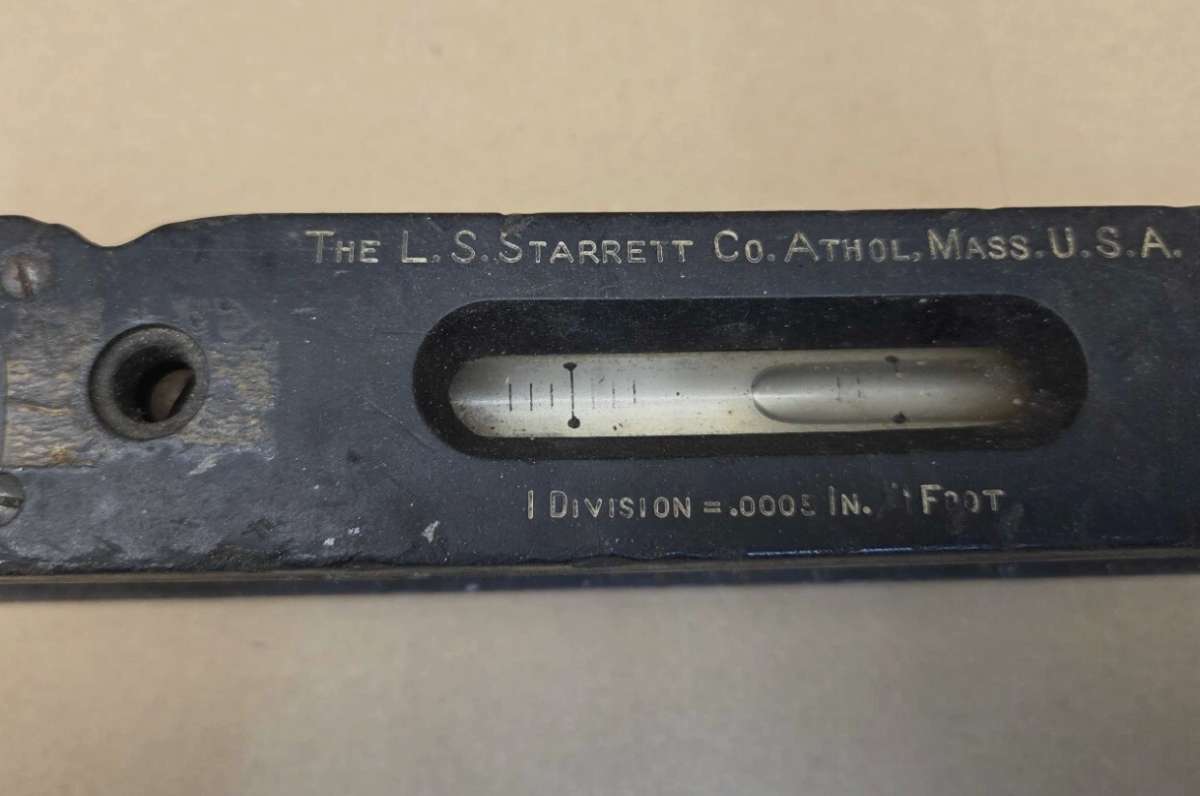

                                          Trying to avoid starting a new thread – does anybody know if a level vial usually has the graduations ground onto the glass, which is then filled with some sort of colour, or if the markings are ‘printed’ onto the vial and once they’re worn off, they’re worn off?
                                          I have a Starrett 199 and am interested in another that is in need of some repair to the markings, but honestly by feel I can’t tell if the ticks are ground in or not!
                                          Cheers
                                          #820891
                                          ryan.carter848
                                            @ryan-carter848

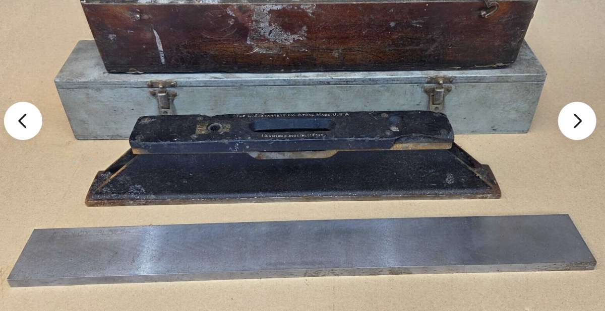

                                            I just purchased it on ebay so can be less ambiguous 😀
                                            £30 quid for an 18 inch straight edge, and a 199 in the worst condition I’ve ever seen. Worth a punt I thought anyway.
                                            Worst comes to worst, I’ll get a level developments vial and treat the Starrett as a casting.

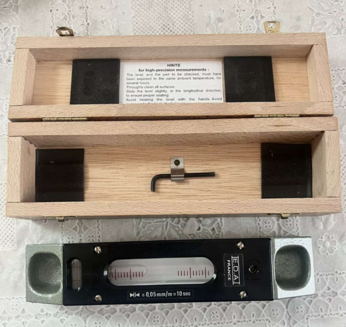

                                                  Cheers Andrew, on their website I can see them on a web store at least, so maybe if I go that route it could be an option.
                                                  Another thing I notice about Level Developments is how closely they resemble levels made by E.D.A in France.
                                                  I actually own a Level Developments 10 sec level (off eBay) and everything is identical to the E.D.A ones down to the box, allen key in the box and even a sticker on the bottom saying that it’s hardened… in French!
                                                  Goes against the LD claim of being made in England, but perhaps the bases are shared amongst various companies and they only make the vial… who knows.
                                                  I’ve tried googling / asking the robots but nothing I can find shows any affiliation between the two.
