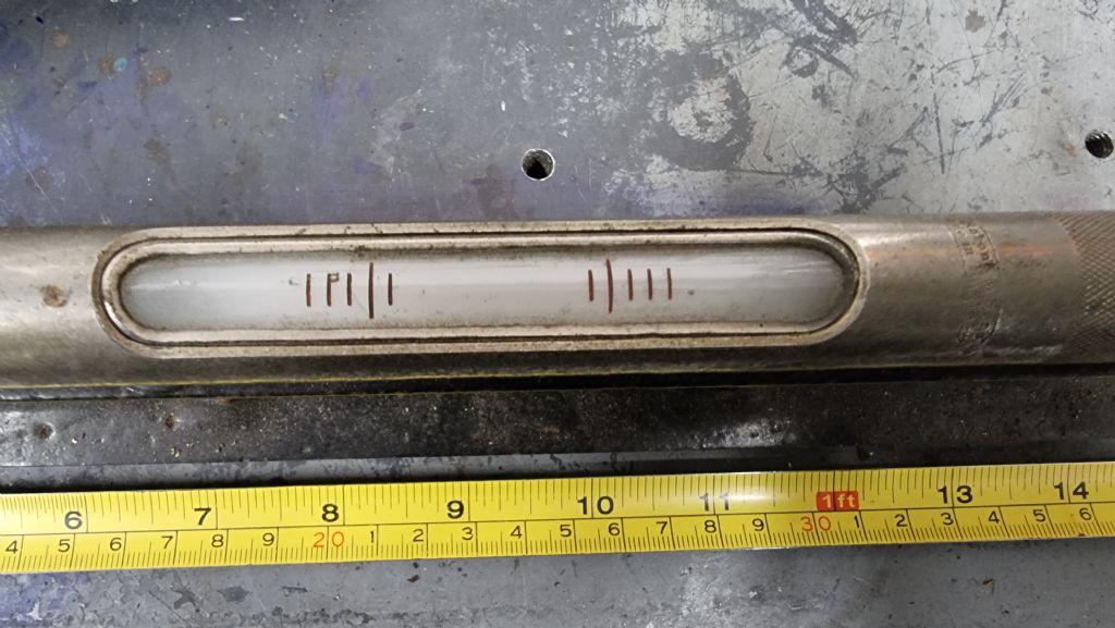

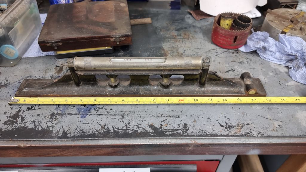

      I have been given a machinists level. It is Rabone. Can the level bubble/ buble be still purchased. I did a quick search , but found nothing. Any help appreciated.
      Pictures.
      Steve.

          have a look for level vials, you need quite a slow bubble to get the sensitivity not a faster one that you may find on say a builders level. try here

                Yes it does come apart, ends unscrew, vial is usually held in with plaster of paris.

                      You will probably have to break the old vial to get it out.
                      This will show you how they come to bits.

                            Hello again . I have taken it apart. The ends do indeed come off. They were a very tight press fit. The Glass vial is 100mm long & the dia of the case is 16mm. So the search begins. It was full of plaster holding the glass in place. Now all cleaned out . Many thanks for all the help guys, as usual. I will post a pic once it's all cleaned up & back together.
                            Steve.

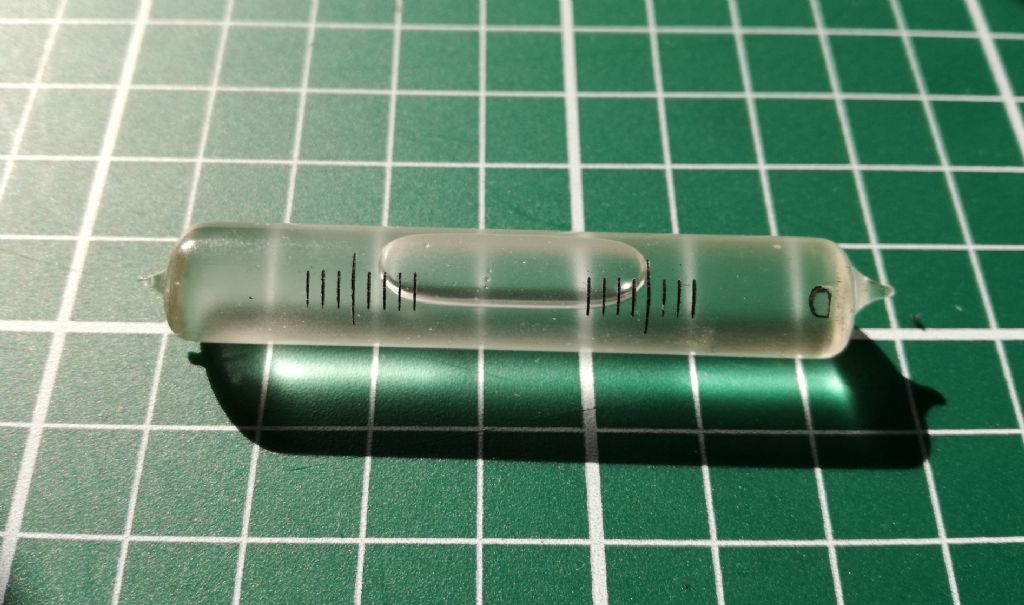

                                          Hi I still have a few of these vials which I bought several years ago, but they are only 60mm long plus the pips. Each mark represents 0.2mm per 1M apparently and when I took this photo the bubble had moved to the right from the middle, due to me leaning very slightly to get it into view, but I was not touching the table it was on.
                                          Regards Nick.
