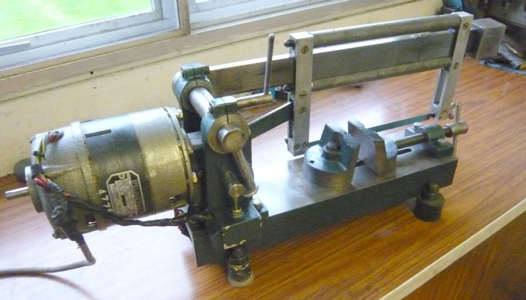

      I have just given my old machine saw a well deserved clean up. I made it years ago and it has done great service. I use a worm driven Parvalux motor fitted between the pivot supports. The tapered jaws on the vice firmly hold down the cut material. It can clamp smaller sections by introducing a large diameter in the jaws so that the jaws can clamp. I have added some more pics in my album.

        Small home made machine saw

          That's a nice job Alan, I especially like the inclined jaws, was the idea yours or imported?

            Hi Brian,
            Thank you for your kind comments. Yes the inclined vice jaws was my own idea and it has worked out well.

              That's very neat, Alan … I like the mechanically tidy installation of the worm-geared motor.
              40 years on; I doubt if you would want to write it up, but a 'photo essay' with a few detail shots would be nice to see in MEW.

                Great job of the power hacksaw for a home shop this is the probably best example of of a sturdy and well thought out machines I have seen for its rugged.simplicity
                Having a fascination for power hacksaw from seeing one in operation as a kid in the dark ages. and seen many variations.
                A couple of questions out of curiosity looking at the photo does the crank turn clockwise or anti clockwise.
                Does it cut with teeth toward or away from the motor.
                Eric
                #210015
                Alan Jackson
                  @alanjackson47790
                  Hi Eric,
                  Thank you for your generous comments. The motor can be run in either direction and the blade can be mounted either way round but I have found that it seems to work best with the crank rotating anti-clockwise with the blade cutting on the return stroke. This keeps the blade in tension and the crank seems to pull the blade into contact with the cut metal. This was not my first attempt at making this saw. At first I tried to make a geared down rotary blade cut off saw. It sort of worked but was just not rigid enough and chattered terribly. You maybe able to see some circular cut grooves in the base channel. So I accepted defeat and rebuilt it as you see it now.
