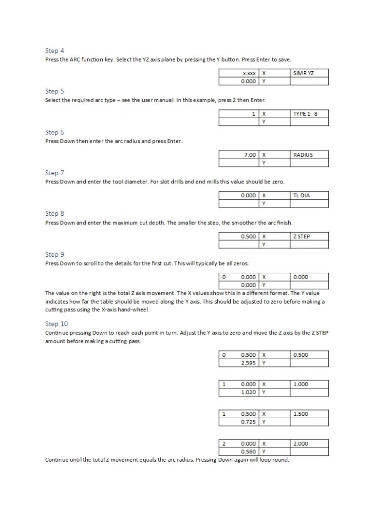

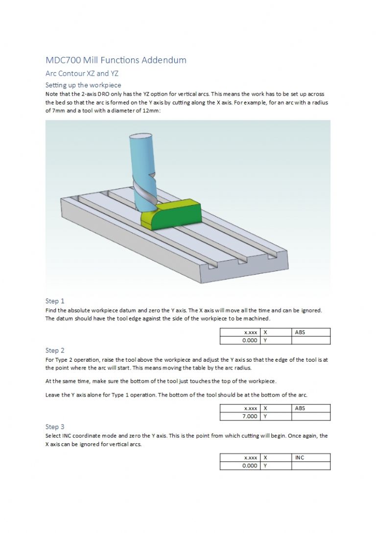

        Hi all
        I installed a 2-axis MDRO unit on my mill recently and it made a big difference to my work. Unfortunately, I found that the user manual is incomplete when it comes to machining an arc in the vertical plane.
        After a lot of messing around I figured out how to do it. I also discovered that the default Y-axis direction means things don't work as per the book so I changed it to 1. I also found that the XZ options isn't available on this model of DRO.
        If anyone is using this DRO and wants to machine vertical arcs I've created a 2-page addendum that might help. However, as I can't upload DOCX or even PDF, I've converted it into two JPG files below.
        Let me know if there are any cases of muddled fingers (or if I've completely lost the plot)
        Chris
        mdc700 mill functions addendum - p1.jpgmdc700 mill functions addendum - p2.jpg

                    JasonB: I just downloaded the Sino manual and the parameters are:
                    1. Processing plane (XY, XZ or YZ)
                    2. Centre coordinates
                    3. Radius
                    4. Tool diameter
                    5. Maximum cut
                    6. Start angle
                    7. End angle
                    8. Tool diameter modification (inside/outside arc)
                    This makes far more sense to me than my Easson, which substitutes the Start and End Angle parameters (6 and 7 above) for the Start and End Coordinates. This makes it difficult if not impossible to program an arc of something other than 90deg. Also, it seems to get confused when I try to program a 180deg arc in the XZ or YZ planes, though of course this can be done in two steps with opposing 90deg arcs.
