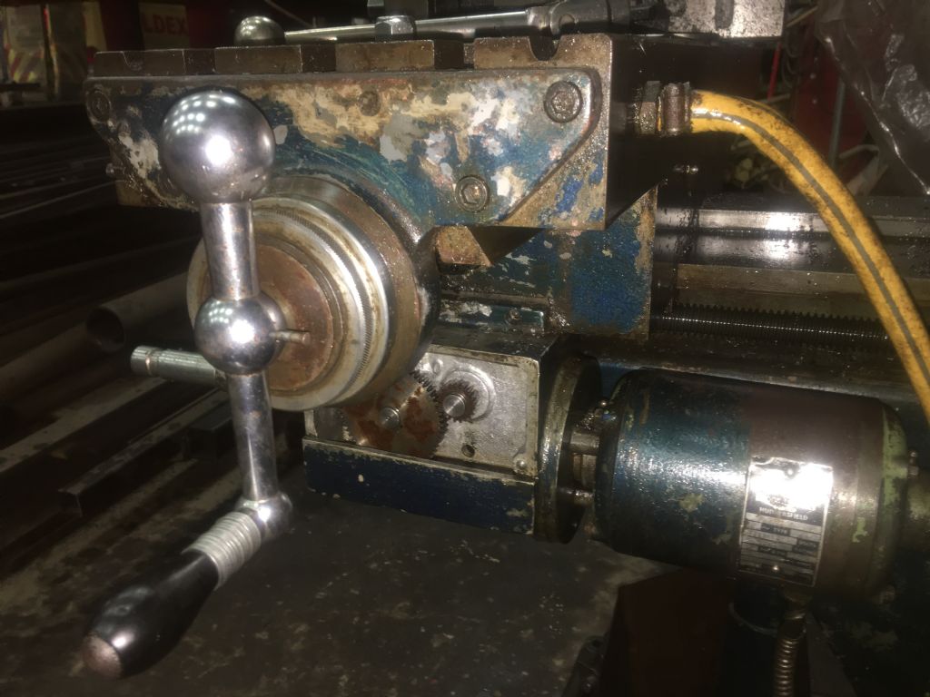

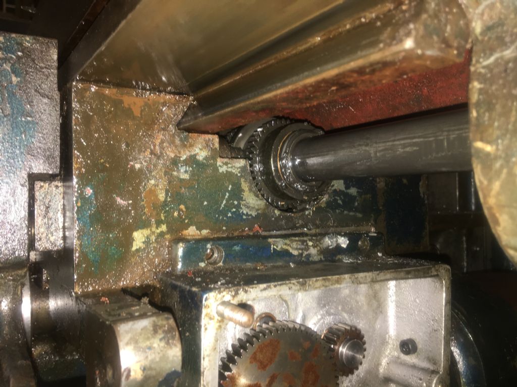

      Hi All.
      Ive had collision with the stop on the power feed and lost drive and was wondering if there was shear pin I've missed.
      The motor and the change gears drive fine but there is no drive to the leads screw. I did have a quick look last night but was unable to get the drive box off so i removed the handle and the end cap casting on the right side of the bed but was unable to remove the collar or incremental dial( i thought it may be on a keyway). I didn't want to force it as i can till use the mill at the minute without power feed. Any advise or pictures of the parts brake down would be much appriciated.
      Regards
      Scud

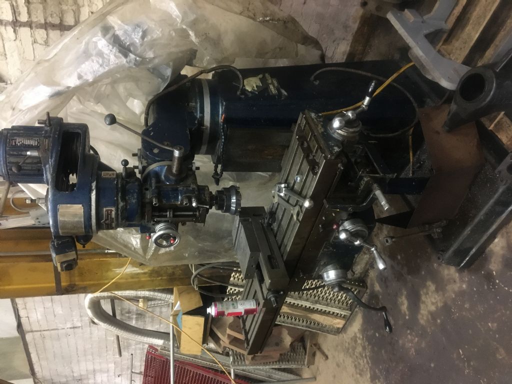

      Mark Guy
        @markguy26995
        Beaver mk1 VRBP milling machine

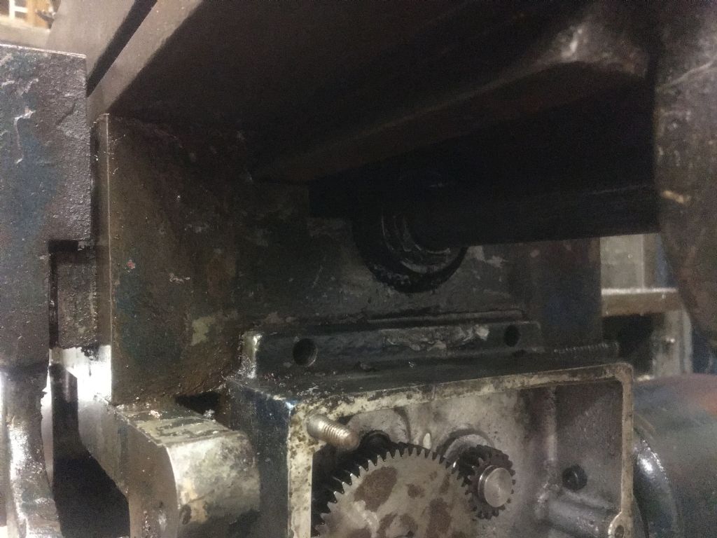

              #513068
              Mark Guy
                @markguy26995
                can't feel any knotchyness but when I've removed the change gear cover all is turning fine in there but when i look up in the bottom of the bed the gear that drives the lead screw is not turning but the shuttle lever works ok for left to right and from what i can see appears to shuttle ok. It does look like the drive gear may have dropped?? but not sure if that is just the top of an intermediate gear and should be clear of the lead screw

                  The motor runs fine so do the change gears but i have no drive between the drive gearbox and the leadscrew on the bed

                      Quick and dirty test is to try and back drive the leadscrew. Best if there is a nut on the end but if not suitable soft packing and parallel grip pliers or similar to get a hold on it should suffice.
                      If the screw turns relatively freely it will, in conjunction with similar observations of the gear train, help you narrow down where the drive has been lost.
                      Shear pins or similar weak links like Myfords Tufnol gears are normal in feed drive trains.
                      Sometimes designers get too clever by half.
                      Most annoying one I ever saw was a shallow plastic key between gear and shaft instead of aproper metal one. Pretty much unfindable wiithout the book or a full strip.
                      Clive

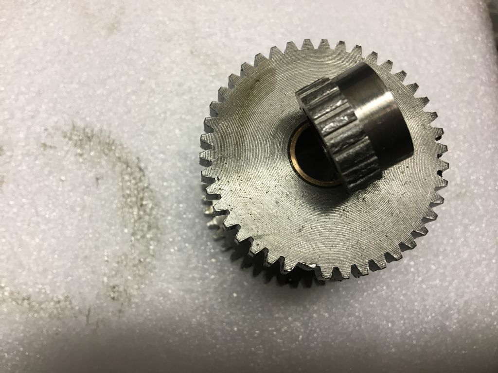

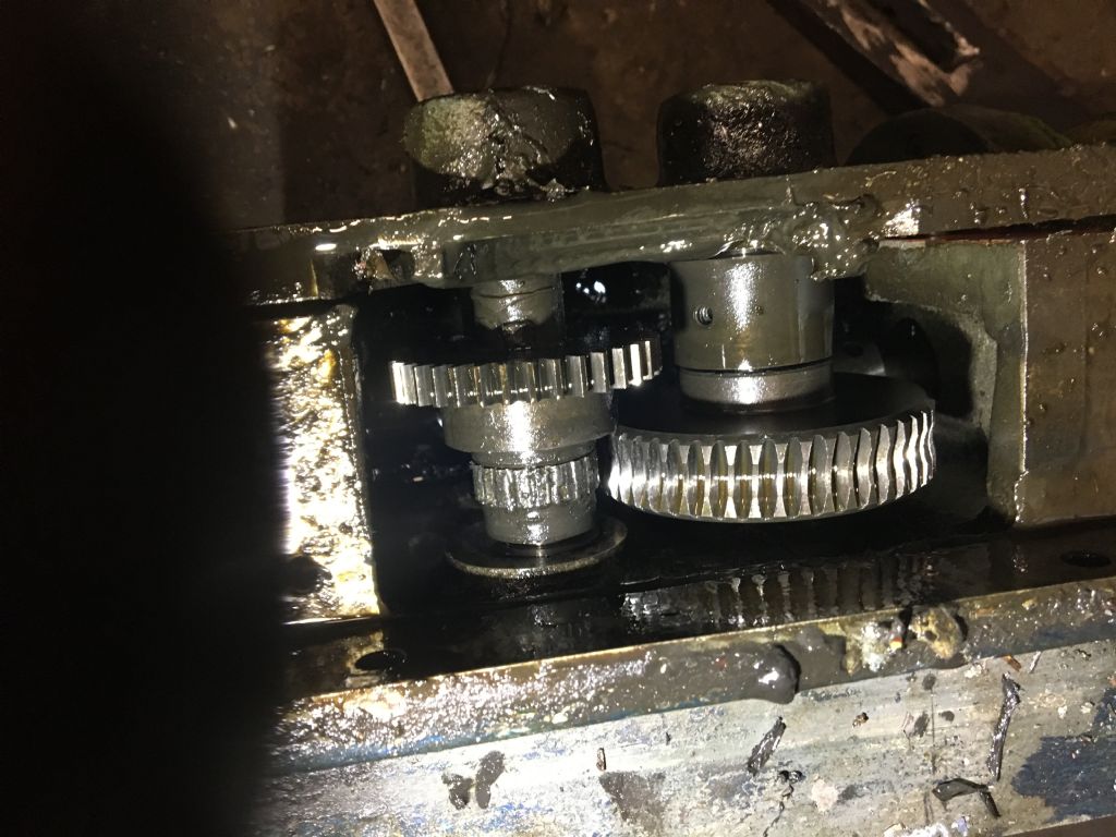

                                        #514551
                                        Mark Guy
                                          @markguy26995
                                          346f4a14-4c5a-414e-b329-516c1e781993.jpegHi all well after a good few hours stripping the mill gear box assy down, I’ve found the problem and it’s not good see photos. My next question is where may I locate these 2 stripped gears.
                                          #514553
                                          Mark Guy
                                            @markguy26995
                                            #514560
                                            Mark Guy
                                              @markguy26995
                                              These are the 2 gears required now removed from the boxe0172d94-9d13-42e7-bb11-1a4843100b94.jpeg
                                              #514567
                                              DC31k
                                                @dc31k
                                                You need to tell us the outside diameter and number of teeth on each gear.
                                                Do the two gears only ever mesh with each other?
                                                The centre distance between their two shafts would also help.
                                                The bigger one looks like it is integral with another one. What diameter is the plain bit between the two?
                                                Have a look at how the worm gear on the drive motor is attached to its spindle. This is supposed to be the weak point such that it slips if there is a bind up.

                                                  #514592
                                                  Mark Guy
                                                    @markguy26995
                                                    The larger gear is 2.164 with 42teeth and the smaller would have been had it had teeth 1.055 with 21teeth. yes the 2 sheared gears only mesh with each other. The shaft centers would be difficult to measure as the are on different housings. But a I’ve calculated they would 1.500.
                                                    #514593

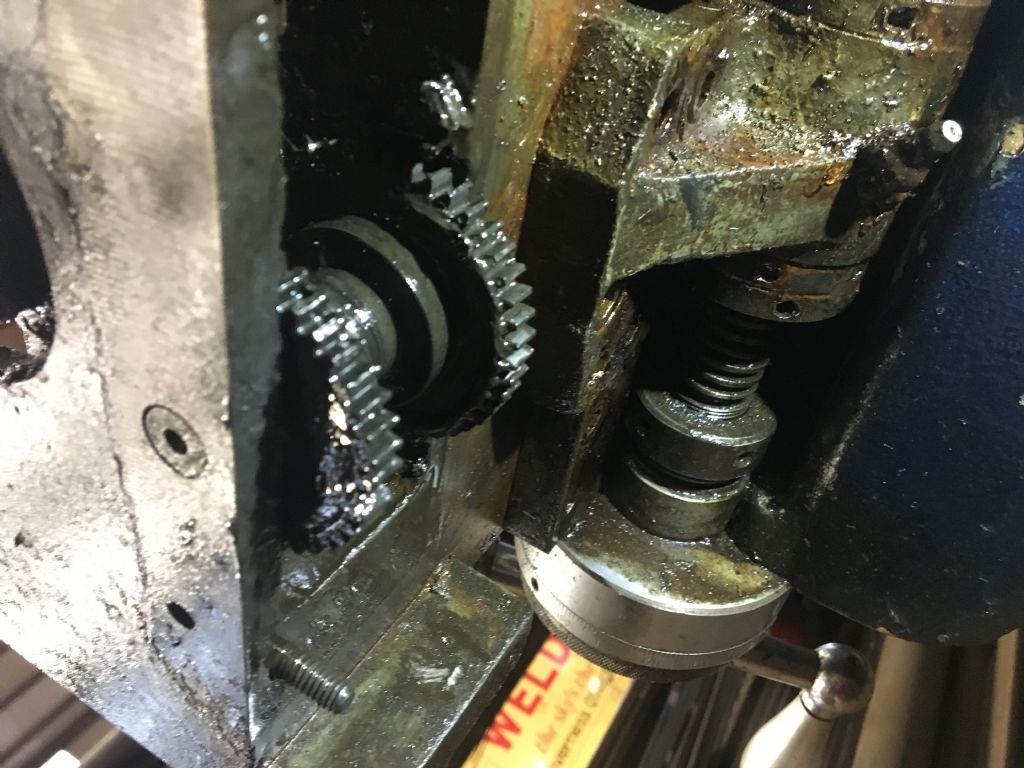

                                                    Mark Guy
                                                      @markguy26995
                                                      I have ran in to another problem now whilst trying to reassemble the bed without the power feed. And that is the woodruff key in the outer shaft drive will not line back up with the key way in the lead screw and I can’t seam to turn them independently for some reason. I would have thought they would only be as one when the dog clutch was engaged on the power feed
