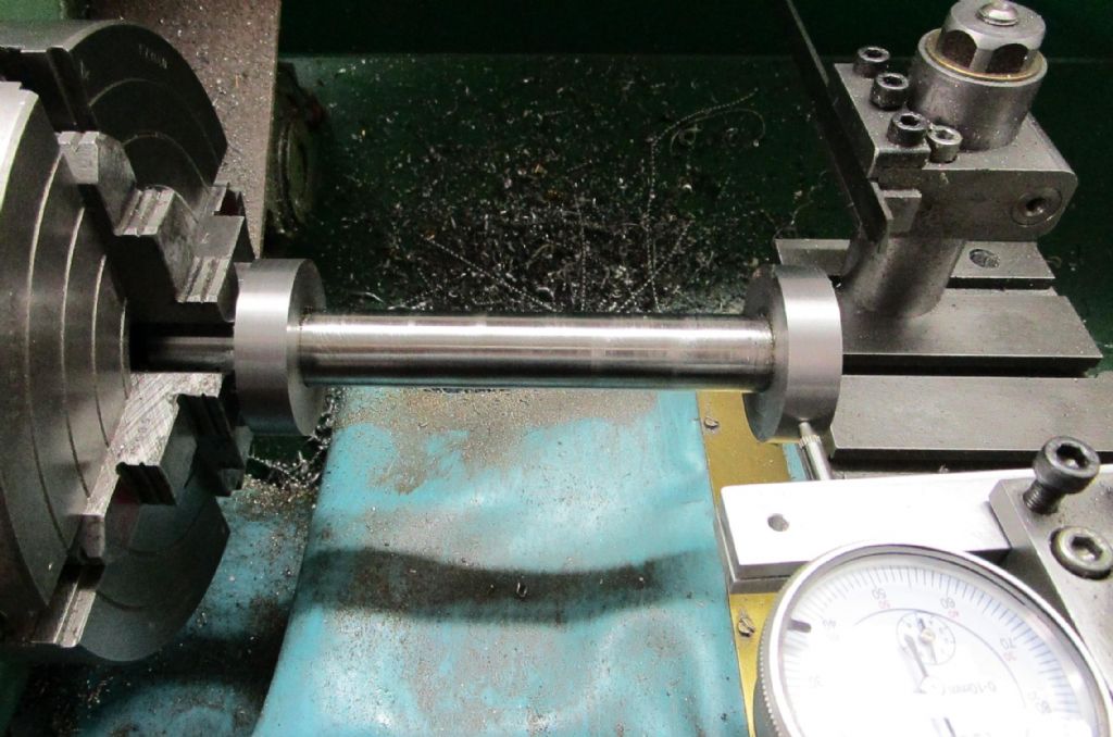

        If I set up a test bar in the four jaw chuck, in this case a known true 20 mm diameter bar 200 mm in length, so that I cannot measure any deviation when clocked at the chuck, but find that it is several thou out at the tailstock end 150 mm away.
        A micrometer tells me that the bar is exactly the same diameter along its length.
        Why !

                Hi Guys,
                Thanks for the replies.
                After I posted I thought I would go into the workshop and take some pictures.
                I've added notes under the pictures.

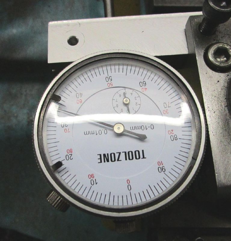

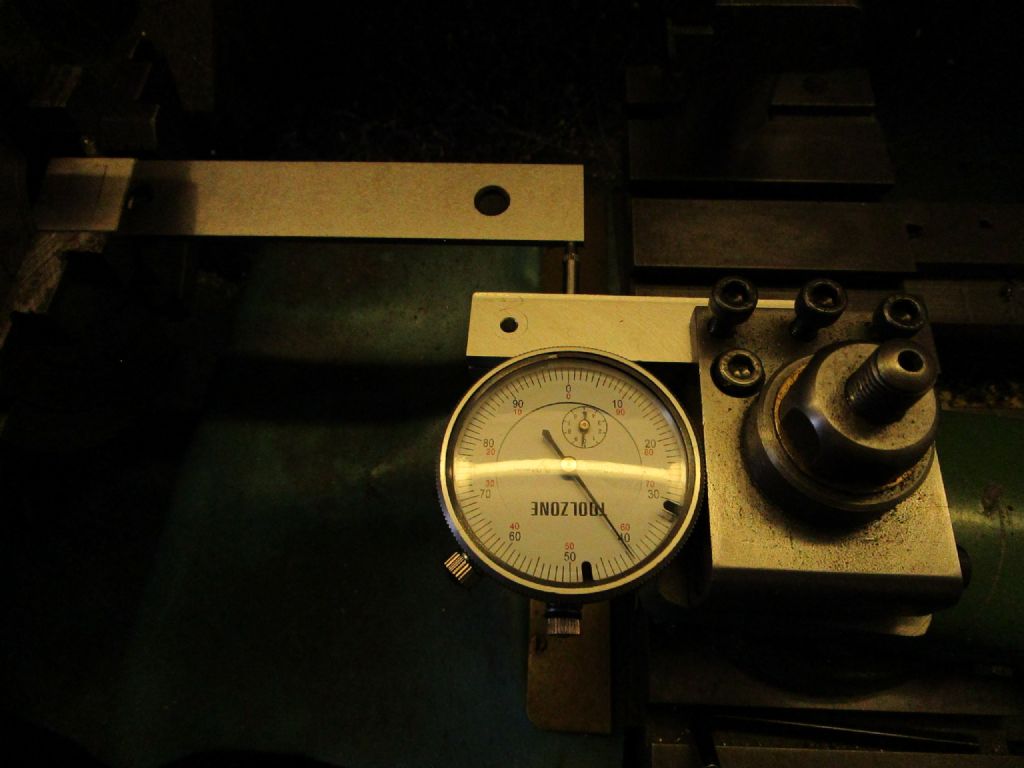

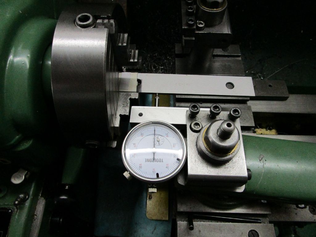

                This was the setup that I used to verify that the chuck was running true. The gauge isn't reading zero because I haven't started at this point.
                Same setup from another angle. There is less than a needle thickness variation when rotating the chuck.
                This chuck is the original Myford one that has not been used from new until recently even though its 40 years old.

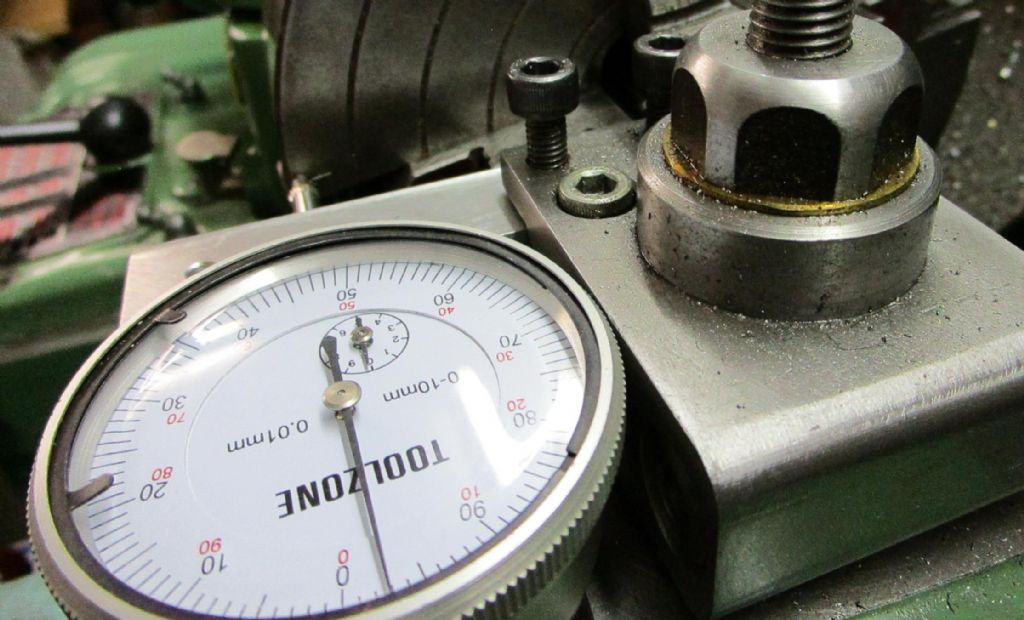

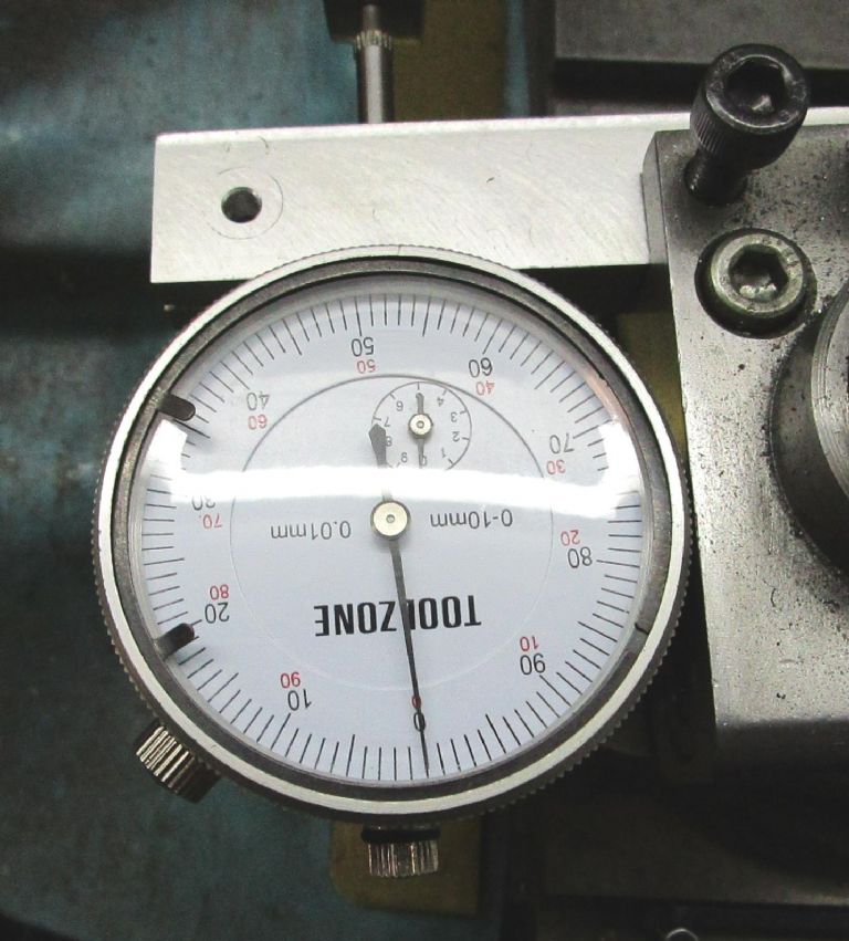

                This is the two collar setup that I used. Those collars are 44.0 mm diameter within a couple of tenths of a thou.
                The shaft they are on is a piece of 20 mm hydraulic piston rod.
                This is the collar nearest to the chuck with the lathe rotating.
                This is the maximum deviation on the collar nearest the tailstock with the gauge zeroed. I did rotate the bar 90 degrees and remeasured. Oddly the amount of deviation barely changed.
                I can't get my head around why I see this behaviour. I only noticed this because I wanted to check that the lathe was still turning true.
                Edited By John Baron on 16/05/2020 17:41:34

                  So both ends of the bar run true when the chuck is rotated, but the axis in plan view shows the headstock in not in line with the bed. I hope my understanding is correct. While you are set up, try the height of the bar from end to end also.

                    Looks like the beds twisted. I bet if you took a skim off those collars they would end up different diameters. You need to adjust the lathe mounting.

                      Ok for that setup to return a reliable result you need to have turned both collars AND the piece of bar that's held in the chuck whilst holding the bar between centres, and verified that the collars are both exactly the same diameter after turning. Otherwise you do not know that the two collars are perfectly co-axial to the bar centreline.
                      Otherwise, if you're 100% sure that the bar is not bent try the dial gauge directly on the bar.

                          Posted by old mart on 16/05/2020 17:56:28:
                          Not quite. If I choose the closest point to the tool holder on the tail end collar and rotate the chuck the dial gauge reading moves to just over 30 divisions at the furtherest point.
                          Now I did rotate the test bar 90 degrees and the reading stayed the same, so the test bar is straight. Actually I tried rolling the two collar bar down a flat surface to see if it followed a curve. For all intents an purposes it doesn't.
                          Answering some other comments.
                          The lathe bed is not twisted ! That two collar test bar was skimmed in the soft jaws of the three jaw chuck and the collars are within a couple of tenths of a thou of each other.
                          One thing that does bother me though, is that I can true the end collar to read dead true, but when I come back to the chuck end, I'm back to it not being true, though its not as great a deviation, only about half that.
                          I'm about ready to bang my head against the wall…

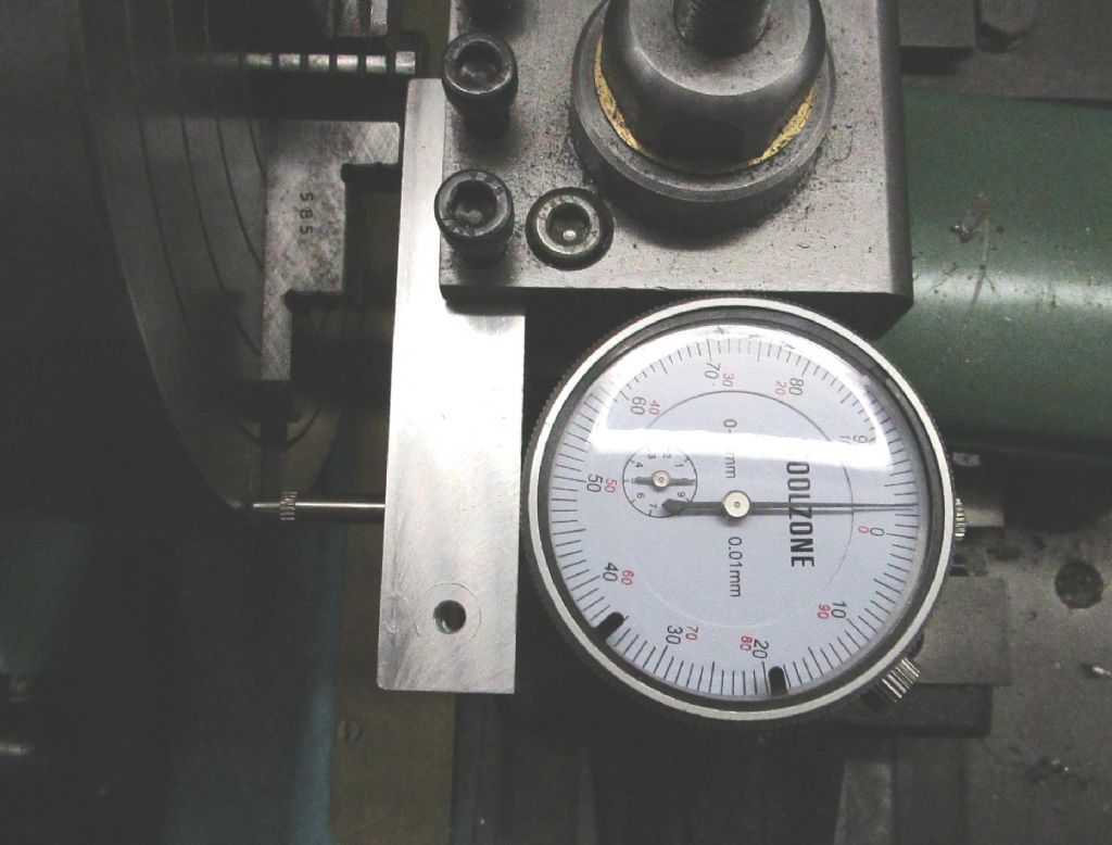

                                            [quote] The chuck body runs true but the jaws do not hold the part straight. If all of the above check out OK, this is the last option.[/quote]
                                            Comments below the pictures. By the way I somehow managed to take a video but the forum won't let me upload it.
                                            I used a 1" inch parallel to check how straight the jaw was. I used a piece of postcard and a small dowel to hold the parallel tight up against the jaw face. I set the dial gauge so that it was level with the edge of the parallel.

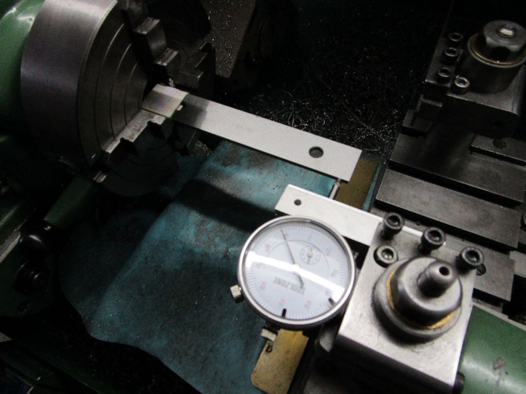

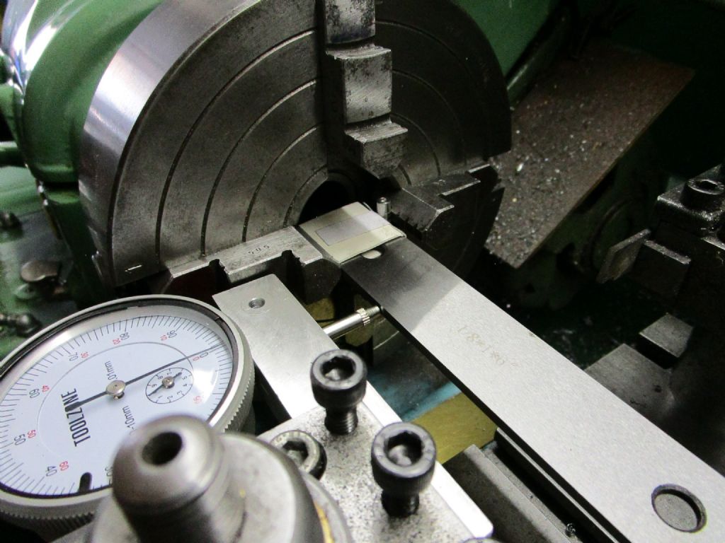

                                            In this picture you can see the arrangement. This is jaw No:4.  I used the lower jaw to support the parallel.
                                            In this picture I've run the dial gauge down to the end of the parallel. It shows that its moved away by about 0.6 mm.
                                            Sorry about the colour, fluorescent lighting. This jaw No1 was the worst one. I stopped taking pictures at this point.
                                            All the jaws have some runout when measured in this way ! I'm not sure why but they all seem to run away from the tool holder. The worst ones were jaws 1 and 2. When I gripped the parallel by the flat sides you could see that the indentations in the cardboard were deeper on one side.
                                            It also explains why I can set the work piece true at either end and its out at the other.
                                            So it seems that I've got the source of the problem… badly or wrongly ground jaws. After all this time I doubt that there is any point in having a word with Pratt Burnard.

                                                  I'm sorry John but that test you show could be reading bed twist (or wear). All of the checks you make need to be rotational checks. Your issue is one of runout, so all your checks need to be for runout.

                                                    I'm getting a bit lost now ! The idea behind that last run of checks with the parallel were intended to check that the face of the jaws was square to the axis of the lathe. Which they don't seem to be. I cant get my head around being able to swap to the three jaw and turn a bar parallel over roughly five inches in length with less than a couple of tenths variation from end to end.
                                                    The thing that really bothers me is why then when I check each jaw the parallel seems to move away from the gauge. To me that suggests that the jaws have a taper running away towards the back of the chuck. I've checked the guides in the chuck for each jaw and they are virtually the same reading from the outer to the inner. Maybe a division at most.
                                                    I'm going to take the jaws out and see what I can find, I did notice that the two jaws with the greatest deviation were the most loose in the guides.

                                                    #472407
                                                      If both sides of the parallel run away from the tool holder then it isn't the chuck at fault.
                                                      If the parallel is parallel then opposite sides should go in opposite directions.
                                                      Something is not right with your test.
