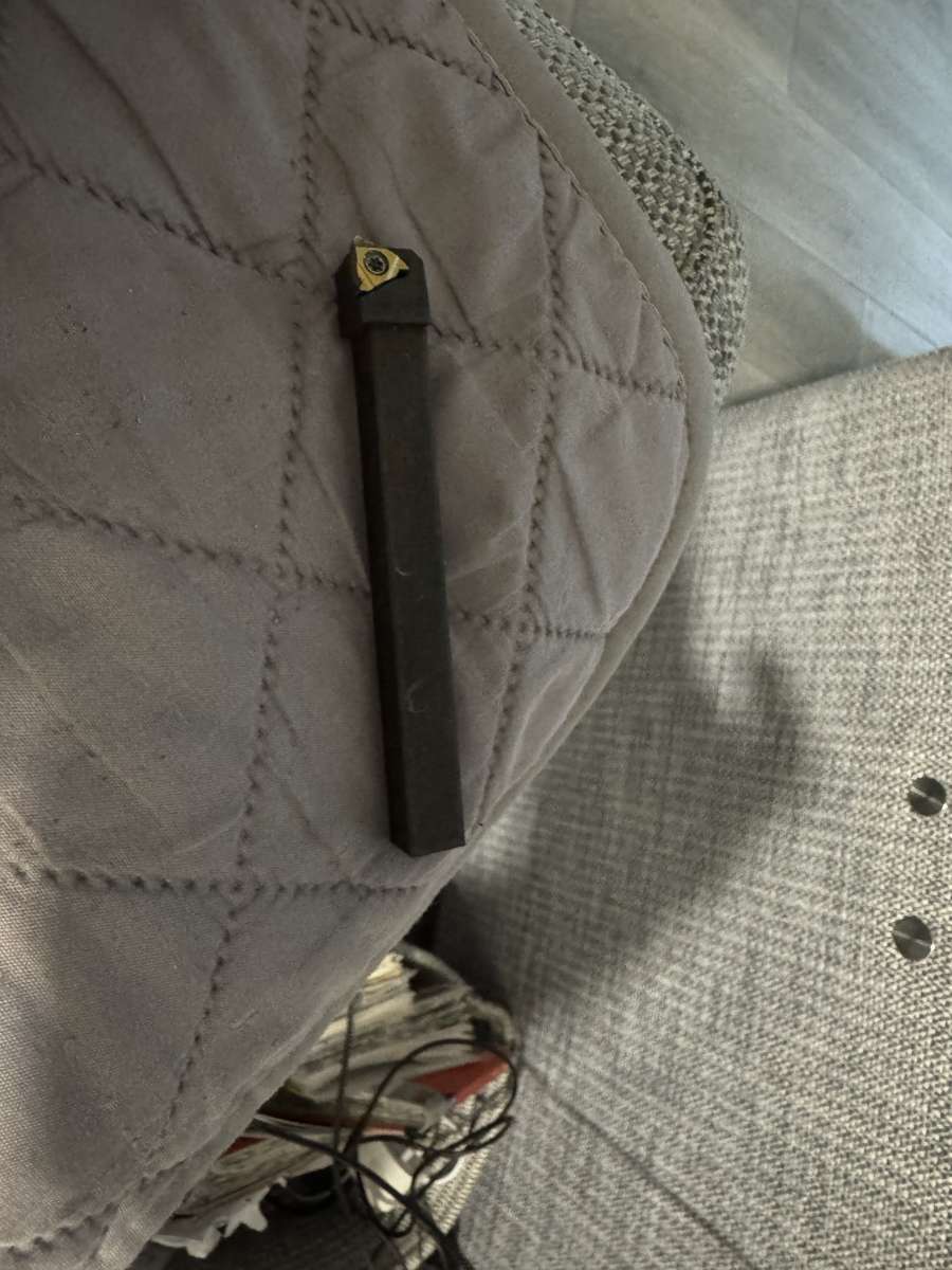

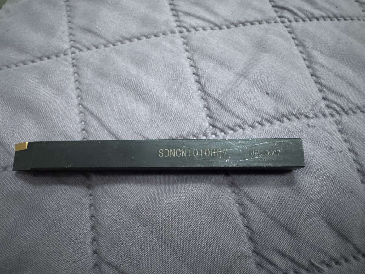

      I’ve just bought a Warco WM180 lathe which im slowly learning how to use. I bought it primarily to make aluminium bronze bushing.
      I bought a cheap set of tools with inserts just to practice with. I’ve got a set of HSS tools on order.
      from the picture can anyone tell me if the insert number is identifiable so I can buy some more? All the different inserts are confusing to say the least!
      thanks
      IMG_1726
      #813758
      Diogenes
        @diogenes
        That looks like it is for ‘DC**07020*’ inserts – so for example, something like DCMT070204, or DCGT070202 – broadly, the letters define the shape and style and the numbers represent dimensions.
        Commonly the choices are between M for ‘Moulded’ or G for ‘Ground’, and the final variable requiring you to make a choice is the last number which represents the tip radius in tenths of a mm – usually available in 0.2, 0.4, or 0.8mm
        For most applications (and especially non-ferrous work) the ground DCGT inserts are usually best choice for a hobby machine, and a 0.2mm radius would probably also be better – so those inserts would be ‘DCGT070202’.
        DO the other holders in the set use the exact same tips?! – if not you’ll have to post them individually – some sets are ‘mixed’
        – also have to say that particular tool shape would not be the one I picked out first – is there one called ‘SDJCR’ in your set?

            Hi,
            thank you for the reply it’s very helpful.
            Yes there is a SDJCR1010H07
            MGEHR1010-2
            SCLCR1010H06
            S10K-SCLCR06
            SNR0010K11
            plus this one that isnt marked
            IMG_1732

                MGEHR ****2 – use grooving / parting inserts MGMN200 (‘straight’ across the front) or MRMN200 (with radius). The 200 indicates they are 2mm wide.
                The turning tool and boring bar marked SCLCR use CC*T 06020*, same conditions apply as with your DC*T inserts so use CCGT060202 (or CCGT060204 if you want a bigger tip radius).
                SNR0010K11 is an internal threading tool for 11NR partial form threading inserts –
                The unmarked tool should be something like SER1010H16, an external threading tool for 16ER partial form threading inserts –
                – with these 11 & 16 denote size, N & E denote whether interNal or External, and R is for Right-cutting (i.e. tool moves towards the chuck).
                Don’t know whether you know about thread angles, but very simplistically ‘55′ inserts are for Whitworth and other threads with 55 degree flanks, and the ‘60′ are standard for ISO metric and UN-series threads – you may come across other or uncertain thread-forms and you can always ask again then..

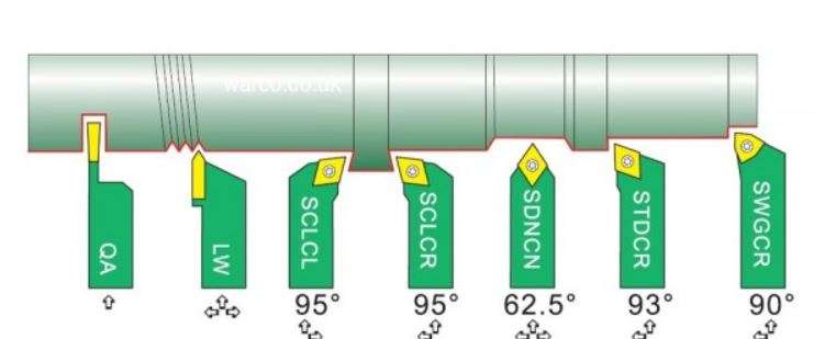

                  #813776
                    If you want to understand the code on the holders then this page from Cutwel is quite easy to follow
                        The Cutwel picture showing the “height of the shank” also refers to the insert tip height.

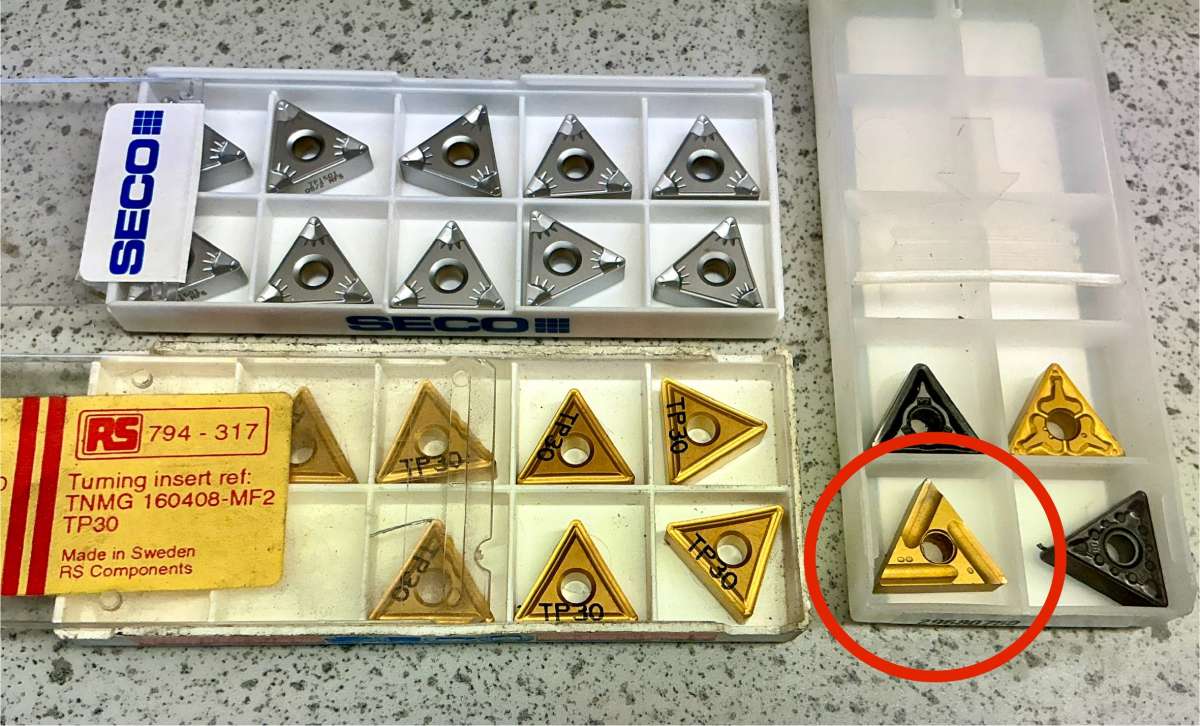

                                  For cutting Aluminium Alloy, all the polished type inserts I’ve bought, in several styles, have worked very well. Even the cut price ones from Amazon and eBay etc. For cutting steel it’s been a bit different. I often use HSS in a tangential tool but have experimented with a few different inserts. Most have, once again, been bought quite cheaply. They have had a variety of different styles to the actual geometry of the tip but once again they’ve all worked well enough. I’ve recently been quite impressed with one particular insert that I got from Jenny of JB tools some time ago. It’s the one circled:
                                  IMG_4917

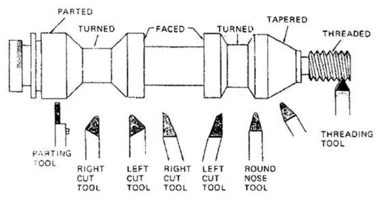

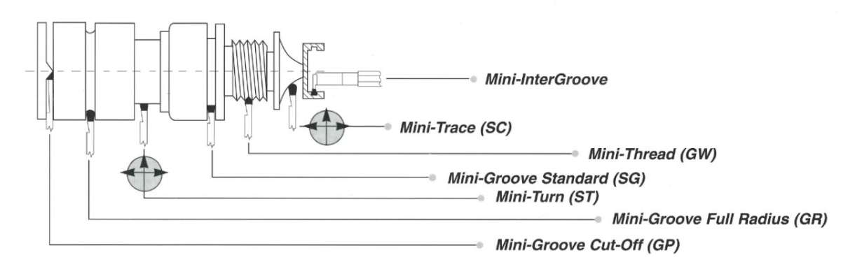

                                        Mmm … I thought this [from the page I linked earlier] was rather a good reference for the neophyte
                                        IMG_1017
                                        #814244
                                          it’s not actually that good for a beginner.
                                          Parting tool should be shown opposite the groove as it looks like it is turning the OD
                                          Round nosed left and right would only do the OD as they can’t get into the sharp internal corners
                                          Unrounded Right and left would again be better if inline with thesurfaces they could “face”
                                          Neutral round nose is about OK for the OD but again if used at an angle won’t cut the tight internal corner shown
                                          Threading OK
                                          More like below or this, with feed directions shown and surfaces that can be cut in red. No wonder beginners go for Carbide these days!!
                                          cuts
                                          mini
                                          #814268
