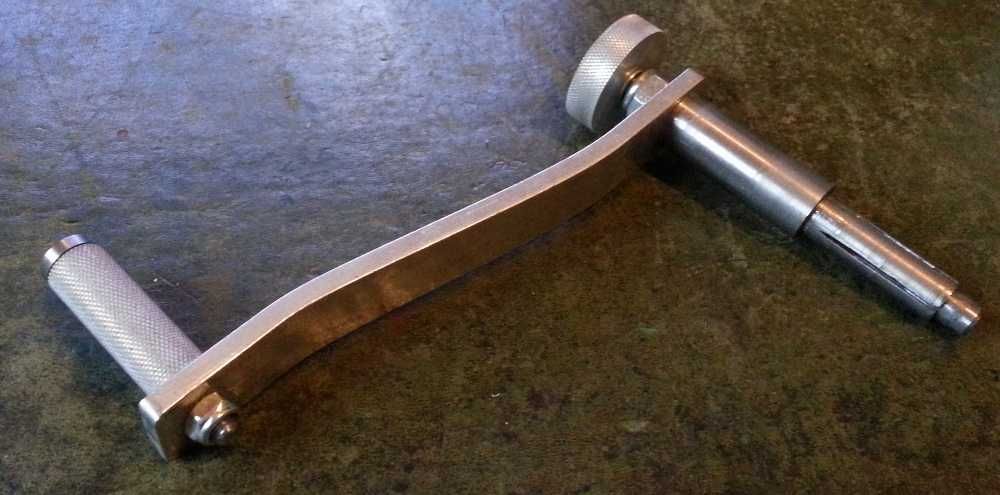

                        Gordon Brown 1
                          @gordonbrown1
                          Having given some thought to what I was doing wrong I realized that John Stevenson was at least partly right, I was disengaging the half nuts and winding back, but I was using the thread dial indicator on the carriage as I had done when I last cut some imperial threads. Being a raw beginner I had assumed this would work with metric threads, which it clearly doesn't. Winding back by hand was very hard work as the back gears were engaged and I didn't have a spindle driving handle. So, I've spent the weekend making a handle from my own design and it works a treat. The design is my own with ideas from photos I found trawling the net and it gave me the opportunity to use the knurling tool and tailstock die holder I was given for Christmas. This should make life a good deal easier!
                          As yet I haven't attempted to redo the exhaust adapter as I'm still considering the best angle to make this as I want to keep the silencer completely within the cowl of the aircraft and as I now have my lathe sorted I may even make a complete new silencer. For anyone who is interested the aircraft is a 71 inch span Mitsubishi Zero powered by an ASP 120 four stroke, it's a big b***er, should weigh around 12 pounds ready to fly
                          As I've said, I'm a complete beginner having bought the lathe some time ago to make parts for rc aircraft and it's taken ages to get to this point and I'm learning from that very hard teacher, trial and error, mixed in with advice from forums and books. Great fun though! The lathe was an EBay purchase, but I had the opportunity to inspect before buying as it was just a few miles away, and £300 for a decent ML7 with loads of accessories and tools struck me as a good deal. My biggest problem I sorted by myself; after I'd had the lathe a couple of months it started to chatter when cutting and this got progressively worse until I was despairing of ever being able to use it. I checked the bearings (plain ones), negligible play, carriage, cross and top slides were as rock solid as could be, lathe well bolted down and level, no significant vibration from motor, etc, etc. Having left it alone for a couple of months I went back to it last week and whilst checking the spindle I noticed that the locking collar on the end of the spindle was loose, giving about 20 thou of end float. Nipped it up to give about 0.5 thou float and lo and behold the chattering has gone completely. Not something I'm likely to miss again!
                          Many thanks for all the replies, if I still have problems when I redo the adapter I'll be sure to use some of the suggestions.

                                  I'm using the back gear to keep the speed low, would it be better just to cut the thread by turning the spindle using the handle? It's only a short length of thread, about 3/4 inch long.
                                  #219276
                                    Posted by Gordon Brown 1 on 04/01/2016 09:07:27:
                                    Yes

                                                As the OP I can confirm that my threading tool has a small radius on the tip, at least I got that bit right! I would however, point out that aluminium is an excellent choice for the exhaust adapter as the engine it is fitted to is not on a motorbike but is a 20cc four stroke designed for rc aircraft, see my previous post for details.
                                                Having made the spindle turning handle I intend to cut the threads by hand turning the spindle with back gear disengaged, did a trial (without workpiece) this evening and it's easy enough to turn. Just got to cut and shape another piece of 15mm plate to try it out for real.
