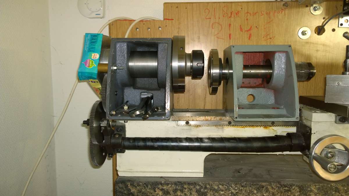

      Can’t see what the problem is. You could turn the larger diameter on a short stub of material, so not going to be anymore cutting force turning it on a longer bar. Assuming you don’t go silly and hang 3m lengths out the back. Start up load not a lot different to having say a 9″ dia part on a faceplate.
      #871755
      Niels Abildgaard
        @nielsabildgaard33719
        The problem is bending stiffnes of spindle between the bearings .
        The two headstocks shown before have same length between bearings
        Bending stifness is a power 4 function of diameter
        The 180 comes with a 30mm spindle and have a 21mm hole
        Bending stiffnes 61 in some strange units
        The 210 have a homemade 60mm spindle with a 49mm hole
        Bending stiffnes 720 in same strange units
        Important for onset of chatter and surface quality
        #871774
        Niels Abildgaard
          A 210 and 180 from same well reputed house
          Amount of cast iron,steel and machining is almost the same.
          Price not very different.
          Lost opportunity
