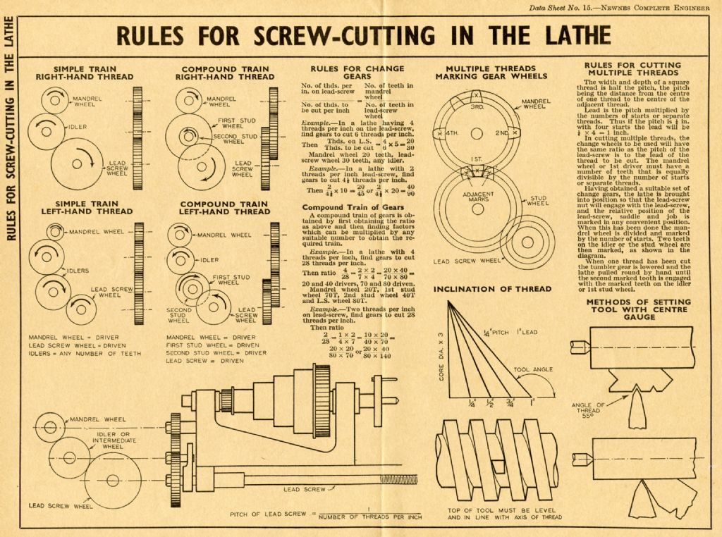

            Hi Jamie, your photos don't show, so follow JasonB's link, but this scan may help you understand a bit about Screw-cutting on the lathe.
            Regards Nick.
