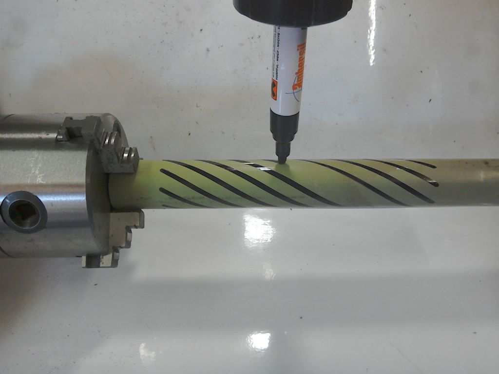

                        You will need a lot more than a 2mm pitch thread, depending on the diameter and number of starts the pitch will be in the region of 1 to 2 times the diameter of the grip.
                        To do it you will need to workout the changewheels and to save straining the machine you turn the LEADSCREW by hand and that drives the spindle. Multi starts are best done with the topslide set along the lathe axis and if say using a 3 start thread then move the topslide 1/3rd of the pitch for each pass, 1/2 pitch for 2 start.

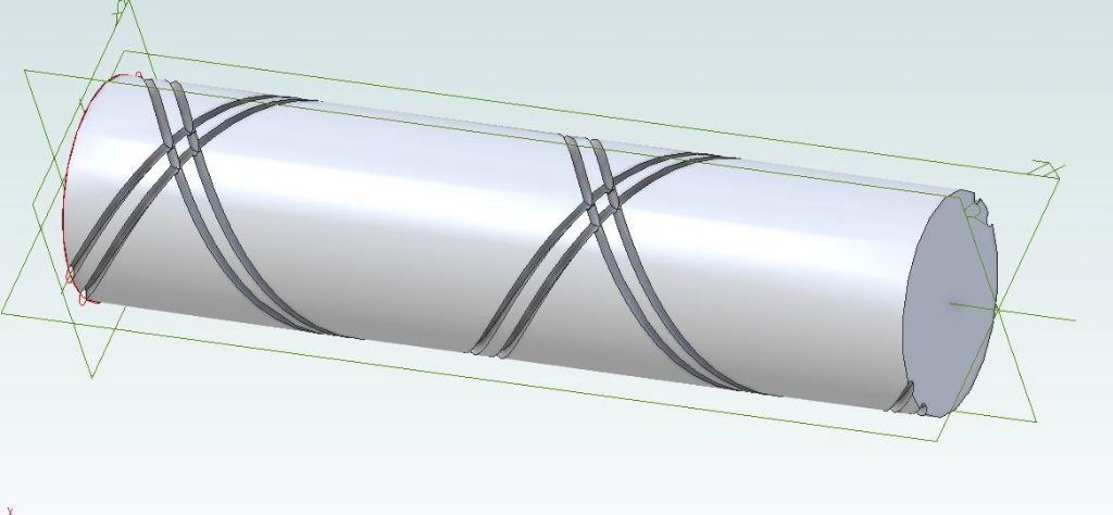

                            This is what you want I presume.
                            This was an example for another thread from July 2018. Not easy on a lathe, you need a pitch equal to the circumference to get 45° helix angles. It is an example of helical milling which used to be done with a gear driven head mounted on a milling table but is now relatively easy to do with CNC if you have it.
                            On a lathe as you said driving the leadscrew would be best if you can set up suitable gearing, seems unlikely to me but you may find a way.
                            For a hand grip of about Ø25mm you would need a pitch of about 78.5mm. You then need to be able to index the part around by a suitable amount to get evenly spaced grooves. So let's say use 72mm pitch then you can divide this easily by 3 to give 24 positions around the circumference by just moving the carriage further along the leadscrew. Use similar sums if you have a machine with an inch leadscrew. This will be close to but not actually 45° but you could use a wooden dowel and marker pen to see if it works.
                            Martin C

                              he’s looking for a very coarse pattern, perhaps only two full diamonds around the circumference, ie 2 node points. I think that’s what a twin start, left and right hand spiral gives.
                              having equal angles doesn’t seem important, so elongated diamonds would be OK.
                              I think a 3mm pitch is the biggest available as standard on the ML7, which would have been ok to try. I don’t think this would have needed the leadscrew turning.
                              Anyway, getting the start points seem tricky, and also inverting the tool. Perhaps it’s a process too far at this stage.

                                You should just be able to reverse the leadscrew, I'm sure Myfords can do that so tool stays same way up but just cuts from the chuck to the tailstock for LH threads.
                                3mm pitch will still be way too little, compare the 3mm or 1/8" pitch of your leadscrew to the pitch you have drawn on the cardboard tubes to see how much longer the pitch needs to be. You just need to play with what change gears you have to get the longest pitch you can and try it with a sharpie in the toolpost like my video.
