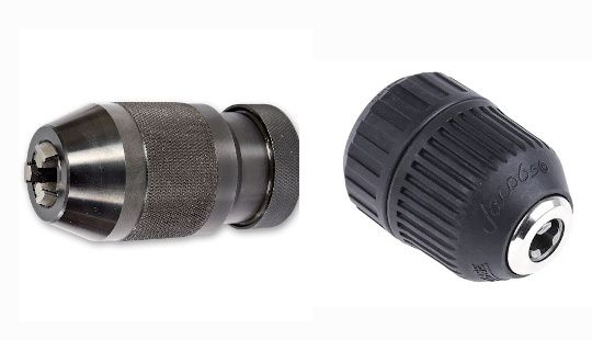

      Good Morning, I am thinking of investing in some form of battery powered drill, principally for power feed to the top slide when machining 2 morse tapers. However, I am aware that when run in reverse, keyless chucks no longer grip drills, etc., so the reverse facility seems on the face of it to be a rather useless feature. All the drills that I have seen so far, are keyless, so maybe I should consider a powered screwdriver instead?. What do other members do?. Regards, Lynne

          Keyless chucks on the average hand-held drill do not work in the same manner as the far more expensive keyless chucks you would buy for use in the lathe tailstock. Power drill chuck lock and quite happily transmit torque in either direction and you will have to undo the by hand.
          Engineering type keyless chuck on left and power-drill type on right.

            I have no problem undoing screws with a quick change holder held in my cordless and am more likely to chew up a screw head or shatter a bit before the chuck lets go.
            Your biggest problem is likely to be that the lowest speed you can maintain on a cordless drill will be a bit to fast for a nice finish. A small screwdriver (not impact driver) would be better for slow speed and therefore slow feed.

              All the bosch power drills I have had over the years have been used as power drivers too and I have not had issues running in reverse. The chucks do tend to go screek when tightening so maybe they encorporate some kind of ratchet brake which maintains the grip. My lathe keyless don't do that and they definitely undo in reverse thrust. Maybe you are overthinking this?
