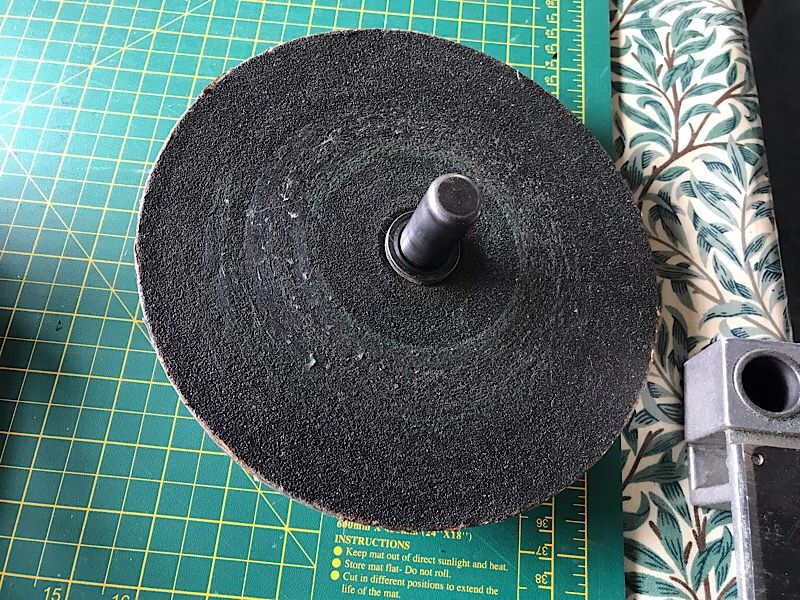

      hi everyone can anyone advise me.i,ve got a roll of flat machine belt ,green canvas rubber impregnated i want to scarf it and glue it together but it needs a special heat press does anyone know of a way of heating the belt while clamping

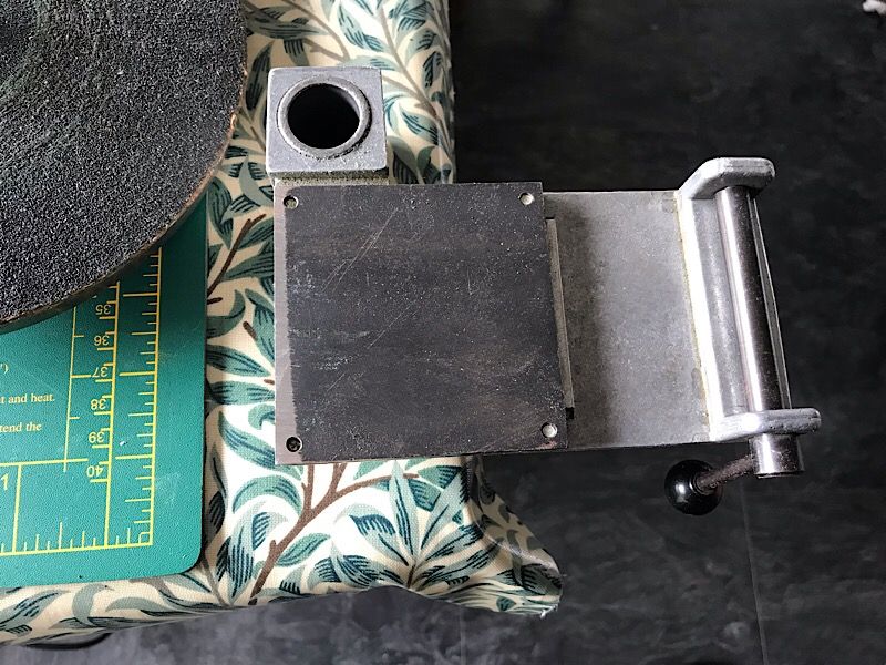

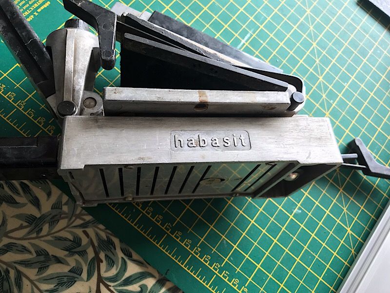

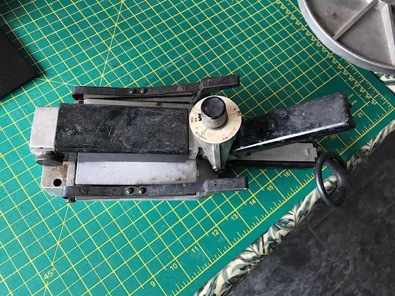

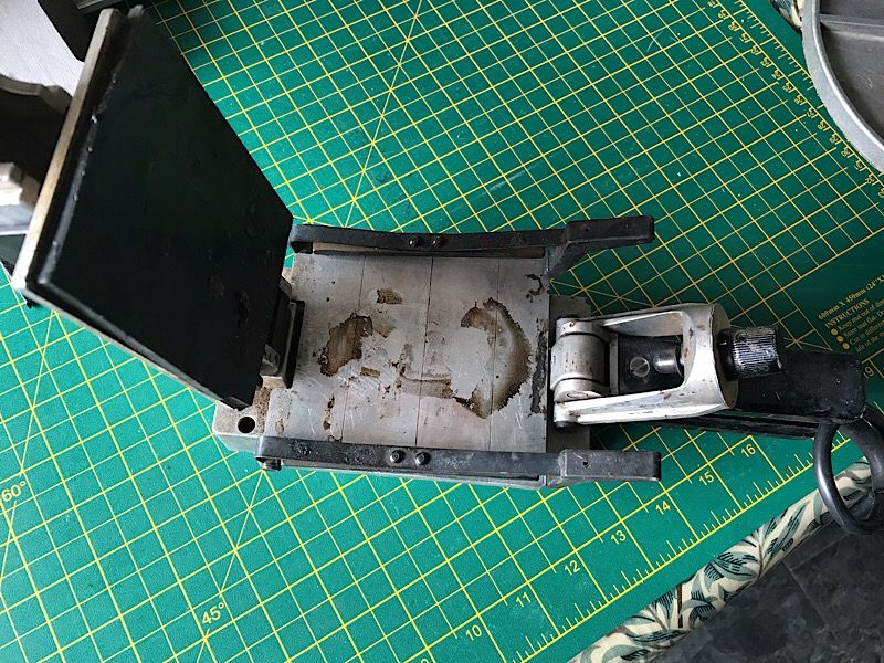

            You probably have a habisat belt
            this the official kit that they recommend.
            #406692
            Ian Parkin
              @ianparkin39383
              Though if you just clamp your scarfed joints into 2 slices of alloy and hold it at 100 c for 30 mins you should be good to go
