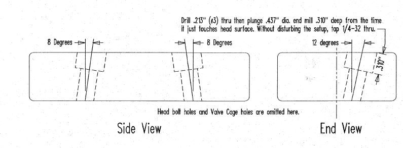

      I'm after some advice on how to set up and drill the spark plug holes in the cylinder heads .I think the attached drawing shows what is required.
       I have aTom Senior light vertical milling machine , tilting angle plate and tilting vice.
      Thank You
