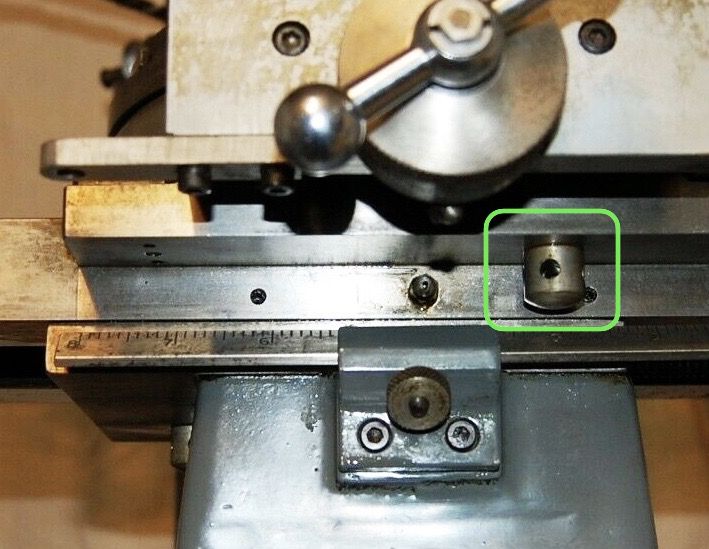

                                      Edit: for anyone still confused … this is the style of screw which I believe Mark is making:
                                      Adapted from : http://www.lathes.co.uk/bca/page4.html
                                      Edited By Michael Gilligan on 30/08/2021 17:55:05

                                          Yes, I might just plate the nickel directly on the steel.
                                          Michael:- Them're the ones. Even in the photo it's possible to see the colour difference between the handle and the dial, screw, dial gauge mount etc. Not that it matters.
