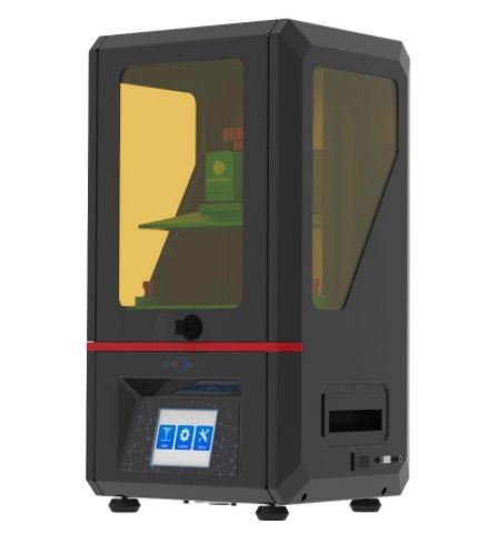

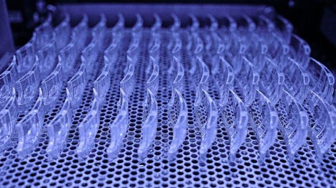

            The Novice Engineer
              @thenoviceengineer
              Hi
              It depends on how deep your pockets are and how open you are to new technologies !
              My suggestion would be to use 3D SLA printing
              With SLA printing it takes the same time to print a plate of lots of items as a single item.
              I have had some good results using an Anycubic Photon , not as expensive as some models to buy [£100's rather than £1000's]
              Steve
              Edited By The Novice Engineer on 13/01/2021 22:52:25
              Edited By The Novice Engineer on 13/01/2021 22:59:12
