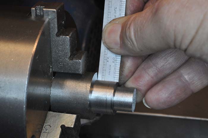

      I've heard it said that light lathes like the Myford 7 series can only nibble away at turning.
      I've just re-ground my "shifting" tool:
      3/16" depth of cut, that's 3/8" off the diameter.  FC mild steel.
      Cheers,
      Rod
      PS.  The lathe is going the right way!

          But what feed rate?

              2 thou per rev. Not sure how to answer Roy's query – It's a standard Dickson QCTP mounted on the top-slide.

                The high shear angle means the tool will not last as long as one with a less steeper angle, which may be of no consequence to the job at hand. You will be just sharpening the tool more.

                    Posted by Roderick Jenkins on 07/03/2016 16:12:13:
                    Cheers,
                    Rod
                    Just out of curiosity I had a play also.
                    Depth of cut was .250 thou (so 1/4 off dia. Feed rate was 6 thou per cut.
                    Oh and it was EN8 wink
                    Could I should think have gone quite a bit more aggressive if I had used a centre in the tailstock. – Perhaps even more if I had switched the flood coolant on.

                      Posted by Nick_G on 07/03/2016 17:11:50:
                      Something not right there do you mean 0.125" DOC as it looks about half the width of the tangental tool which is quite wimpy really

                        Posted by JasonB on 07/03/2016 17:06:53:
                        Less top rake than Rods thats why its breaking the chips,
                        I don't think I've got any top rake, just lots of side rake wink
                        I did wonder if this thread might turn into a tool waving exercisesurprise
                        Rod

                              The "know your lathe" book advises roughing tool edge included angle of 61 degrees so no casual grinding to only 60 degrees you lot. frown
                              #228852
                                Posted by Ajohnw on 07/03/2016 17:38:38:
                                I think Jason's chips breaking are down to the lathe not the tool. Also looks like there is more signs of tearing than Rod's.
                                I'd agree that there is some tearing which I would expect with less cutting angle but as for the chip breaking being due to the lathe, that is definately down to the tool.
                                This is the tool used for the first video, which was straight off the rack not freshly sharpened like Rods. Maybe 5deg top angle
                                Now this is the same tool but given some more top angle to give a sharper cutting angle on the off hand grinder no touching up with a stone.
                                And here you can see the increase angle which results in curly swarf that wants to wrap itself around the tool which is why I stopped the video a bit sharpish.
                                Swarf looks quite cleanly cut too. You can also see the better (not perfect)finish on the remaining 1/2" dia, the blue mark is where the first cut stopped and the second started. Face of the bar looks cleanly cut too.
                                So in answer to Rods questing – its the tool
                                In normal use I would not be taking cuts like this, rather use a carbide tool at 1000rpm and about half that depth of cut. Two passes will still remove the same amount of metal in less time than with one slow deep cut and put less strain on the machine.
                                J

                                    The main issue with the tool shown is that there is no chip control. Have you considered grinding the top of the tool so there is a rounded groove giving the required side rake and acting as a chipbreaker?

                                              Poor little mini-lathe chatters a bit a 3mm depth of cut, but then I was using a tip marked as 'light finishing' and my home made QCTP.
                                              The built in chip breaker means I can't show off any curls of swarf.

                                                Which, I think, helps to emphasise that it's the tool that makes the difference. In some circumstances on modern low power and stiffness lathes it is better to be guided by some old school techniques developed for treadle lathes rather than modern industrial practise. I do, however, use all sorts of replaceable tip tools for most of my turning.
                                                I put up with the curly swarf – Normally I use a pair of 10" surgeons forceps to pull it out of the way.

                                                  To answer the question, technically it's both the tool and the lathe, because one would be lost without the other!
