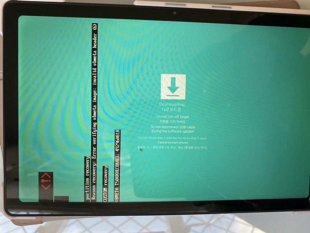

      wife came in with her samsung tablet and asked can you sort this normally I can but not this time ! The tablet cannot be turned off no matter what keys you press nothing happens, I let it go flat but upon restarting it's still there any suggestions ( mine is a lump hammer )

              Swarf, Mostly it's android
              Jon can get it to restart holding the power button down but just restarts into the same screen. The Wife tells me she turned the tablet on and it came on as the photo crying

                do a (Firefox) search using “invalid ubmeta header” then read the last posting re this posted in forum.xda-developers.com – however tho it sounds simple I suspect if still in warrenty better to take to shop where purchased or find a local Android guru – somehow the image of the operating system has been compromised (?hardware failure ?attempt to overwrite)

                  Harry, I too have a Samsung Android tablet. It regularly updates itself, downloads the data when connected to wifi and not doing anything else and then installs the update. Looking at the other part of the message on the screen it would seem that it has crashed during an update. The download could have been corrupted (it should check that) or it has just missed a beat if the cable was pulled at the wrong moment.
                  The long press on the Volume down and power button at the same time should (in theory) induce a factory reset mode. There are other combinations of button presses that do similar depends slightly on which model. It is possible to reload the factory software but it requires extra software and a lot of patience

                      Following Frances' lead suggests the image is corrupt and needs to be replaced. (Jargon alert – the 'image' is a copy of the phone's operating system, not a photograph.)
                      Ordinary users rarely need to worry about the operating system unless it goes wrong as it has here, cause unknown.
                      Attempting to start, the phone has detected the image is corrupt and is attempting to download and install a new one from a PC. What's required on the PC is:
                      1. A bunch of files provided containing a clean operating system. These are provided by Samsung and have to match the phone. A quick search found developer images but not user images, but my Google-fu is weak. Once found these are copied to the PC.
                      2. A program called Odin, available here. This detects an Android phone connected to the PC with a USB cable and allows a new image to be burnt on the phone. The screenshot shows the phone has found an image error, has entered recovery mode, and is waiting for Odin.
                      I've fixed equivalent Windows and Linux OS corruptions, but not Android (or Apple). The process can be fiddly and using hard to drive tools. I've no idea if Odin is wonderfully easy to use or a complicated pig stuffed with unexplained options and weird abbreviations! Odin available for download is said to be proprietary Samsung software that's been pinched – slightly worrying!
                      Unless I fancied an adventure, I'd give it to an expert to fix. Harry might try Samsung's service website to find one, or these people who come to the door and claim to be cheaper.

                        Odin is not the most user friendly of programs. Not recommended unless you know what you are doing. It is quite possible and relatively easy to 'brick' the tablet without trying, assuming it is not already in this state. You are playing with things not usually encountered by tablet or phone users. This is deep into nerd land. I have done it to install custom ROMs on phones but would not recommend it to a basic user.

                                          Have tried all the 'holding down key options' nothing will change the blue screen even tried plugging it into my laptop but thanks for your replies
