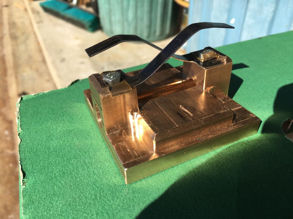

              Similar to Andrew, The slide valve on my Ruston TE has a slide valve on the side which kept falling off and not sealing when steam was shut off. Then bang back on when turned on.
              A simple flat leaf string attached to the back of the slide valve (made from "Band-it" steel strapping) and rubs against the back of the cover plate fixed the problem. Very little force is required to hold the valve, just enough to keep it seated.
