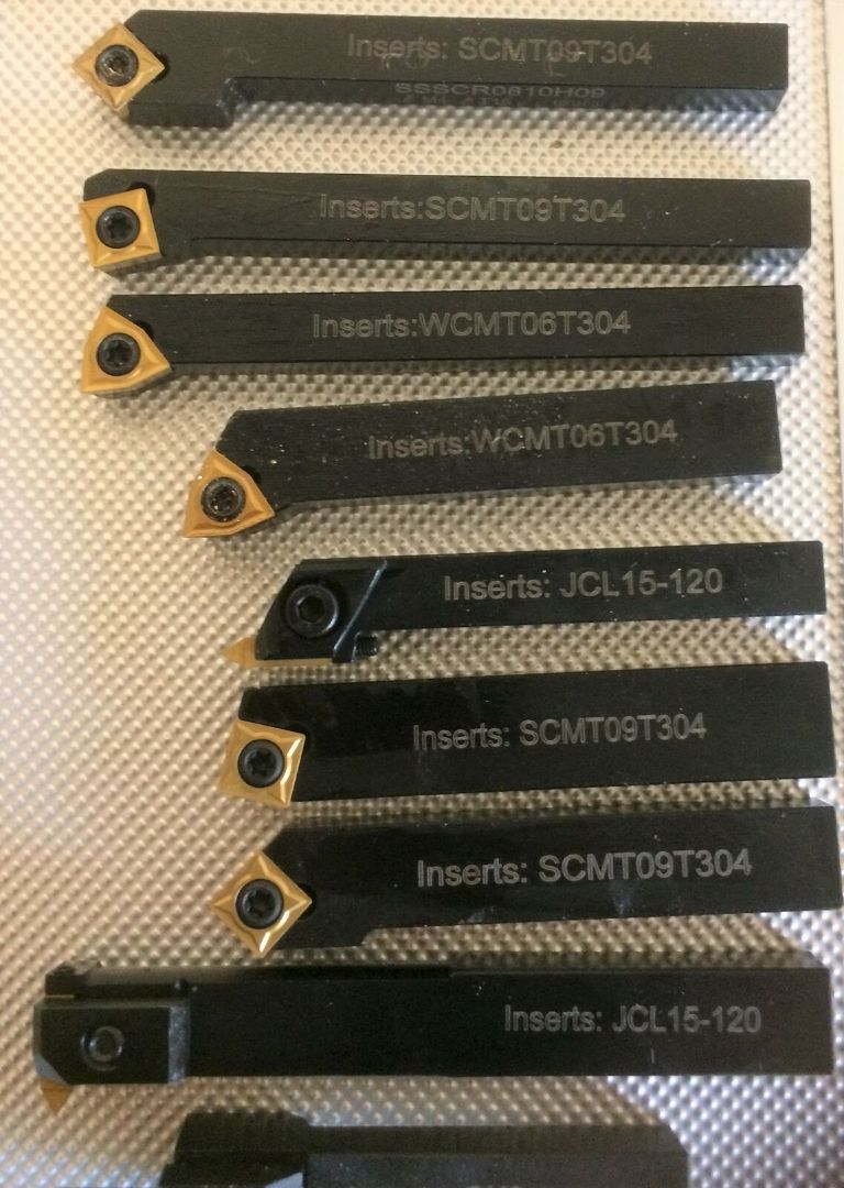

      Hi Just purchased a 9 piece Indexable kit. Unfortunately only being a newbie with my Warco WM180 Lathe ( Last 2 months) I have just been facing and Turning so far. I have not as yet done any boring. So I thought if I bought a kit then at least I would have ALL the right cutters to learn with. So I bought these 10mm cutters.
      I found that 3 of them were 8mm to tip, so I enquired and was told, I quote.
      These are used for internal boring so they would have a bigger clearance, the height of them are 10mm so they are 10mm tools. I am a LITTLE bit inexperienced so would like to know if he is right. I have added a picture showing them. They are the top three.cutters.jpg Any help would be appreciated.
      Thanks

          You don't have any boring tools in that set.
          Look at the side of the holders, you can just see the numbers on the top one in the photo the "08" indicates that the shank is 8mm x 8mm so an 8mm tool which would be about the right size for a WM180 or even 6mm would have done.

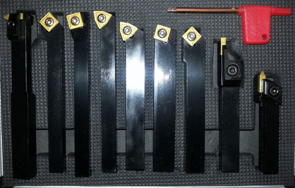

            He said it is a nine piece set. The photo only shows 8 tools, so it would be correct to say there are no boring tools in that photo.
            We need a photo of the missing tool to make a definitive statement about the properties of the set.
            At a pinch, the bottom one, the internal screwcutting tool could be used for boring, but it would be horrible.
            The code on the toolholder is SSSCR0810H09. That means that ONE dimension of the holder is 8mm and the other is 10mm. Compare and contrast the very common SCLCRxxyy tools, where x and y are generally equal.

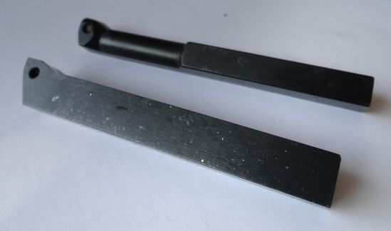

              Still no boring bar in the other photo of the 9 piece set.
              Unless warco are saying the 3 smaller shank ones are boring bars with extra clearance

                I'm guessing the "boring tools" are no's 2,3, & 4. A view from underneath would confirm.

                Me.
                  @me1
                  For what its worth and i'm just a beginner also
                  1 – internal thread
                  2 + 3 internal facing/boring
                  4 – internal up to a shank
                  5 – external facing up to a shank
                  6 – same (not sure why the different angle to the tip)
                  7 – Facing – chamfering
                  8 – parting
                  9 – external threading
                  in all my "3 months of learning" all the boring bars ive seen have been round shanks –
                  I'm sure a more experienced user would shed more light.

                          Addressing the Original Post, which tools are for boring in these sets isn't obvious until the holders are turned over. Rear view shows the top tool shank in the photo has a reduced rounded profile for boring.
                          And the difference is also apparent from the side, where the boring bar insert is tilted & it's support is rounded away underneath:

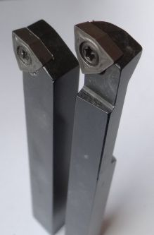

                                              Does anyone have the holder info for the 'W' shaped inserts (WCMT06) I have plenty of these inserts but only one holder that is about 6mm thick and a bit flimsy for my liking.
                                              Rob, are the codes on the side of the WCMT holders you have shown the picture of?
                                              Matt
                                              #526495
                                              Rob Frayne
                                                @robfrayne17758
                                                Matt, The codes I have for the 8mm (WCMT06) is SWUCR0810H06
                                                For the 10mm (WCMT06) is SWGCR1013F06
                                                Rob
