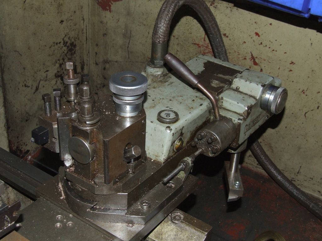

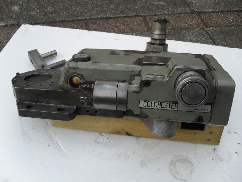

      I'm currently using my hydraulic copy attachment to screwcut tapered threads. I'd like to control diameters a bit more consistently than I've done in the past. On the attachment is a silver knob with indents marked from about a thou to 60 thou. In this picture it's the silver knob above the lettering 'Colchester':
      The manual says it's a micrometer for adjusting the final depth cut. Simplistically I would expect moving it would move the slide slightly thus adjusting the cut depth even with the follower fixed. But it doesn't. So I don't know if it's broken or I don't understand how it works.
      Can anyone offer any insight into it's operation?
      Andrew

          Assuming that I have found the correct patent: The action of item 17 is described
          **LINK**
          https://worldwide.espacenet.com/patent/search?q=pn%3DGB1376623A
          #468110
          David Davies 8
            @daviddavies8
            Gents
            The patent says: the depth of cut is adjustable by moving the fulcrum axis 5 of the lever 4. Does this mean that by changing the fulcrum the setpoint going to the summing junction is reduced so that the travel required to achieve a null position is reduced?

              It is indeed the correct patent. Thanks very much for posting. thumbs up Thanks to the patent I've been able to get the micrometer adjustment working in the way I expect. Tomorrow I'll give it a go when I make another tapered thread plug.
              Note that I said I've got it to work, I'm still not sure how it works. I'll have to sit down and study the patent. The trouble with patents is that they're written in a stylised way such that everything needing to be patented is described but in such a way as to make it difficult for others to understand and implement.

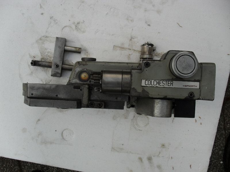

                  Seeing this thread and the pictures reminded me that I've got one of these in the back shed (think mysterious cavern of treasures unexplored for too long). It came my way via the local scrapyard and I planned to fit it to my Harrison 140 but, like so many projects, it never got going, principally because the hydraulic unit was missing. Does anyone have (or can point me to) a manual for the copying unit or let me have a spec for the hydraulic unit – is this something completely specific or could I use an alternative?

                      yes, the tank and pump for the hydraulic oil were missing when I found it. I have a small hydraulic pump that powered an actuator cylinder on a hefty piece of equipment and wondered whether it might be suitable but I have no idea of what the original was. A manual for the whole attachment would also be useful to ensure that nothing else is missing.

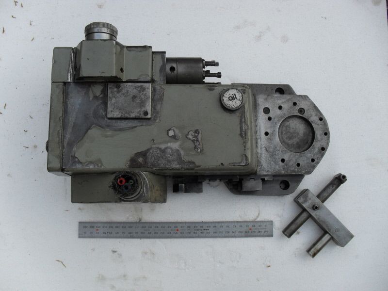

                              Hi Andrew, found the copying attachment in the back shed and after a little bit of cleaning it looks OK. Everything seems to be there and moves freely so it should work OK. The toolpost was put "somewhere safe" which means I can't find it at the moment but it is around. I can't see anything to indicate which model or size it is – the only number on the casting is C19787 which I presume is the serial number. Does this look like your one – in which case your spare hydraulic unit should be suitable if you are happy to part with it. Let me know whether you need any other information to confirm what model it might be. Thanks Sandysdc11178(1).jpgsdc11177(1).jpgsdc11176(1).jpgsdc11175(1).jpgsdc11174(1).jpg

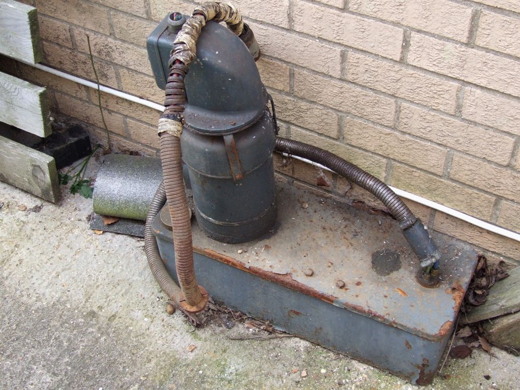

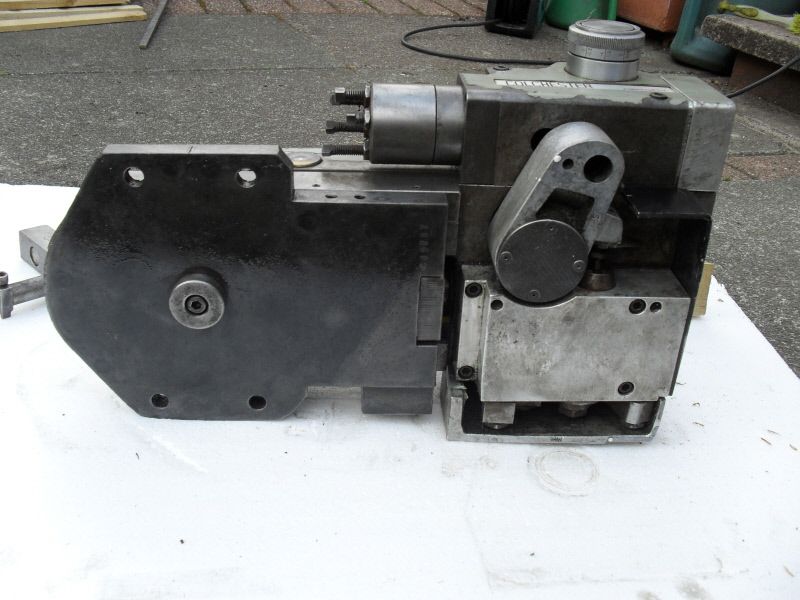

                                This is the pump unit:
                                Looks to be complete, but never used. A possible issue is the motor is 3-phase and looks like it is configured for star only, without digging into the motor.

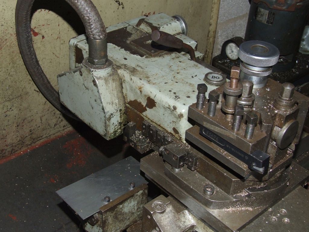

                                Your copy attachment looks almost identical to mine, albeit with some parts missing. Right side of mine:

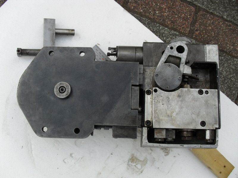

                                The obvious bit missing is the toolpost, although this is a self-contained unit attached by three screws (3/16" BSW I think). So it could be replaced with a home brew toolpost. The bent handle for the indexing stop is missing as is the adjustable stop on the body. But neither of those would be difficult to make. Left side of mine:
                                Looks to be the same as mine, nothing missing. I've never worked out what the coarse adjustment stop on the left side is for. Unless it an "oh s**t" stop that provided a last chance stop if, for instance, the follower misses the pattern.
                                An obvious question is where are you based, I'm near Cambridge.
                                Andrew

                                    As far as I'm aware the indexer handle is just a bent bit of metal with the thread on the end. The ends of the pipes on the spare pump just have small brass unions on them. I've no idea if they're standard fittings. I've never taken mine apart to have a look. The manual shows three hydraulic pipes, and there are three connections at the tank end, but only two appear at the attachment end. The pipes appear to be plastic so shouldn't be too difficult to get replacements. The manual also says the motor is dual voltage, so it may well be, just not with the standard means of swapping.
