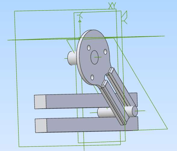

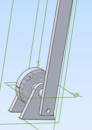

      The upper image is of my vacuum-brake valve now sporting a forked handle that will be engaged by a pin from the existing brake-lever. It also shows three smaller holes that will take screws holding the handle to the rotor.
      The lower represents that link to the main lever, and is purely diagrammatic to help me arrange its operation.
      The inspiration for this form of movement is part of the feed motion on my Drummond hand-shaper.
      In Alibre terms the central pivot at the top is anchored, the two guide-bars are anchored individually but drawn together as one Part. So when moved around they move in unison. I didn’t know they would, with no visible means of mutual support, but was pleased they do – makes things easier to adjust them vertically, with their anchors temporarily off.
      I created the 45º limit plane by experiment. I realised it needed the axis through the top pivot first, but wasn’t sure what else it wanted. That represents the limit of travel – needing verifying but I think it’s less than 90º.
      The pin in the fork, which might be slightly too fat, represents that protruding from the main lever to swing the valve rotor.
      The handle swings nicely on its pivot, but the lever pin stays where it is.
      So… though not strictly necessary, can it made to move with the handle?

        The pin’s movement is significant.
        I later realised the lever pin will of course move in an arc of radius set by its position on the lever, with that pivoted below the valve. The direction will the same but the arc will be convex while the valve fork’s locus is concave. So this will affect the pin’s depth of engagement in the fork.
        That will need more measuring on the truck itself.

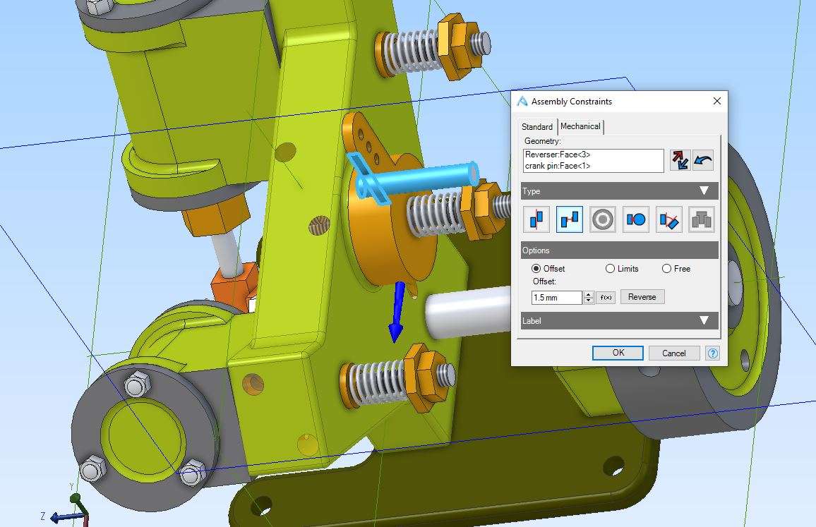

          Assuming you are doing this in an assembly.
          You should only anchor the non moving parts, so in this case it would be the two bars. They can have their fixed position set by using the offset constraint from one of the planes.
          The valve should have one of it’s concentric diameters constrained to one of th emain axis pn the screen so it can rotate about that axis. so with the constraints box open click it’s OD as that is the easierst to click and then click the axis line.
          Lastly the pin. Thi sneeds to slide against two different parts so will need two constraints.
          Again sith constraints open click the outside of the pin and one of the surface sit is to run againts. It will jump to lining up the middl eof teh pin by default so click the offset option and then enter a value that is half the pins diameter which will now move the pin so its edge is in contact with the chosen edge say the valve in this instance.
          slide
          Now do the same offset constraint for one of the bar faces.
          You will also want to constrain the pin so it does not move in and out  so constrain and end to say the back fac eof the rail.
          The pin can now be clicked on with the mouse and holding the button down the pin can be dragged along the rails and the valve will rotate with the
          If you want a full video ask. My constrain screen is a bit different to yours but you should have the same functions

            One option – as per Jason’s suggestion, but use tangent constraint instead of an offset.
            Another option – ‘show reference geometry’ for the forked handle part, it may well have a suitable plane which can be constrained to the axis of the pin.

              Well, I tried it all but not very well, with a very odd result. It took me some time to find some of those controls, too.
              The handle rotates as it should, round its fixed axis. The bars were where I anchored them.
              The pin was floating slightly above the lower bar because I made it slightly thinner, but it cut into the upper bar. I deleted the top bar, leaving the pin slightly above the lower one.
              All my attempts to constrain the pin anywhere sent it turning over on end, or sliding away from other parts.
              However, eventually I managed to find that Reference Geometry tool, and made the pin symmetrical in the fork. I had created it centred on the cross-hairs that appear on the Part screen so it did have diametral planes.
              It now sort of worked in a very odd way.
              Trying to drag the pin along failed. Pulling the fork round bounced the pin up and down the slot in a very strange way.
              So I replaced the top bar… only I was unable to make it symmetrical lengthways with the lower. Ah well, never mind. It just looks peculiar.
              Saved that, closed it, re-opened the assembly.
              It gets worse.
              The bars were out of line vertically, with the upper one inside the fork. Increasingly frustrated with this nonsense, I upped-anchor and slid them with the cursor into a position where they’d not pass through other objects like ghosts in walls. Dropped anchor.
              The fork still pulls round as it should, but passes through the pins. The pin can only move along its axis, not along the bar.
              Trying to constrain the pin to the bar surface or axially now flips the pair of bars onto their sides.

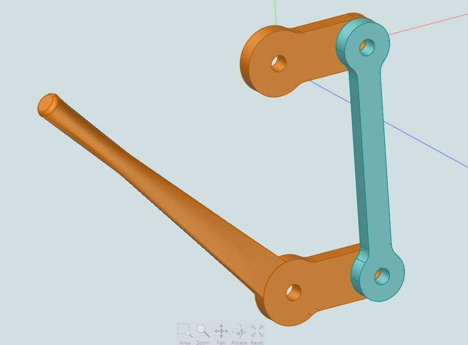

                  If Alibre can animate a rack and pinion, then can you treat this like a single tooth version?

                      I don’t have contraints or assemblies in my CAD, but can do transformations easily enough to approach some kind of simulation of those functions. Maybe Alibre can do that for you for now?
                      Short video below.

                                  Wouldn’t something like this be easier to make and give you more options with regard to mounting and actuation angles?
                                  Martin.

                                    It looks as if the two short links are the same length so the angle the main lever is moved will be repeated by the valve spindle, as the valve’s internal design is intended to take.  The valve does not have to be at the top of the truck, nor at some intermediate height, if the lever is linked directly to it.

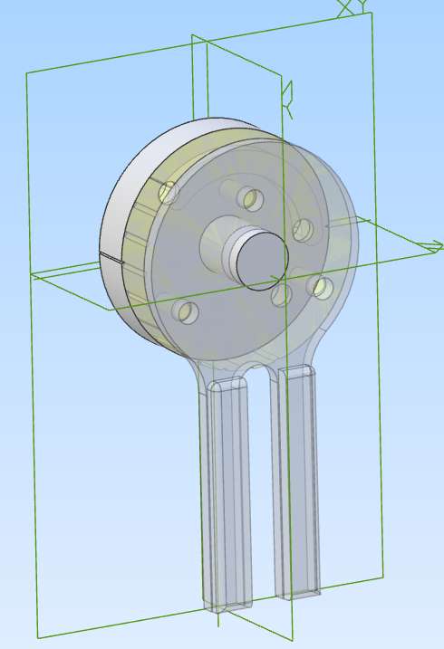

                                    I’ll try to create an image of what I mean by my second option…..
                                    [Goes off and winds up Alibre Atom…]
                                    The Alibre model is diagram rather than actual plan, and it won’t rotate correctly, but at least it’s a start. The small hole at the end of the lever is for the connector for the Bowden cable operating the truck’s own brake.
                                    It’s more elegant, and requires fewer moving parts.
