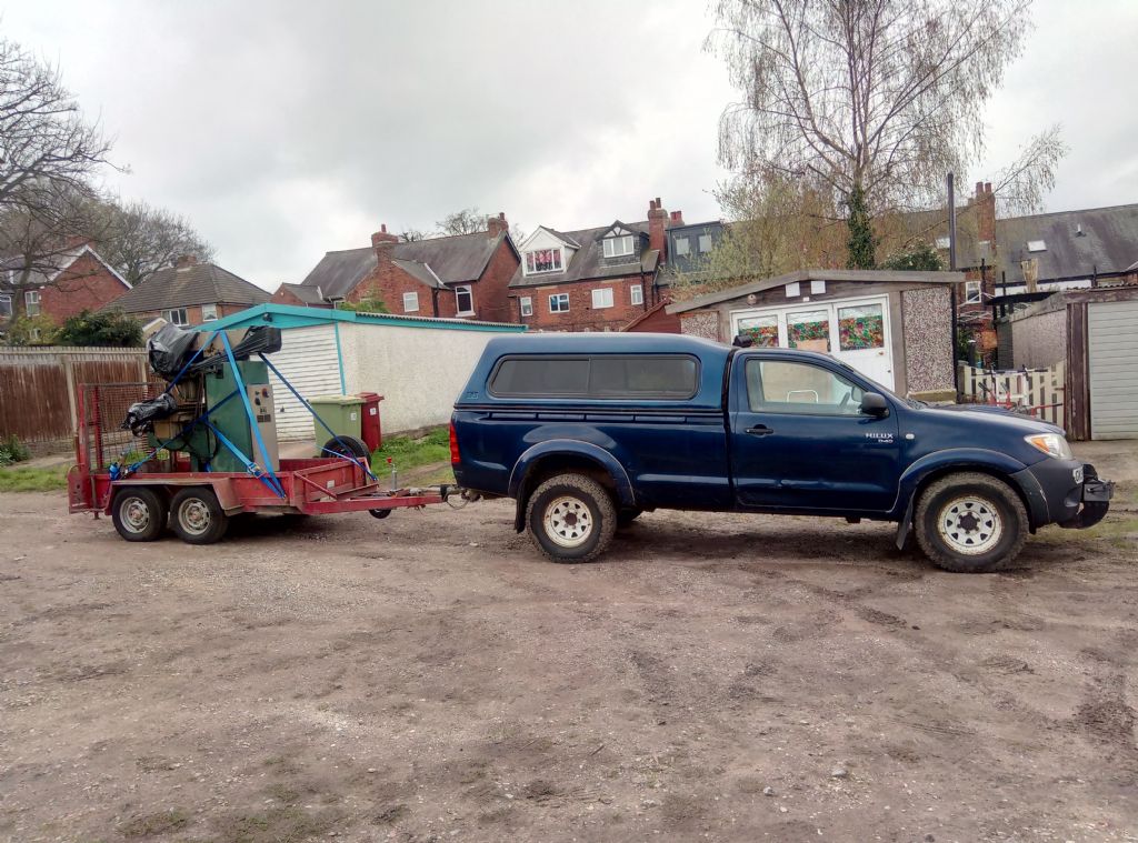

                      I have moved mine twice using a pallet, a pallet jack and a ramp trailer with a winch. It wasn't easy or fun but it got the job done.

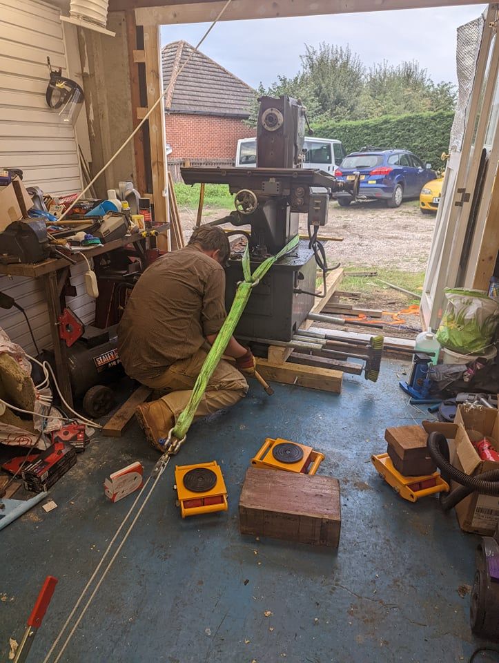

                                    Hiring a suitable 3 or 5 tonne (for the reach/height capacity) collapsible engine crane will actually allow loading into a van in one piece, load the mill through the side door, and use the back door to put the (ideally folded) engine crane in again for the return trip.
                                    Although if there's a big enough area of flat ground at both ends the hire cost of an aluminium lifting gantry isn't that much more than a engine crane and allows you to use a flatbed transit, which is far easier (and probably a bit safer) from a loading/unloading perspective but perhaps not as quick because of the time rigging a de-rigging the gantry.

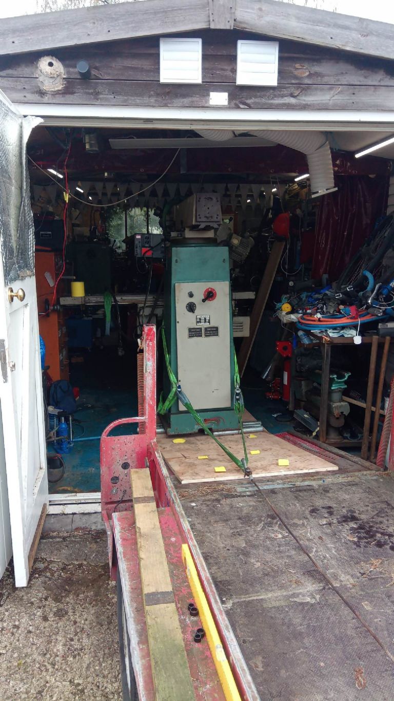

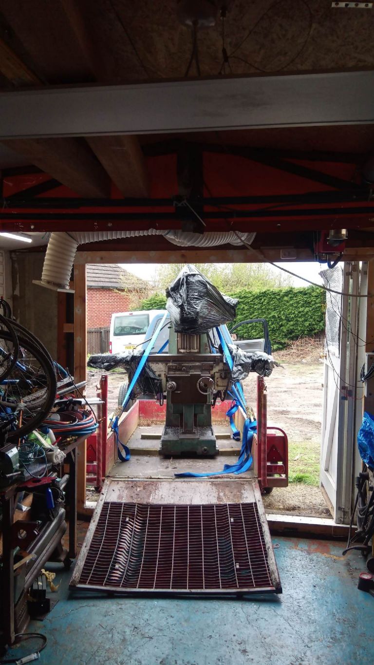

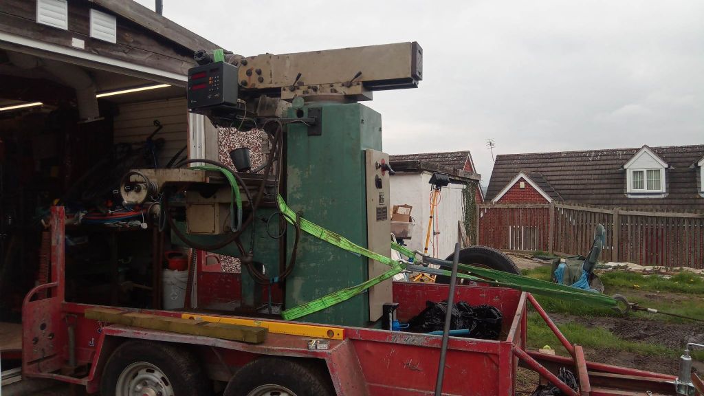

                                    Personally I'm fully sold on putting the machine on skates or rollers and using a plant trailer (so you have a lip-free ramp rated for the full 2 – 3.5T and rear legs) in combination with a winch now.
                                    Took me about 20 mins setup and 10 mins of winching and adjusting rollers to offload my knee mill on my own last month, would have been slower with a Tirfor if I didn't have the winch on my truck, but just as effortless compared to previous moves.

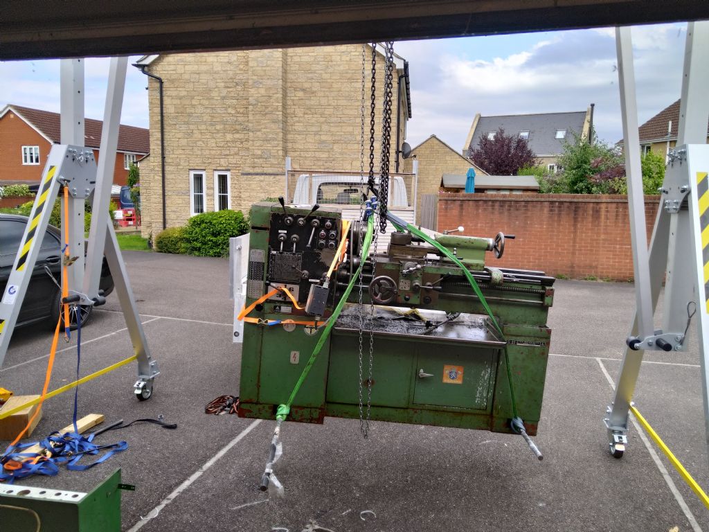

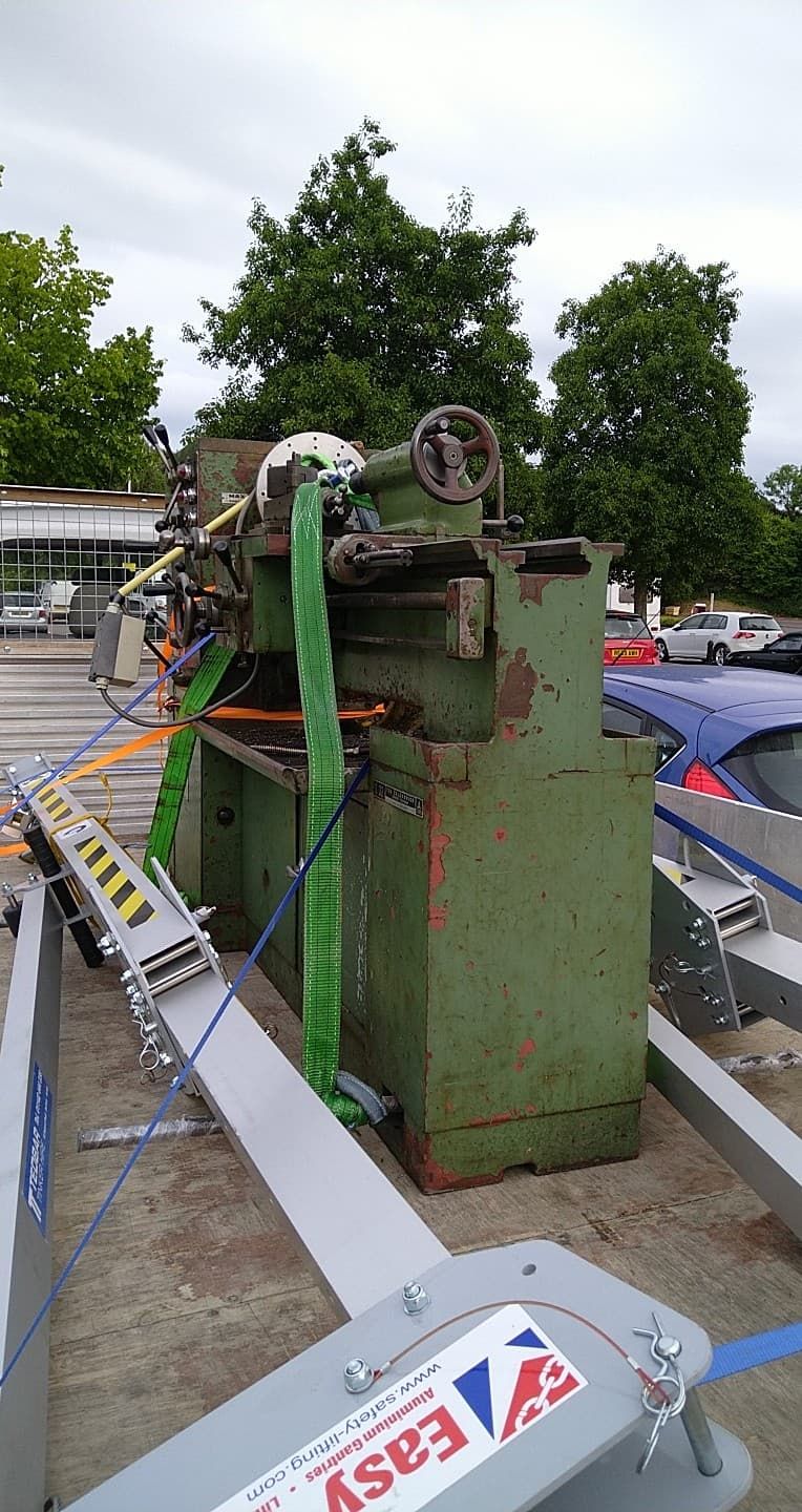

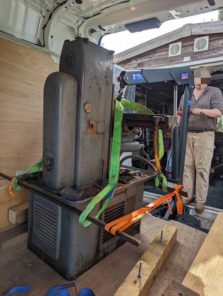

                                      Photographic follow-up.
                                      Engine Crane:
                                      The trick there was getting a low enough attachment point to avoid hitting the van roof in a very small van, wouldn't have been an issue with a high top.
                                      Conversely with a Bridgeport the trick is to get a crane which has enough remaining lift height in the 1 tonne position to get it to clear the van floor, when you're hoisting from the lifting eye on the ram.

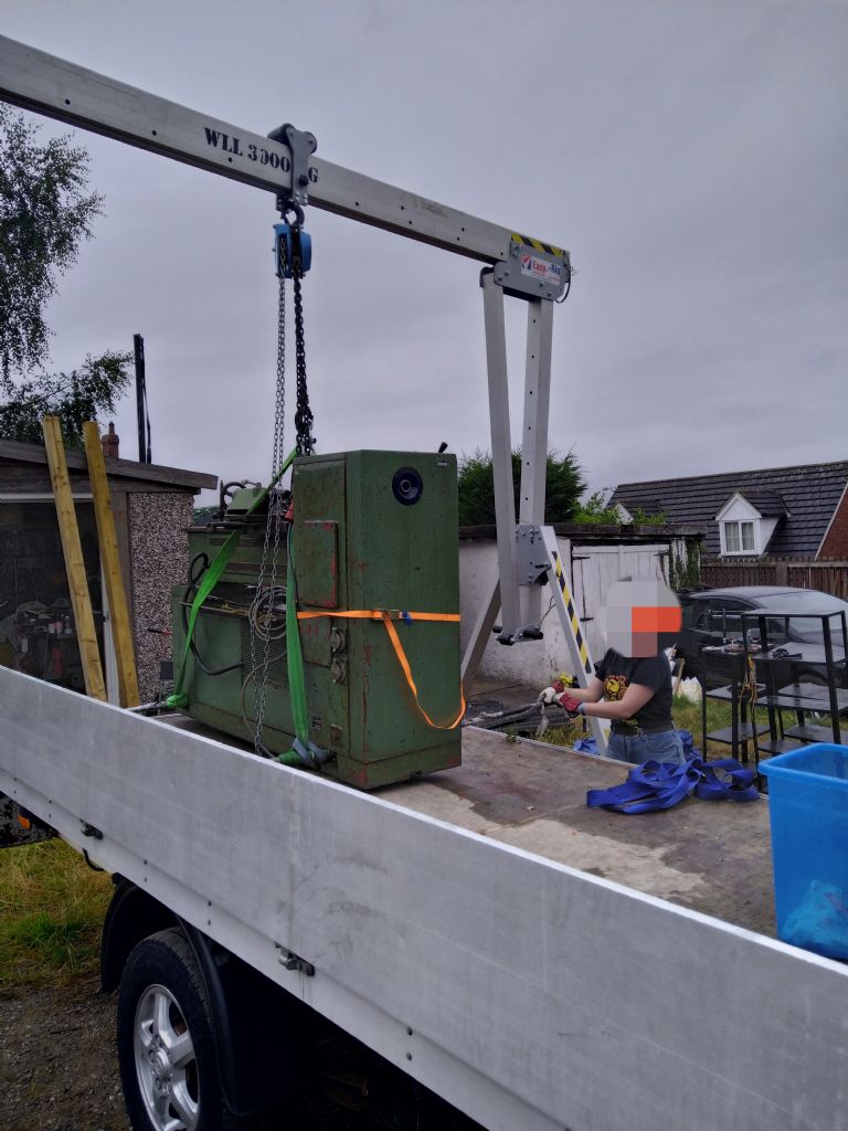

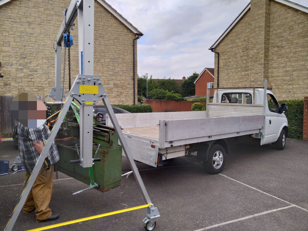

                                      Gantry Hoist:
                                      All together a bit more time and effort to set up, but much more secure lifting even at substantial height.
                                      Would recommend having two people just for the gantry setup if nothing else.

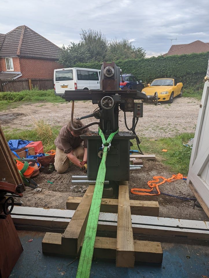

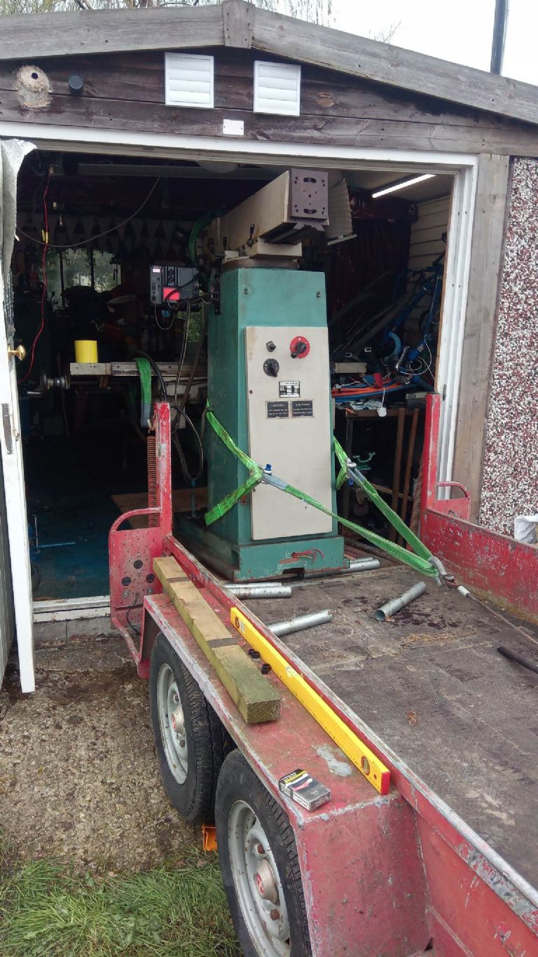

                                      And finally winching:
                                      All very fast and smooth.
                                      Far less effort than previous moves with cranes, despite being the tallest and heaviest of the three (for reference the FNK25 is more than twice the weight of a Bridgeport and about a foot taller).
                                      I don't doubt Steve from Landylift will do a fine job, and if you're not familiar with lifting and rigging it's quite possibly the most sensible option, but it's very do-able as a DIY activity.
                                      I would take full advantage of the opportunity to observe how he does all the other bits that aren't operating the Hiab, because it's all that setup which is where the skill (and danger) is.
                                      Edit: Also, if you can pick them up cheap, machine skates and a toe jack are both godsends to have around if you own heavy machinery.
                                      Second Edit: I would categorically not use a hired 3.5T Luton Van as they lack the correct lashing points and have tail lifts which are wholly inadequate for the weight (although will probably lift it, just bend/droop with it) and are narrow with no toe-boards (essential to stop a pallet truck rolling off the back when the lift inevitably droops under the load).
                                      A dropside with tail-lift is more suitable from a load securing point of view and usually come with larger steel tail-lifts suitable for the load and pallet truck operations, but are much scarcer in the short term rental market.
                                      Third Edit: 5T and 7T Iveco Luton's or Panel vans or a traditional Cabover 7.5T Luton would be an option for someone with a pre '97 licence, because you can normally request one with a 1000kg tail lift without much trouble, but that avenue of pleasure is not open to me without taking my HGV licence.
                                      Edited By Jelly on 12/05/2023 21:31:24

                                              #644979
                                              Jelly
                                                @jelly
                                                Posted by Rooossone on 12/05/2023 22:26:54:
                                                Posted by Fulmen on 12/05/2023 21:18:31:
                                                Well done indeed. This is why small machines fetch such a premium.
                                                This is a valuable lesson I have learned today.
                                                I will be enlisting the help of Steve for the transport but once at my workshop, I will be using an engine crane to move it into my workshop and into position, I will need to basically replicate what you did with your mill. Thank you for sharing the pictures of your moving techniques. It has given me some more confidence that what I am doing is viable.
                                                I will also rely on the advice of Steve as he clearly sounds like he knows what he is doing. We will probably make a plan before anything is even moved based on what needs to be done at the destination.
                                                It can be daunting the first time you do it, but if you think through everything that could possibly go wrong and figure out how to eliminate each potential issue, it will go smoothly when you do it.
                                                If you have a lingering doubt about something, don't start until you've figured out why and either gone through it enough to be sure it's not an issue, or found an alternative approach.
                                                If you're planning to hoist it up a tiny bit and wheel it on the crane, then sweep, sweep, and sweep again.
                                                With that kind of weight on them even little bits of grit can cause the castors to bind up awkwardly, if you have a rough floor finish, consider getting a couple of sheets of hardboard or ply to run on.
                                                Also be aware of any slight slopes, even a slight uphill that's not immediately obvious will be appreciably harder to push nearly a tonne of cast iron up, and anything obviously sloping underfoot could pose a risk of rolling back.
                                                If you're dealing with a slope that has a risk of roll-bacl, then Toolstation sell an inexpensive 2T ratcheting come-along, which can be anchored to the ground with a piece of angle iron and two concrete screws, I have a photos somewhere of me pulling my lathe Harrison mill up a 15°-20° incline on rollers and skates with one.
                                                Needless to say, pull on a central point as low down as possible (and on the crane not the machine) for stability.
                                                Edit: Photos.
                                                It was not ideal or comfortable to have that much extra height under it, but given the available options was far more secure that way as compared to using a thinner less stiff ramp would have been
                                                In any case the come-along allowed me to be well outside of the danger zone whenever the machine was being moved and assess its stability before approaching to add rollers or position the skates for the transition off the ramp.
                                                The positive of wheeling it with an engine crane is that as long as the centre of mass is inside the legs, it will be much more stable than trying to push/pull it on skates/rollers.
                                                Do be aware that when moving a hoisted load like that, if it does tip forward, whilst the machine stands a much better chance of not falling over, the crane could be kicked out backwards and upwards.
                                                You can minimise the risk of that by lifting the load as little as possible to minimise the potential energy involved, and not standing directly behind the crane when you move it if you do have to lift it higher for some reason.
                                                Edited By Jelly on 12/05/2023 23:47:59
