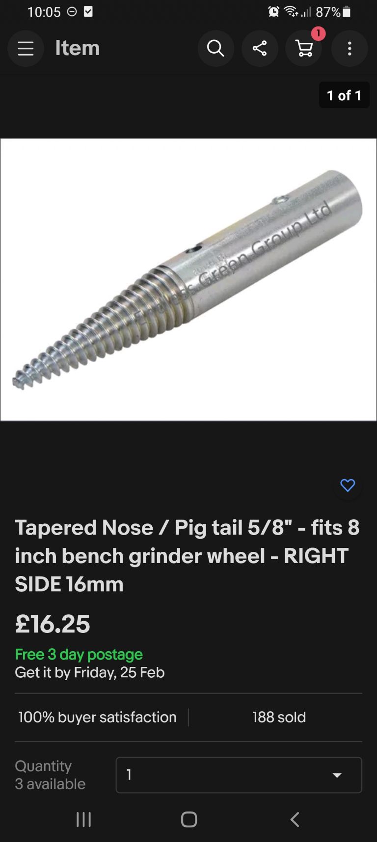

      I'm looking to convert and old freestanding pedestal grinder into a buffing machine. Would it be possible to make one of these shafts on my manual lathe. Is if possible to cut a tapered thread?

          I wouldn't bother making one, they're readily available and not very expensive. Don't forget that right-hand ones have a left-handed thread. **LINK**

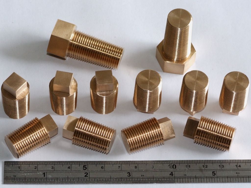

                                The OP really needs one of these…… teeth 2
                                ….set up to screwcut RH 19tpi BSPT threads:
                                the resultant 3/8" BSPT blowdown plugs, and a couple of embryo fusible plugs:
                                Andrew

                                    Offsetting the tailstock might not be able to produce a steep enough taper, these adaptors are cheap as chips on ebay.

                                          Drill and tapped one for a friend recently. I would not bother to try and make one, even though I have a taper turning attachment. At about £10 from the polishing shop I seem to think. It is vital that it is true to the axis of the machine it is being used on ! If you have a screw on chuck be careful running a lathe in reverse. Noel.
