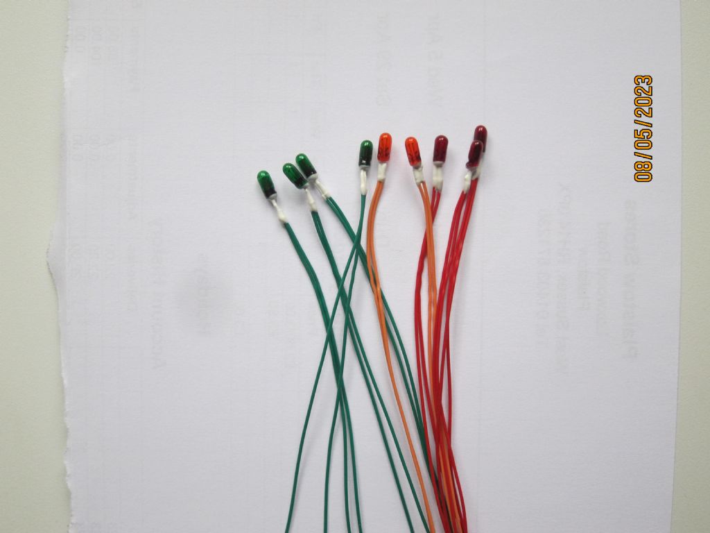

      Hi –These 3mm diameter LED indicators were picked up at an ME exhibition some years ago sold for use in model railway signalling applications. Only problem is that I am not sure now of the operating voltage (?12V) and whether or not they have an built-in series resistor. Short of trial and error what is the recommended method to establish their operating voltage?

          Try first with an AA cell and if nothing happens both ways round, then two in series. If that still does not work, you could try with bridging your car battery.

              Don't try with just a battery. Put a 330 ohm resistor in line too. Then try the other way round unless there is something to tell you the polarity. Then if no joy increase voltage but don't remove the resistor until you are sure it has one of its own.

                  They look like a wire ended lamp to me, how sure are you that they are LEDs?

                    Looking at what you show, I am not convinced that these are LEDs. Here are my clues:
                    The filament is almost clearly visible;
                    The outside layer (glass or plastic?) looks like glass, and is strongly coloured. With LEDs the colour is produced within the diode itself, and does not work by having a white light and strong colour covering.
                    And Mike Poole seems to have come to the same verdict … Sorry

                      Not sure that they are LEDs, it is just my assumption. No obvious sign of any 'bump' in the leads either,indicating a series resistor, just a slight mismatch which I take to be the soldered joint between lamp and their connecting leads. Have not considered the possibility of them being wire ended lamps.

                        Further close inspection with a magnifying glass seems to confirm that they are in fact filament bulbs which I had not appreciated existed in this size. Question still applies of course as to the operating voltage but perhaps it does suggest that the original understanding of them being a 12v device might be correct.

                          Before I read the other posts I'd identified them as filamen lamps. You can see the filament supports.
                          Ideally put them on a variable supply and bring the voltage up slowly until reasonable brightness is acheived. Probably 6 or 12V.
                          if you only havea 12V supply connect two lamps in series and try that first. Saves blowing them up if they are 6V.

                            They are probably 'grain of wheat' bulbs, surprisingly tiny filament bulbs. I used to buy them for physics and electronics projects when I was a school technician. Since LEDs became ubiquitous, they are rather expensive.

                              Go carefully! Many such lamps were 5 volts, and these appear to have the appropriate short filaments for that. Other common voltages were 12 volts and 28 volts, but the latter had an obviously long filament.

                                  To be sure what they are a simple test with a multimeter would give equal resistance each way round with filament bulbe and different readings with a diode.
