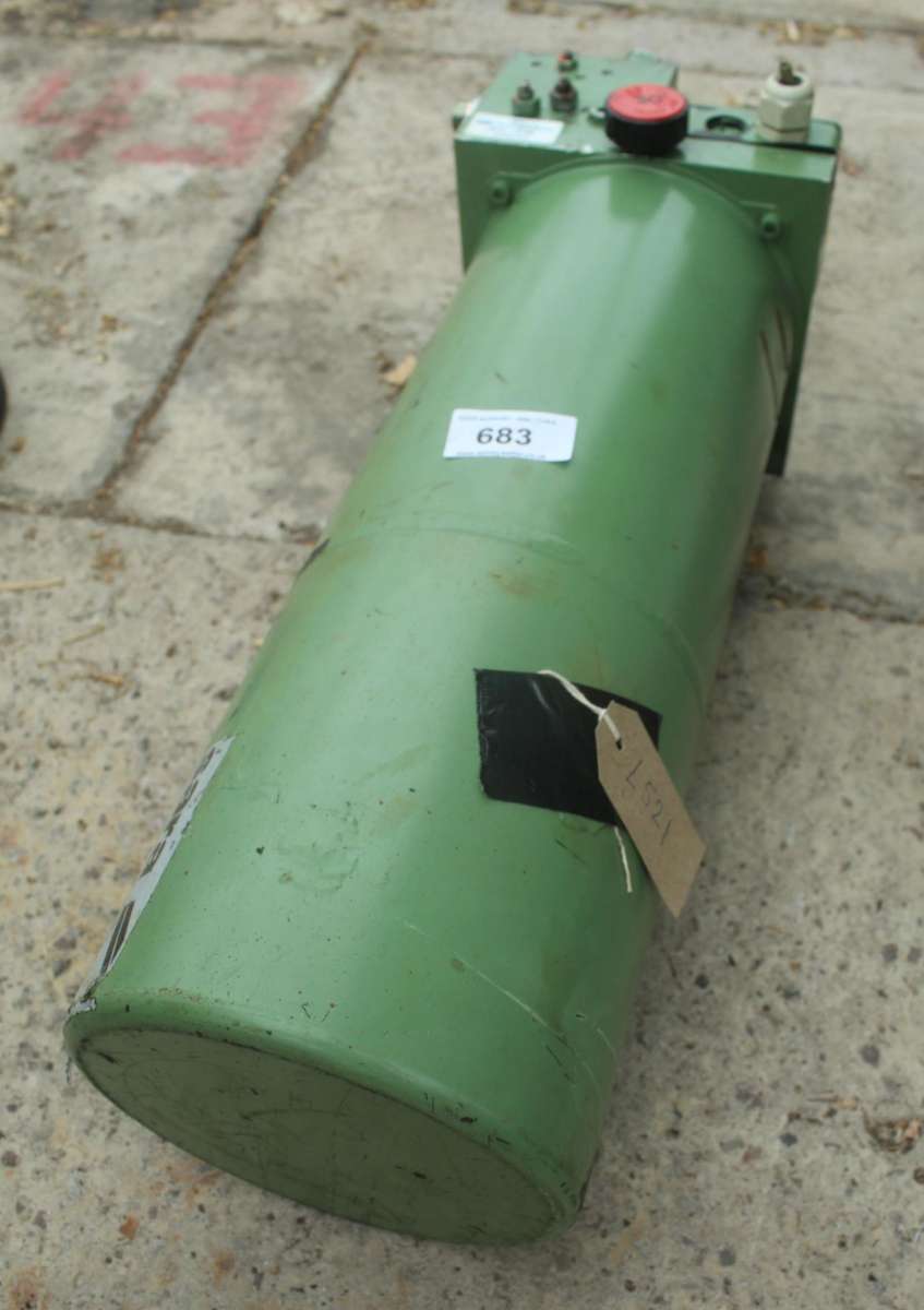

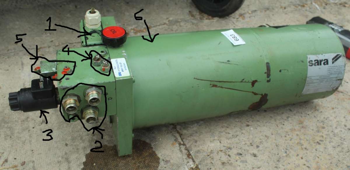

      OK. So I have just bought this hydraulic powerpack out of sheer curiousity at auction. Could someone please tell me if I could use it to power a hydraulic cylinder for a press?
      Also what are the things numbered 1 to 6, and what do they do please?
      Is there anything missing that I need to get it working? Thanks.
      ppack2
      #812110
      noel shelley
        @noelshelley55608
        Right ! I see no sign of a motor ? 6 is the reservoir. 1 is the filler cap. 2 look for letters A and B they should be the tappings for flow and return on A and B, they are metric fittings. 3 is a control solenoid, the coil will tell you what voltage, anything from 12V up. 5 the nut may be a relief or limit valve and there are other settings with security paint. 4, don’t know. A picture of the data plate on the right may help.
        If there is no motor then it will power nothing. A picture of the other side would be helpful near the white cable gland. Good luck. Noel.

          Sure it’s not an accumulator?
          #812121
          noel shelley
            @noelshelley55608
            Petty certain ! The reservoir is a thin pressing sealed with an O ring and held on with 4 small screws. Noel.

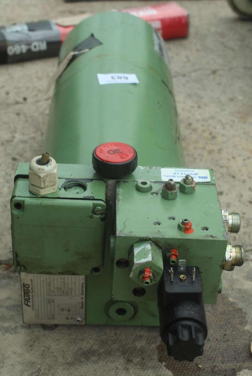

                  @ell81
                  ppack3ppack1
                  #812167
                  DC31k
                    @dc31k

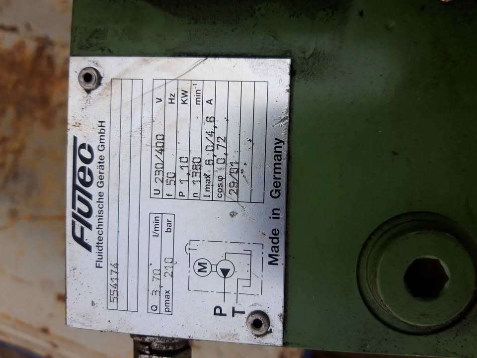

                    There are two data plates on the item.
                    As yet, they are illegible. If you want help, please have the courtesy to provide clear photographs. Check the photo before you upload it. If you cannot read the numbers, nor can we.
                    Ten minutes spent putting those numbers into a search engine will be a more productive use of your time than multiple blurred images here.
                    Some consideration of the scope of the auction would also narrow down the field. If it the asset disposal of a specific company, the company name helps. If it is (for example) an agricultural-themed auction, the oilfield application suggested above might not be appropriate
                    #812168
                    Robert Atkinson 2
                      @robertatkinson2
                      As noted detail of the data plates would be useful. However it looks like a reservoir and valve block rather than an integrated power pack. There is no visible motor or pump. They could be under the cover but that is not a common arrangement. The cover looks like a thin pressing held with 4 caphead screws.
                      I’d drain it and remove the cover.

                        #812182
                        Nicholas Farr
                          @nicholasfarr14254

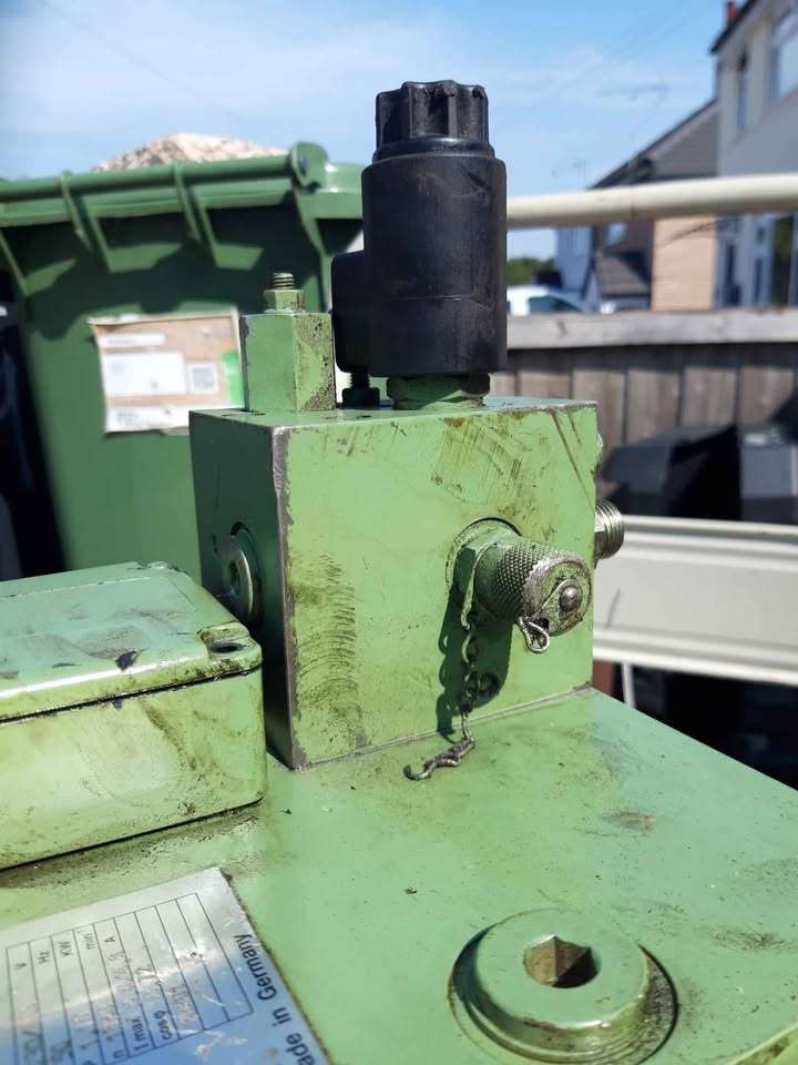

                          Hi ell81, it doesn’t look like any power pack I’ve ever seen for a hydraulic press ram. The black part arrowed 3 is a solenoid, which might control an internal valve, and those nuts with the red paint on are most likely some type of flow pre-sets.
                          It was probably replace by a new unit on a dedicated machine, when it reached the recommended maximum number of hours of use.
                          Regards Nick.
                          #812183
                          Richard Simpson
                            @richardsimpson88330
                            Just to add a couple of thoughts to the pool that might help.  I think the most useful picture is the first of the two just above.  In that it is plain to see that you have an electrical box on the left and a valve block on the right.  On the valve block you have a solenoid valve that almost certainly operates a shuttle valve inside the valve block.  This is more likely to be directing flow via the high pressure connectors on the right hand side.
                            It is also worth noting that the orange knob appears to say HP Filter on it, which would indicate that an oil filter is fitted behind it.  Possibly to protect the solenoid valve.  Also of note is the fact that there are four adjusting screws on the valve block which are locked with a lock nut and marked with orange paint as anti interference indicators.  This tends to make me think that whatever valve arrangement there is in this block is a fairly complicated set up and adjusting those four screws would be pointless without instructions.
                            Firstly this is most definitely not something that generates hydraulic power.  It is an oil accumulator, or reservoir, with a solenoid valve arrangement mounted on top designed to direct flow, possibly to either side of a hydraulic ram or rotating hydraulic motor etc.  If you want to know more about it, as has been mentioned better pictures of the labels would be a great help and it might be worth taking the lid off the electrical terminal box to see if there are any clues there.  My guess, and its only a guess, is that one of the high pressure connections on the right is high pressure oil into the block and the other two connections are high pressure oil out to either side of a hydraulic ram.  The reason the block is so complicated is that, when oil is supplied in one direction, it must be returned via the other side to the accumulator.  If you refer to the following diagram you can see that the valve block, mounted on the reservoir is only a part of the total system. I suspect that the return line is internal.
                            How it Works Hydraulics1170x658
                            This unit, I’m afraid, is of little value without the other components of the hydraulic system.

                                #812200
                                David Jupp
                                  @davidjupp51506

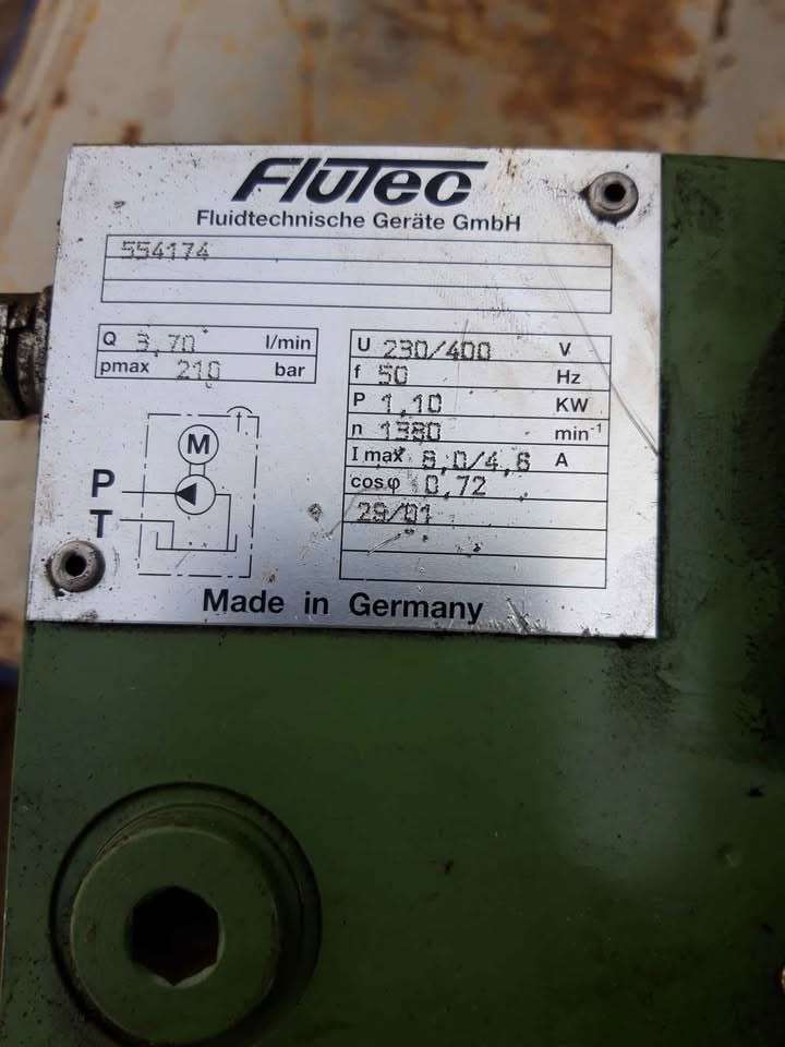

                                  The Flutec data plate seems to show a motor/pump – a clearer image of that plate may help.
                                  The solenoid coil is for 24 volt DC operation, so this could be from a mobile system.  It does bear some resemblance to power packs found on small tipper trucks, though they often have an obvious fluid reservoir which I don’t see on this one.
                                  The 3 ports for hydraulic connection have got me stumped.
                                  #812212
                                  noel shelley
                                    @noelshelley55608
                                    Of the many types of very clever hydraulic valves out there The block with the solenoid + tappings on the right and numerous locked settings puts me in the mind it is an over centre valve. Think skip truck where the load is lifted by the arms, when the arms are vertical there is no load on the hydraulics, at this point the valve flips ports so that the load can now be lowered to the bed of the truck. This type of valve has many applications, but using it to operate a press ram is not one of them. Whilst you could use a double acting cylinder as opposed to a single acting spring return type it then needs for the cylinder to be powered in both down and back up. This is fine if power operated but tiresome if hand pumped. A common pressure for ordinary hydraulics is 2000 to 2500 psi whilst for presses of the type we use is 10,000psi, then there is piston area and flow. A ram that only has it’s piston rod in tension will be much thinner than one where it is in compression ( a press ). Whilst it would be interesting to know what it is I don’t think it will be much help in building a press.
                                    If building ANYTHING hydraulically powered NEVER operate without a system relief valve.  Noel.

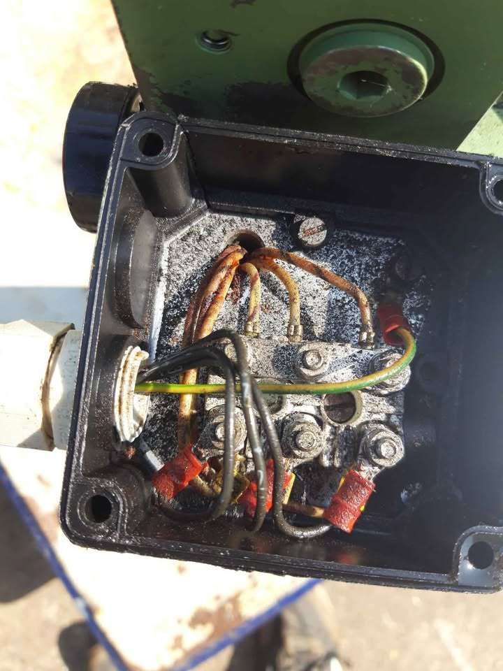

                                        @ell81

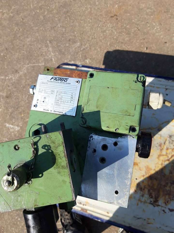

                                        More pics:
                                        sara1
                                        sara3sara4sara5sara6sara2
                                        #812312
                                        noel shelley
                                          @noelshelley55608
                                          Don’t see any pictures, but I have a similar unit with a 2Hp electric motor where the solenoid is. There will be little point in taking the reservoir off as it’s full of oil I suspect, unless the wiring gives a clue.
                                          2 screws missing, the wiring cut off and the plug for the solenoid missing, I think it could be a dead end ?
                                          The orange cap may be an air filter as when operating the fluid level will rise or drop as a cylinder works due to the volume of the piston rod and to draw dust in the air in is not good. Dave spotted the weld seam on the reservoir I wonder if there is a motor inside, though the cut wiring is not big enough for a 24v motor of any size. Interesting. Noel.

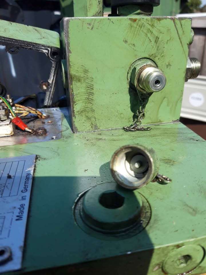

                                          #812315
                                          Nicholas Farr
                                            @nicholasfarr14254
                                            Hi. it could just be a pump inside the cylinder, with one of the three ports on the side being supplied with oil, and the other two connected to a machine, with the black solenoid reversing the direction. Just a thought.
                                            Regards Nick.
                                            #812349
                                            noel shelley
                                              @noelshelley55608
                                              It could be driving a hydraulic motor in which case it could have 3 ports, flow, return and case drain. Noel.
                                              #812519
                                              Nicholas Farr
                                                @nicholasfarr14254
                                                Hi, from ell81’s photos, it looks like there maybe a pump inside.
                                                hydrualic power pack
                                                Regards Nick.
                                                #812543
                                                  SaraLBS specialise in Loading Bay Systems – doors, lifts, ramps, levellers etc.

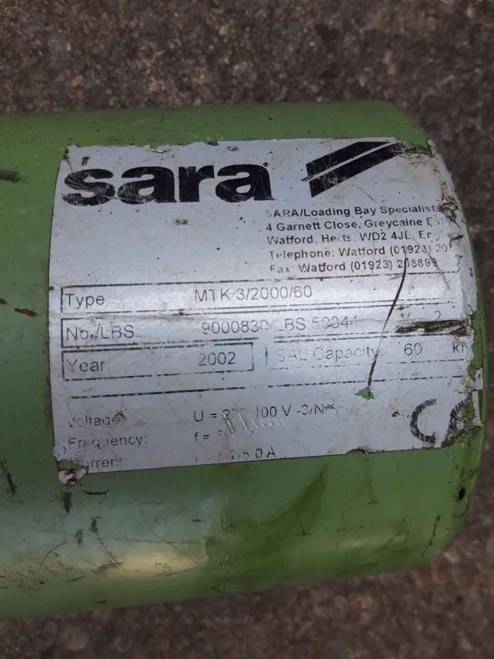

                                                  Judging by the labels, ell81 was right –  this is a power unit.  It’s a 1.1kW hydraulic pump with a 3-phase electric motor.  Max pressure 210 Bar, a bit over 3000psi, and the unit is designed to produce a force of 60kN (about 6 tons force).
                                                  Kurtis at CEE (recommended viewing) uses his hydraulic press as vice to hold the monster parts he moves about his workshop with a forklift or crane.  This unit could drive something like that, though the size and weight of the frame needed is intimidating!
                                                  #812557
                                                  noel shelley
                                                    @noelshelley55608
                                                    Now we have the pictures all is revealed ! Dave has it. 3 Ph 1.1Kw, 3.7 L flow at 210 bar. P is the outlet T is tank/return. The port with the screw cap is a test point. What letters are on the face with the hydraulic tappings ? The single solenoid may indicate single acting.  It will not have enough pressure to be used instead of a hand pump on a press. If you have 3 Phase and want to build/adapt a press then you need a cylinder with a PISTON diameter of 3″ or more and a stroke to suit the job with a stout piston rod.  The Flutec pack has a valve block added which could be any thing is there a plate on it ? You have removed the valve block the 2 small ports are your P and T and depending what you are going to use it for will dictate what valve block you use. An adaptor plate to give P and T as 1/4″ BSP and then an open centre double acting spool valve with system relief valve, plus a ram to do what you want and your in business. Or go the whole hog and use a solenoid valve of the same type and now you have remote control. Have fun. Noel.
