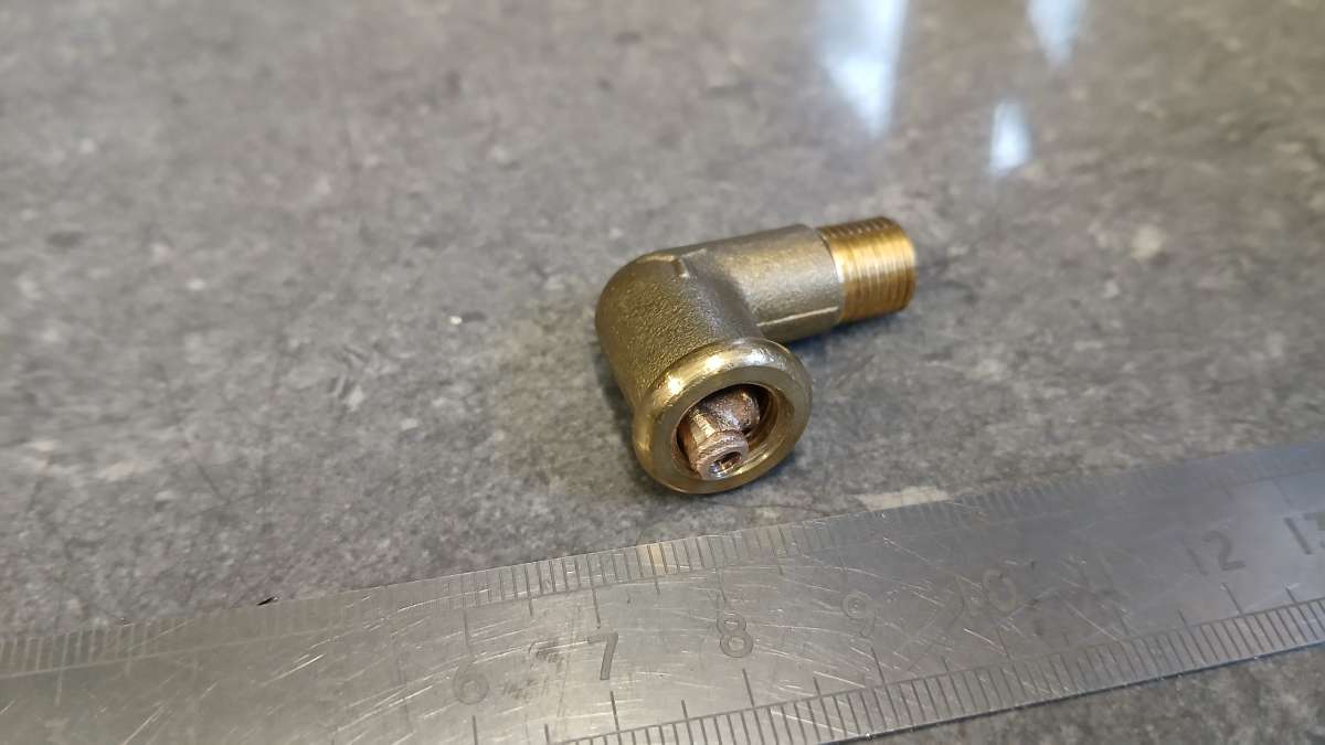

          #829375

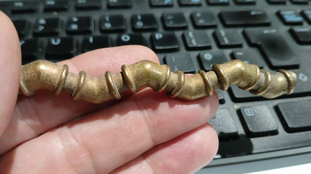

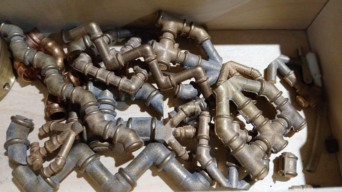

            Definately cast as I have quite a few to look at closely.
            EDIT and just to be sure, they list them as cast bronze on their website
            20251219_153913
            There have been a few posts on some of the US forums over the years about how people machine their’s and I imagine PMR do similar. Usually a block that is split down the middle that is carved out to hold the casting like nesting jaws. You then have edges to set against a stop so drilling and machine tapping is quick and easy.
            Also need drilling as you need the hole through the fitting and the holes need tapping. The “street Elbows” are cast quite close to size on the externally threded end so would not need turning

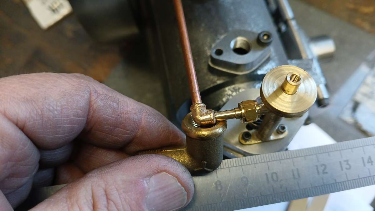

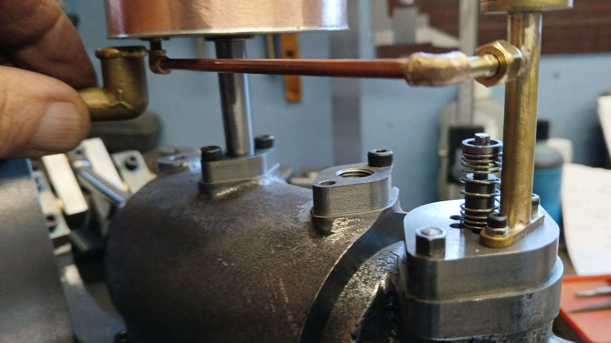

            Some in use

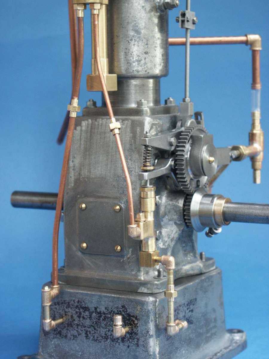

                Far more prototypical too, where the original engines would have used screwed steel or iron pipe.
                Note the correct in-line patterns on the nearest pipes. The full size versions use nipples that screw onto both pipes, and the flange on one is threaded to take the nut.
                I think the nut in larger sizes is occasionally octagonal rather than hexagonal, although at cost of load-bearing area for the spanner.

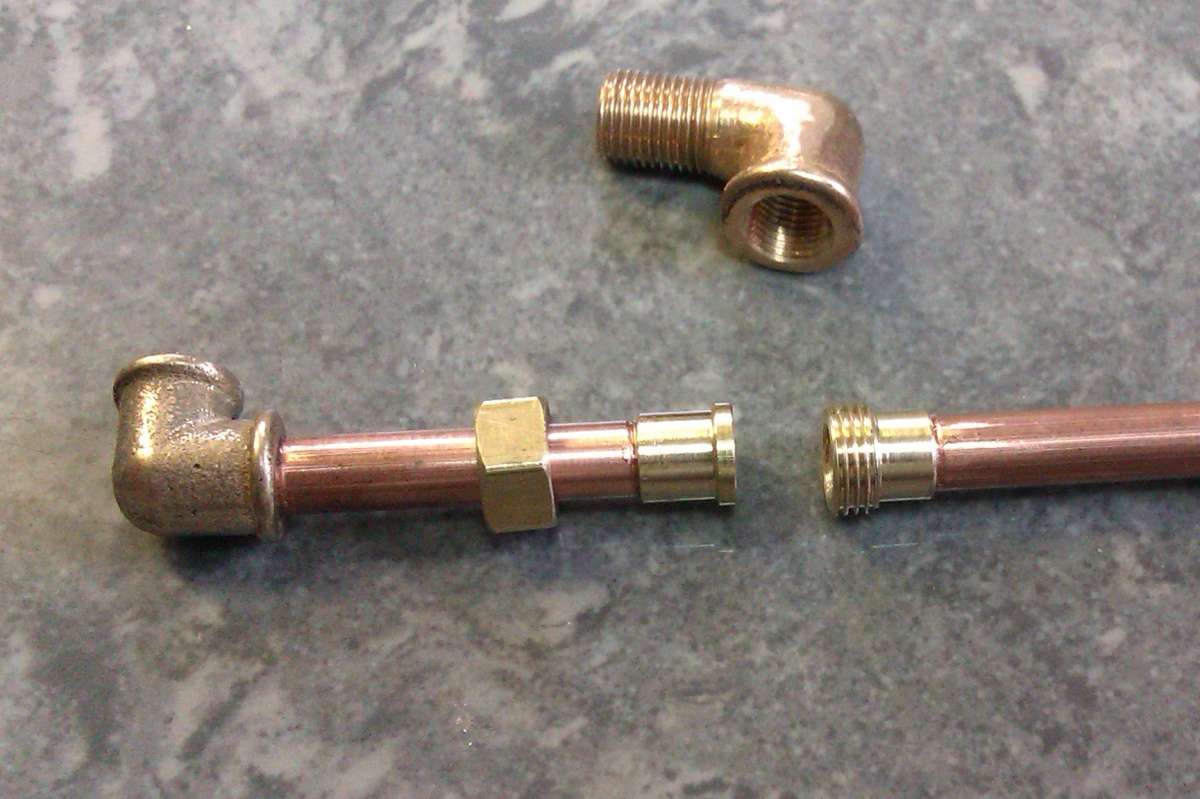

                  That’s it flanged ends on those unions. They don’t make the unions I had to do those from brass stock.This is on 5/32″ pipe, the ones above are 3/32″ on the feed (right) and 1/8″ on the return (left). As you say the bigger they get the more flats to the nut. You can also see an externally threaded street elbow.

                      As they go the finish is average for a casting. A good molder with the right sand can get a much better finish than those shown. If their cored then there isn’t much to drill out before threading. Noel.
                      #829420
                        Not cored probably because they might be a bit fragile as they would need to be about 2.5mm diameter.
                        Finish is actually quite good, these are the larger 1/4″ size.

                          #829451
                            Yes they are all threaded just like the full size.
                            I wonder if some of those posting here have ever used these pipe fittings? The comments about core sand not needing to drill suggest not. These are MODEL pipe fittings and intended for use with MODEL pipe threads. So unlike the full size which are sized according to the ID of the pipe and use NPT and BSP threads. These model fittings are sized to the OUTSIDE DIAMETER of the pipe.
                            Therefore an 1/8″ fitting is drilled 2 to 2.5mm so you don’t break out the corner. Then counter drilled 2.7 and then tapped either 1/8 x 40 or 5BA.

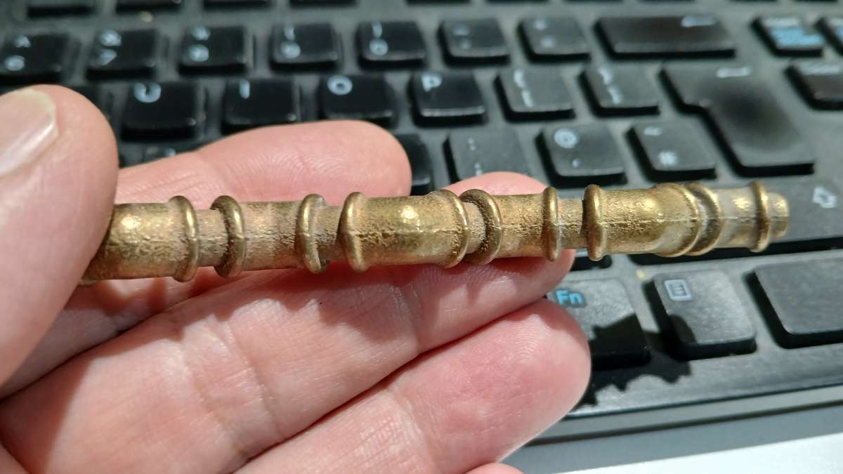

                                Yes Jason, your right, A, I have never used these fittings, and B, I had lost sight of just how small they are. To core them would be difficult and rather pointless. Very neat and they really look the part in use, though a little heavy. Admittedly of slightly larger size one can get endfed copper fittings from 6mm/ 1/4″ od, 8mm and 10mm that look OK, are easy to use and are about £1 each. These are fine for some applications on 5″ or 7.25″ models. Noel.

                                    #829557

                                        @noelshelley55608
                                        From what Jason has shown they would appear to be supplied in a stick, un drilled or threaded ? Were I to still be running the foundry I would seriously consider making up patterns and casting these, it would be a simple job and worthwhile.  Noel.

                                            Very good! Thank you for these, Jason.
                                            You rlast photo, of the model one nestling inside the full-size equivalent, puts them in perspective!.
