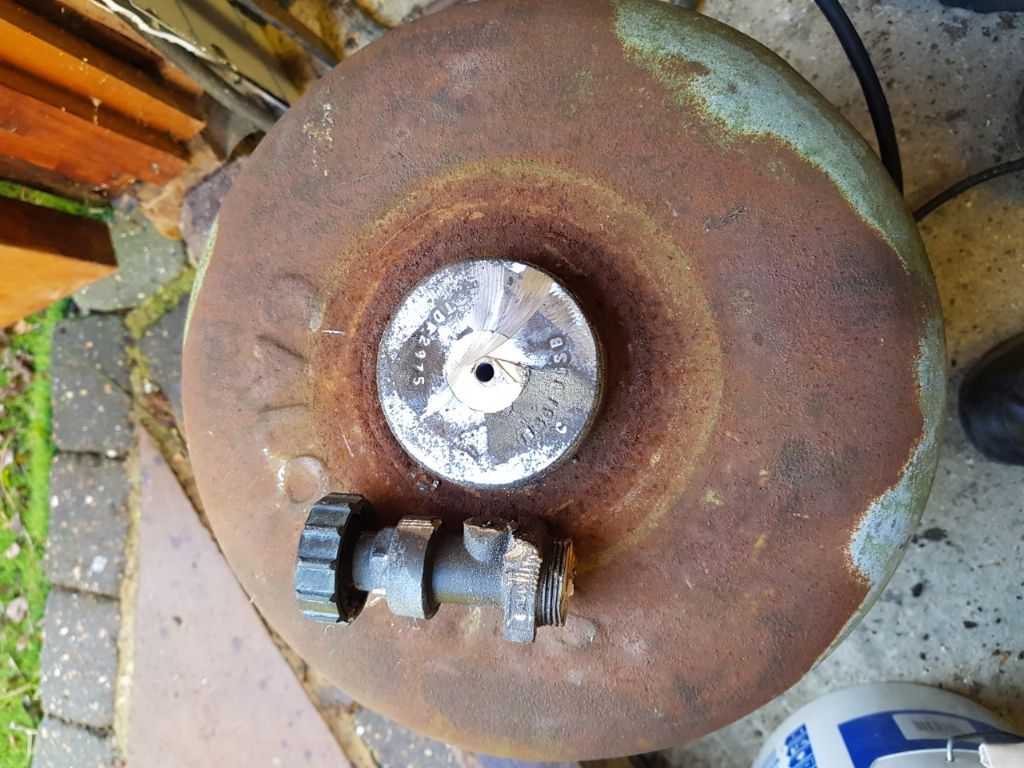

                                  #517291
                                  Derek cottiss
                                    @derekcottiss41883
                                    #517292
                                    Derek cottiss
                                      @derekcottiss41883
                                      So after having this bottle for over 20 years , Calor didnt want it back the valve put up a serious fight until the cutting wheel on the angle grinder came out that is . Current thought is to cut the top off (creating a lid ) and remove the centre section to create a flue . Any thoughts ?
                                      #517498
                                      Bazyle
                                        @bazyle
                                        What diameter is it? Mike's in the link earlier is 12in dia.
                                        Mike seems to use portland cement as the key binder. I have seen a comment elsewhere that that is less optimum as it decomposes at a relatively low temperature (perhaps wrt cast iron not AL) on the other hand I've seen a recommendation for plaster of paris which in theory is definately low temp yet that caster used it for several years for AL. Then I see 'castable refactory' cement advertised intended for differnet temperatures (and cost) from 1300C to 1700C.
                                        Lots of choices; lots of different youtube videos.
                                        #518413
                                        Derek cottiss
                                          @derekcottiss41883
                                          Interesting hour on the phone with Noel last night , more questions to think about i think .
                                          Yes it is 12 inch diameter im thinking maybe ceramic blanket but not sure if this needs a 'hardener '
                                          more research i guess
