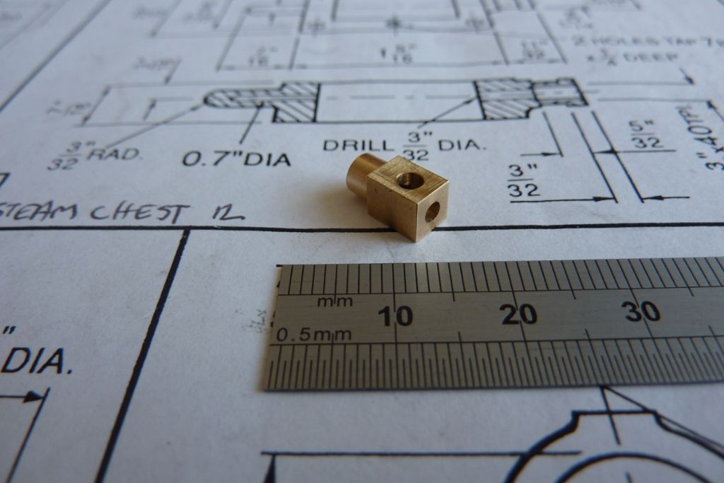

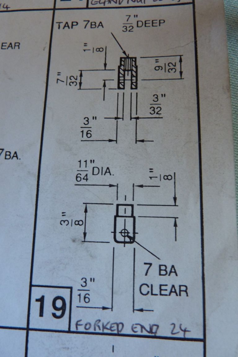

        Hi,
        The photo below is a part-made forked end for the S50 I'm building. I need to cut the slot for the eccentric rod in the square end. I'll probably hold it in the bench vice and use hacksaw and file but I was wondering how you would do it. I thought about holding the round end in a collet block and using a slitting saw but thought the clamping might not be good enough. Any suggestions welcomed.
        Gary
        #142398
        IanT
          @iant
          Hi Gary,
          I'm afraid that I might have done the work in a different order and machined the fork before I parted the piece off from the main stock. However, you are where you are. Either start over or make up two small brass clamping pieces and hold the work piece between them. Then saw the whole lot (clamps included) – they will be sacrificial.
          It's something you learn the hard (e.g. expensive way) but it's always best to try and think through all the required operations before you start doing anything – something I will admit I am yet to completely master!

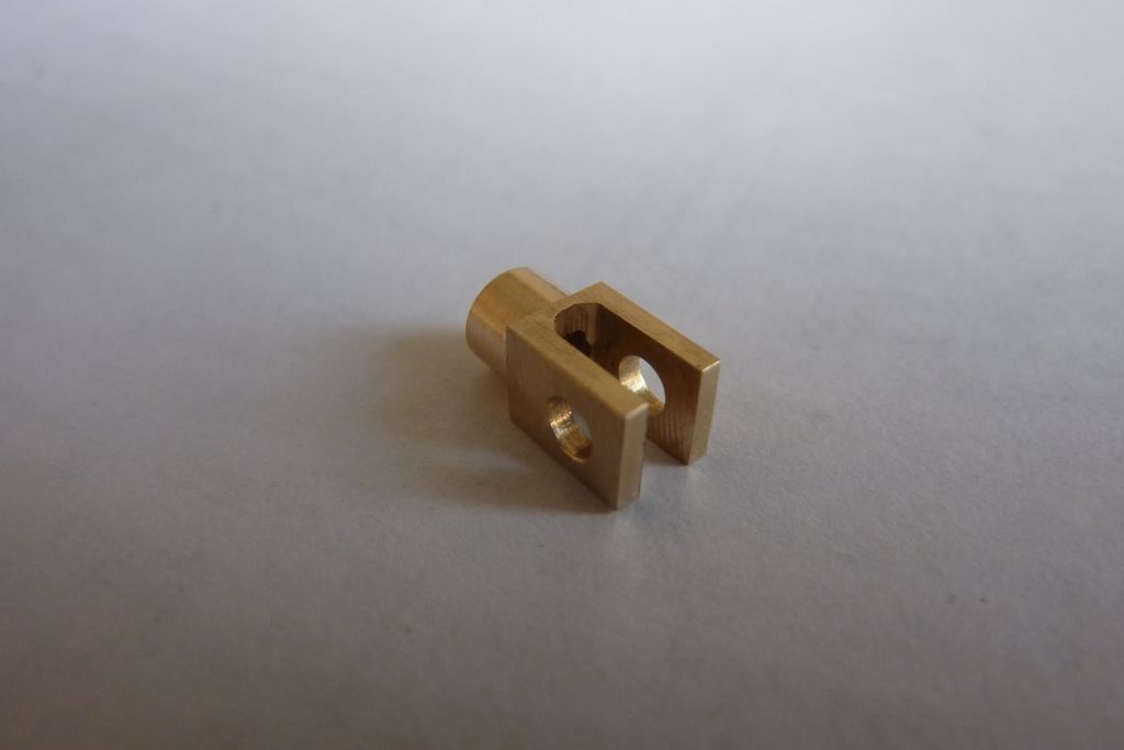

                                          GaryM
                                            @garym
                                            Well here is the result. It fits and seems to do the job, but it's not pretty. In the end I adapted Jeff's idea and drilled a piece of 3/16 bar with 7BA clearance so I could use a 7BA screw to hold it, which made working with it much easier. Slot still ended up rounded even with a flat needle file. If I decide to make another I'll try slitting it before the turning operations and while still on the stock. Might be a good learning exercise anyway as it's only a small part. I didn't fancy soldering or gluing as I thought it might take me longer to get it clean afterwards.
                                            John S – I thought I knew the Arc catalogue inside out but hadn't spotted these small clamps. Worth having some at the price (that should get you your £2 back).
                                            Again thanks for all the suggestions, even though I didn't use some of them they are stored away for the future.
                                            Gary
