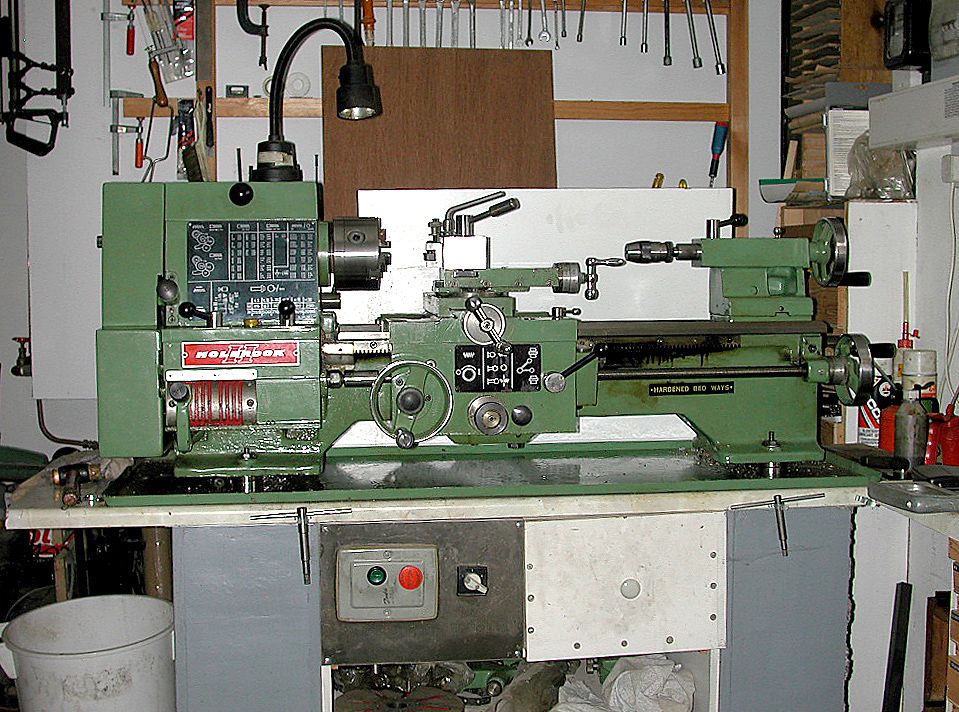

                        Hi Pete. I have created an album entitled Holbrook 10B . hopefully you can access it and get a look at the lathe.Enjoy.
                        Kind regards
                        Brian .
                        #288320
                        Bikepete
                          @bikepete
                          Hi Brian, many thanks for posting those! Very interesting indeed.
                          I've taken the liberty of embedding one of your pics here for the casual viewer (who might not click a link):
                          Looks reassuringly solid, as you might expect from Holbrook. Hope it serves you well!
                          Cheers! Peter

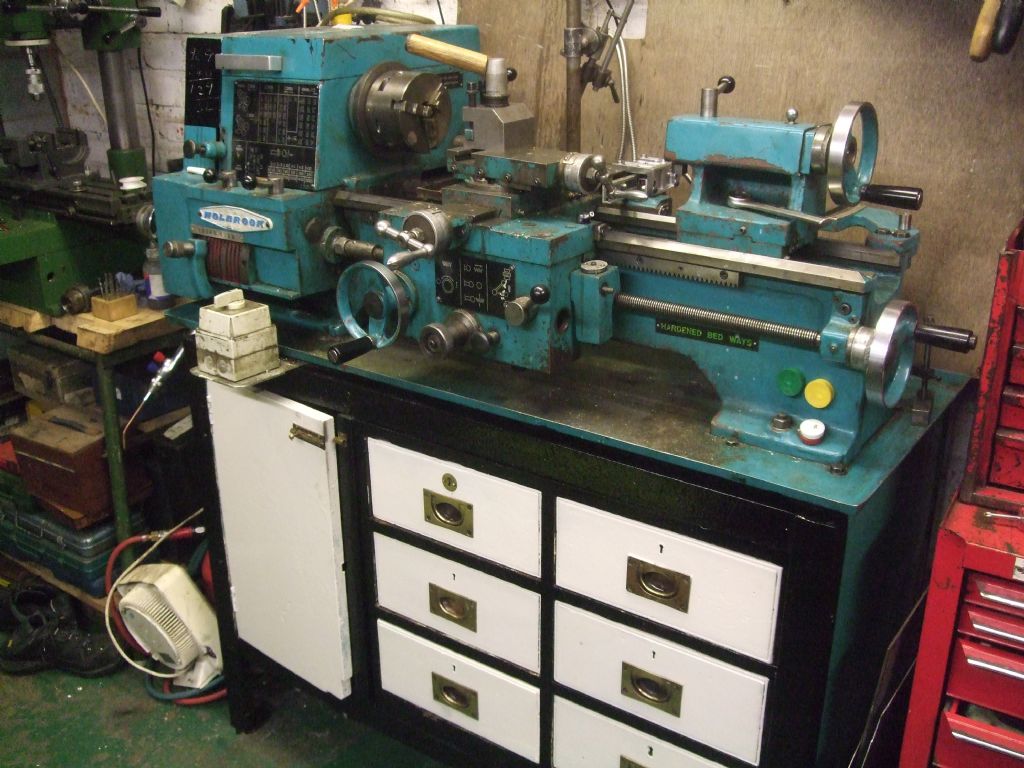

                            Hi RRMBK,>>
                            I have just come across this thread. I note your posts were nearly a year ago so I don`t know>>
                            how relevant my response will be. I too am the proud owner of a 10B. I bought it new in the early 80`s >>
                            I believe, and as I was living in the Channel Islands at the time, Richard Anderson drove across on>>
                            the ferry with it weighing down the back of his estate car to deliver and help me install it.>>
                            A wonderfully accurate machine which is a pleasure to use. Having moved to the US some years ago>>
                            it has been sitting sadly unused in the garage until I can get a permanent setup and source a suitable>>
                            US voltage motor for it.>>
                            I was not aware that they were numbered, now I am intrigued, where would I find that number ?>>
                            I have attached a photo. (I think….)>>
                            Best Regards,>>
                            Rod

                                          Looks like it is number 35 – stamped exactly where you suggested, maybe HM is Holbrook Machine or something similar. I have attached a photo I think.
                                          Regards,
                                          Rod

                                              Thanks for that – I`d had forgotten how I posted the previous picture at the end of my post, so I put it in an "Album". It should appear if you can click on the "2 photos" link under the " 4 forum posts" link under my name.
                                              Regards, Rod
