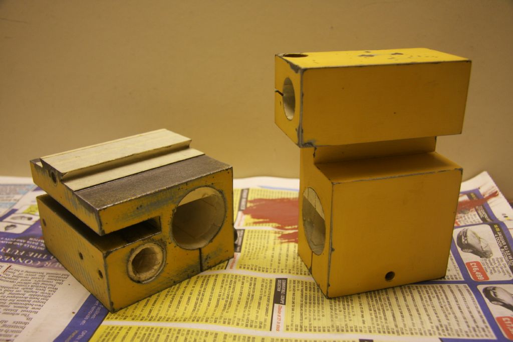

      The carriage on my hobbymat lathe moves up and down quite a bit. I have followed the instruction from the manual .It will tighten up and not move but the lead screw will not turn by hand. If I slacken the carriage off the lead screw will turn but there is so much play in the carriage. Seems a common problem with the hobbymat This is my first lathe so first dumb question is the carriage supposed to move up and down? Thanks

          The answer to your question is ‘no, it should only move in forwards and reverse direction in the horizontal plane. There will always be some movement in other directions but it should be minimal and ideally close to zero.

              Hi Barry, I presume that the black plastic segment is still present and intact, which is in the top of the bore that the carriage slides along the bed on. Seen in the photo below with masking tape on.
              Ready for Paint job 2
              There should also be one in the tailstock. However, as has been said, the adjustment is very finely balanced between being too tight or too loose. Otherwise you may have serious wear in one or the other or both.
              Regards Nick.

                  The black plastic segment is there but the carriage and the segments are moving independant of each other giving the play. how does the black segment hold in place? Thanks
                  #407087
                  barry
                    @barry
                    Just taken the carriage completely off and the black plastic bit is at a slight angle so when I tighten up only one side of the plastic will be touching and tht is what is locking it up and giving it the play. Cannot see how to move the plastic bit. Any ideas? Thanks
                    #407110
                    Nicholas Farr
                      @nicholasfarr14254
                      Hi Barry, I believe they are bonded in place. I could not remove those in my photo above, hence the masking tape on them before repainting.

                        I have managed to solve the problem. The plastic was held in by 2 steel pins. The plastic holes had become larger than the pins so was giving a slight movement. Turned the plastic around, drilled 2 new holes in the plastic, inserted more steel pins, the carriage has no play in it now and was easy tlo adjust. Hope this helps anyone else who has the same pronlem. Thank ypu.
