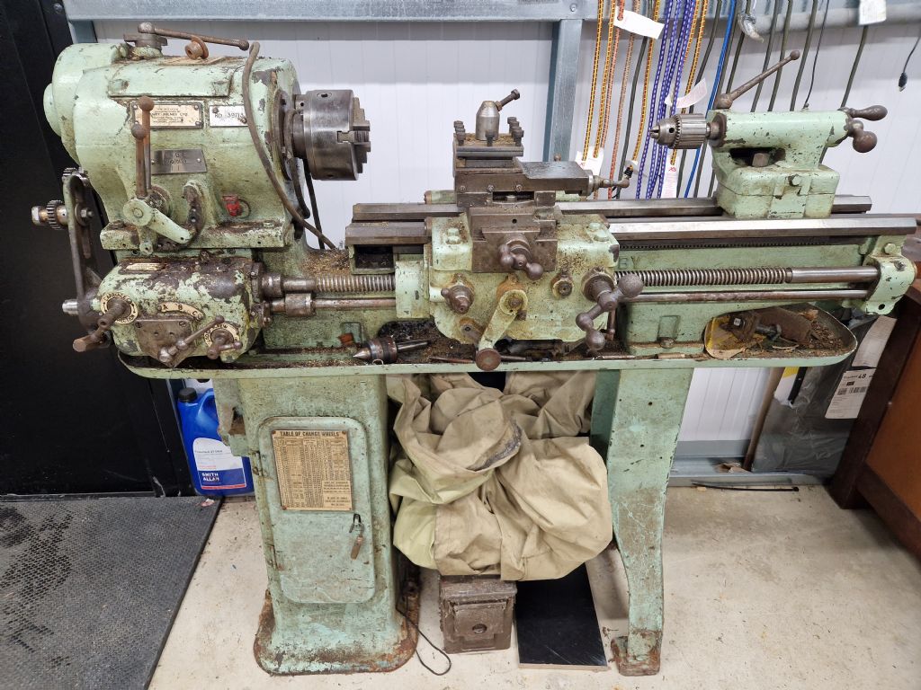

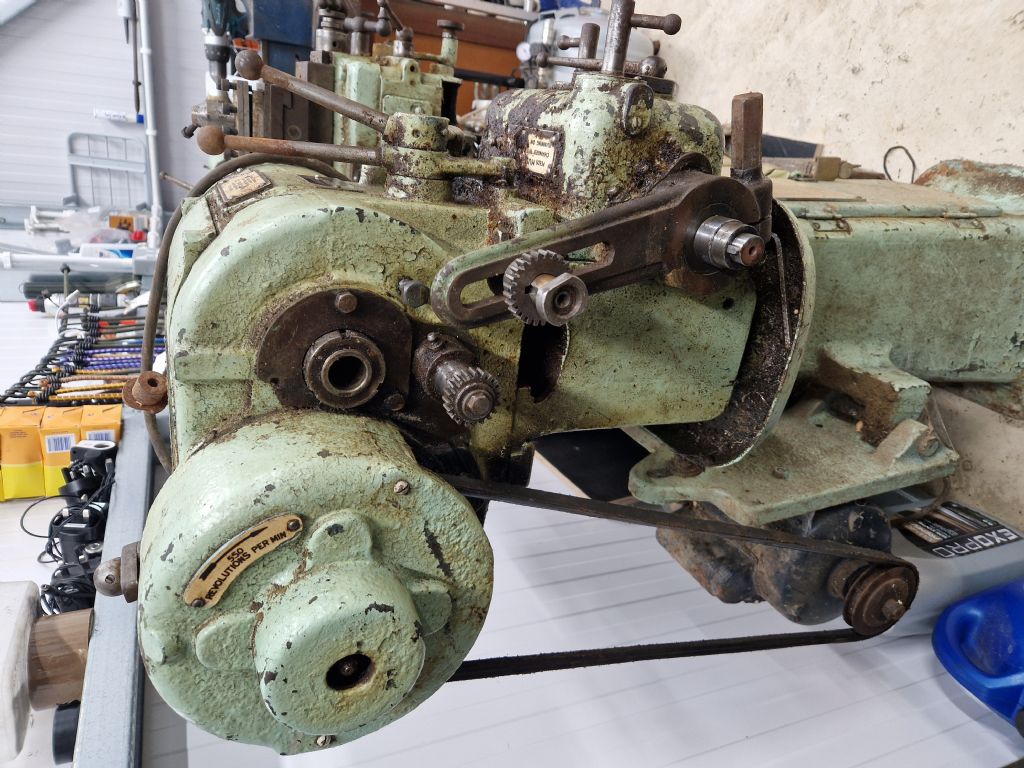

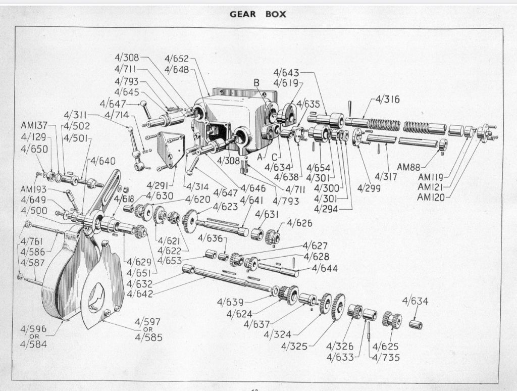

      Hi all I have recently joined. I own a Henry Milnes DF4 lathe (Denham Junior), I bought the lathe almost 30 years ago when I started college. It belonged to the workshop technicians father who had recently passed away, he estimated that it was probably dated from late 1940s. It has served me well over the years. My problem is that change wheel guards are missing. (Part 4/ 596 and 4/597) It has been like this since I bought it, but now I would like to replace them and give the lathe a overhaul and a new coat of paint. Would anyone with the same lathe be able to draw around the profile of the guards and provide some measurements so I could manufacture them? I did post this on Facebook group machinist museum but unfortunately no response. Thanks Darren
      II have parts manual but I can't workout how to attach relevant page

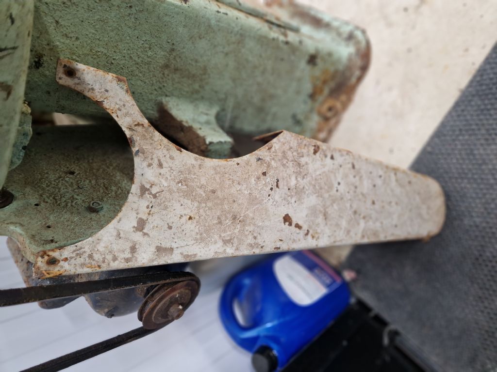

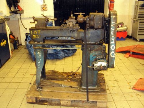

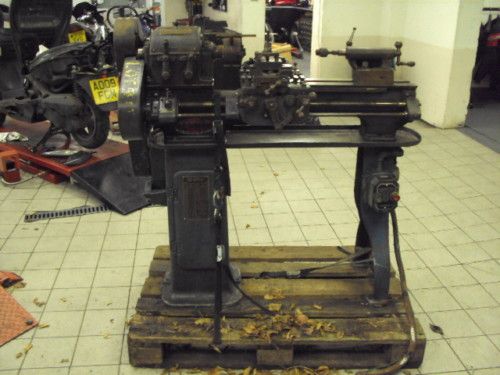

                  @ady1

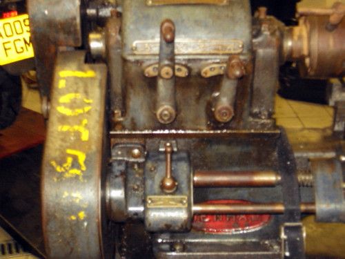

                  I think it depends on the lathe
                  Got a couple of piccies here with a full length job
                  Edited By Ady1 on 13/11/2022 09:56:24

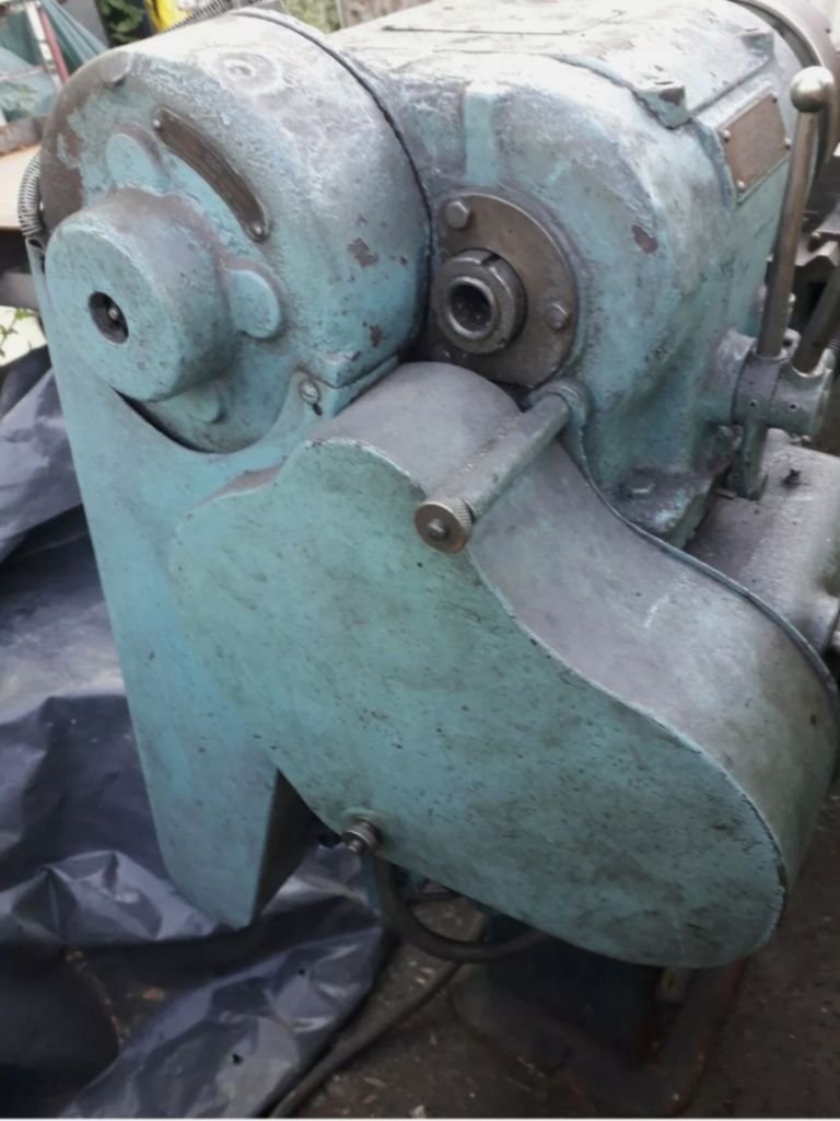

                    Hi Ady, thank you for that it dose look similar to my lathe but the headstock is different. I do not know if the guards would be the same ? I have attached a image I found on Google of the guard I need.Guard
                    Edited By Darren Reid on 13/11/2022 10:06:25
                    #620871
                    Ady1
                      @ady1
                      Your picture looks by far the best one for having a go at fabrication, plus you have your fixed points at the securing screws
                      Make up your inside plate first and then use it as a template for your outside effort would be my route

                        #620874
                        Hopper
                          @hopper
                          Make a cardboard and tape mock-up based on the pic above and then check it has clearance for the gears and banjo when the largest and smallest gears are fitted throughout.
                          #620875
                            Posted by Darren Reid on 13/11/2022 10:05:50:
                            Welcome to the forum Darren.
                            In the event the measurements aren't forthcoming, perhaps no-one has the same lathe as you, it may be necessary to reverse-engineer a guard from the lathe and photo.
                            It can be done by cutting cardboard sheet to the approximate shape and size, offering it up to the lathe, and progressively trimming to exact size. It would start by identifying the fixing points on the lathe. May take a few goes to get right, but you end up with a cardboard replica that can be dismantled and laid out flat as a template to cut the sheet metal shapes needed to make a real one.
                            As the cardboard replica has to hold together, thinking about it's joints will inform the real build.
                            Sheet metal isn't my thing, but the original guard looks to have been stamped, rolled and maybe crimped from cheap mild steel sheet with pricey equipment you don't have. Several alternatives depending on what you have and depth of pocket. Do you have tools for cutting and forming sheet metal? Do-able with basic tools, but as always the job is easier when the right tools are available.
                            For an exact replica, wooden formers may be necessary. Brass is easy to work and can be soft-soldered but is pricey. Aluminium is cheap, but difficult to solder, so pop-rivets or nuts and bolts. Steel is nicely in the middle, especially if welding is available. If safety is the only concern and looks don't matter, keep it simple – a boxy plate and wire-mesh construct quickly bodged to fit would do.
                            However you do it, it's an interesting challenge. Can you post updates please – be good to see how you get on. It's a learning experience!

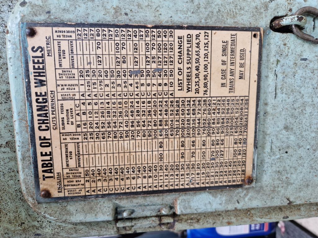

                                  At the risk of flogging a dead horse, you might be able to improve on the original guard.
                                  If it is necessary to use a 127t gear on the leadscrew for metric screwcutting (maybe not something that was thought of when the machine was mde), you could make the guard suit that gear.
                                  #620901
                                  Darren Reid
                                    @darrenreid51999
                                    Hi DC31K another great suggestion, I just checked the change gear table and it was originally designed with metric included with the 127t gear as you stated.
