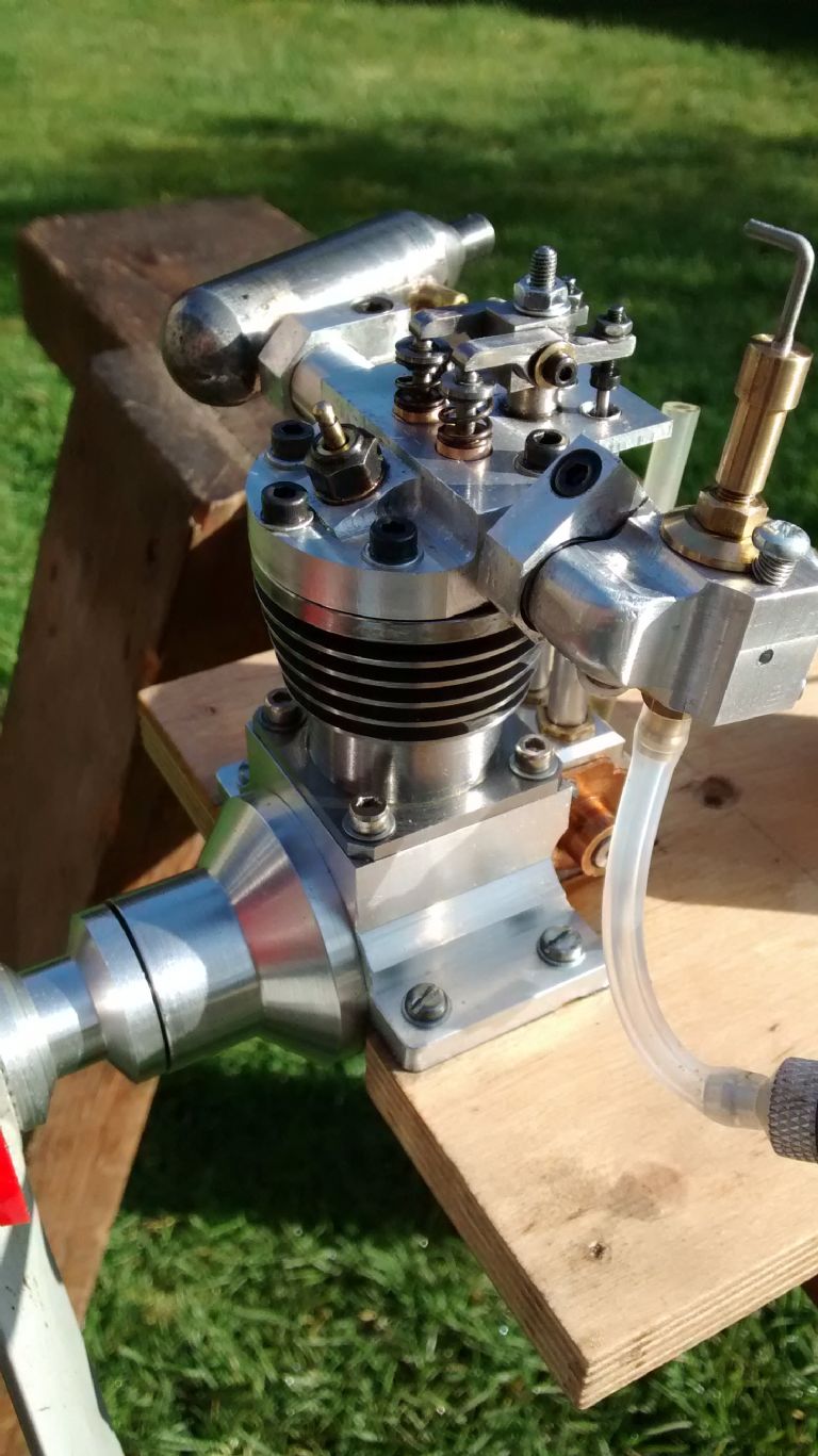

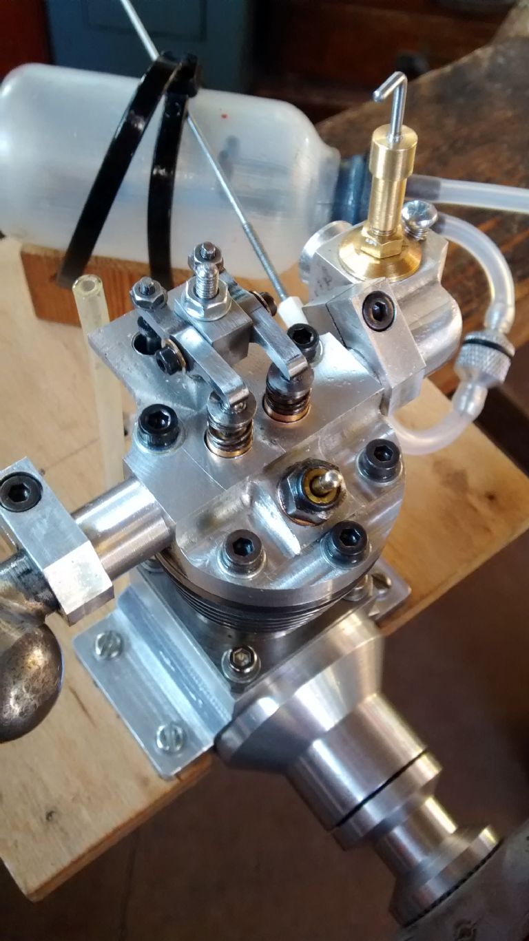

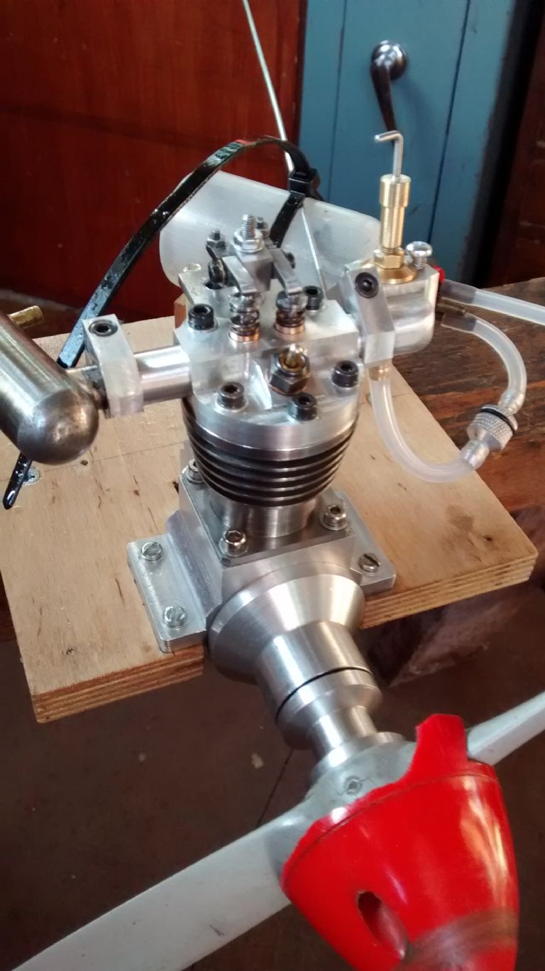

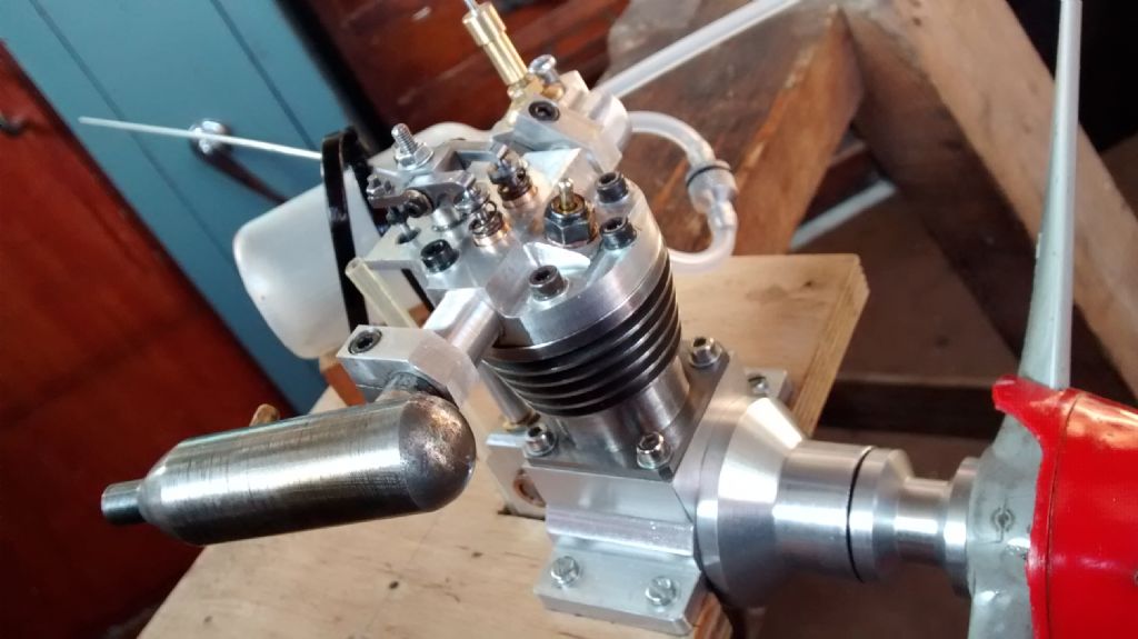

                          Here are a few images Rod, not sure how to get a video in

                              Mike, very nice indeed – much prettier than mine. I posted a video of my Wyvern by putting it on Youtube and then posting the link using the Youtube button in the reply box.
                              As to Neil's point, if anybody would care to give some figures for the maximum speed with prop diameter and pitch for their Lynx then I can calculate the HP, at least to the same accuracy as my Matador.
                              Cheers,
                              Rod

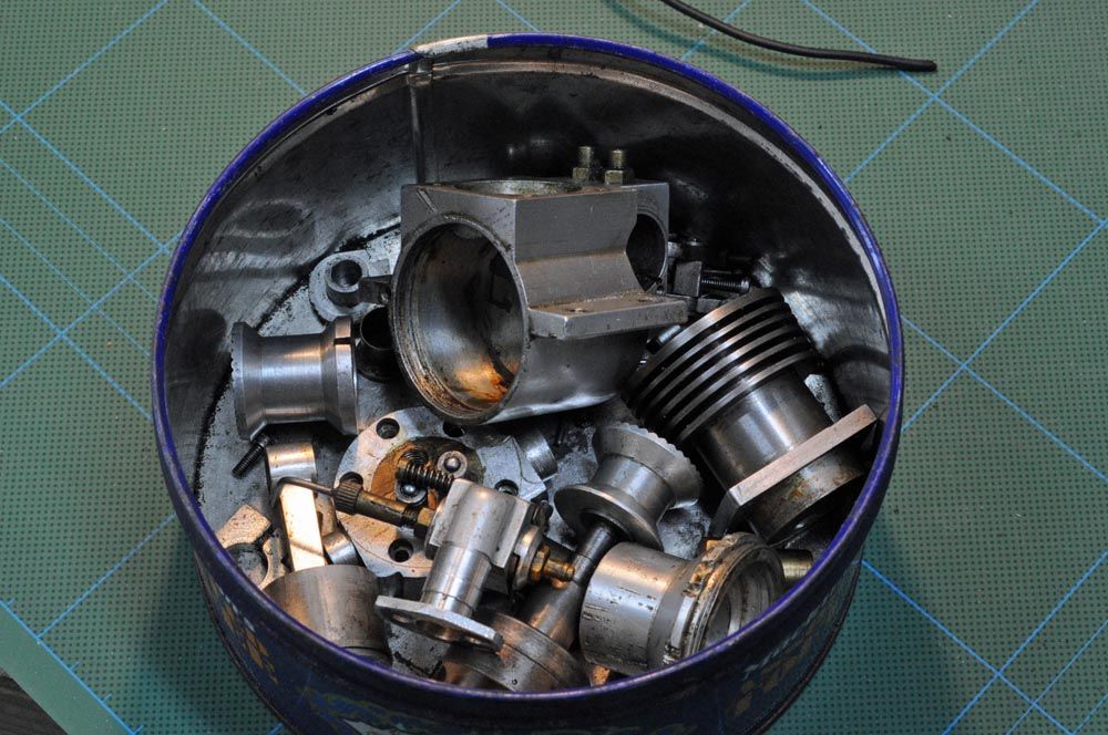

                                                  Posted by Kevan Gillings 3 on 26/04/2019 18:36:31:
                                                  do you have a photo of your motor ?
                                                  Kevan
                                                  Well, you did ask frown
                                                  Needs a bit (!) of refurbishment. It used to run very nicely…
                                                  Rod
