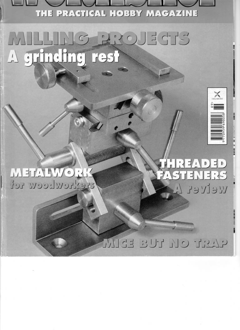

                      The Grinding Rest was originally an article in MEW 89, part of a series which Harold later turned into the book. The cover picture from that issue is shown below, as I think it is a better pic than those in the article.
                      There were machining instructions for each part, and plenty of drawings, including an assembly drawing.
                      Looking at these together, where's the problem?

                        The only problem I have with mine is that in some positions the locking handles interfere with each other.
                        Russell.
                        #118453
                        roy entwistle
                          @royentwistle24699
                          Try instering washers under them till they don't interfere You may have to thin some of the washers
                          Roy

                                    The old way of avoiding a clash between the operating levers was to leave them until last. Assemble everything, tighten up the screws which are going to have levers, by whatever means possible, then mark the position for the levers so they don't clash.
                                    This is one of those things that you always remember when it's too late! For those of us who forget, Russell's washers are the answer.
