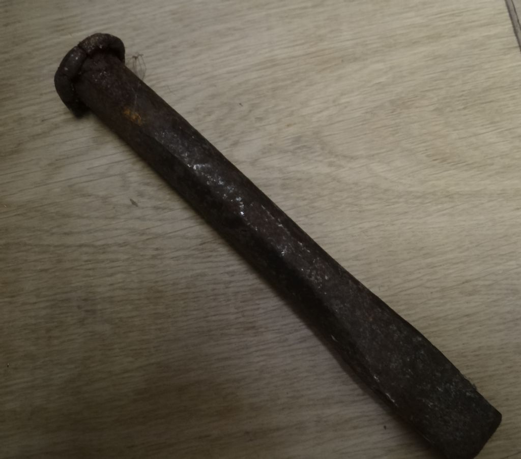

                I only harden what needs hardening. Hard and brittle often go hand-in-hand, so not good to hammer or snap hardened steel.
                This commercial cold-chisel has a hardened tip and soft end. The soft-end has mushroomed out and needs trimming back, but even like that the soft metal is less likely to spray shrapnel about.
                For the same reason it's not recommended to bang hammer heads together. As both are hardened, any splinters formed are likely to come off at high-speed. Not funny if a shard goes in your eyes. (Not that hammers are particularly inclined to splinter. I've accidentally clashed them many times without ill-effect. But why risk it…)
