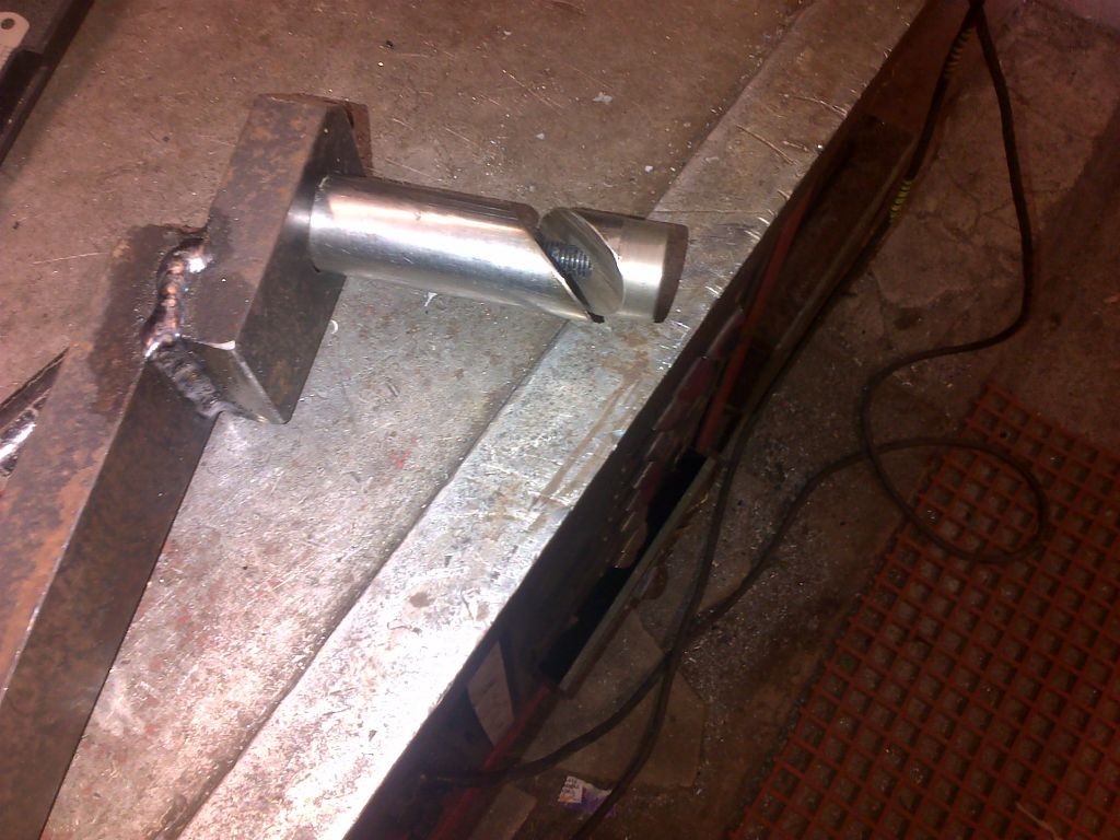

      after struggling with cutting finer threads and getting decent finish on coarse threads due to slowest speed i can run my clarke cl430 is 160 rpm.
      i decided to make a hand crank for it, got idea of bedroom workshop where they had used a handlebar stem to make one.
      spindle bore on cl430 is 26mm so had to make one from pce of stainless i had lying around and a heave handle from the might come in useful pile.

          Simple and effective.Neat weld too.

            thank's will tell my 7 yr old boy.
            i only tacked it let him finish weld it, as he needs to practice.
