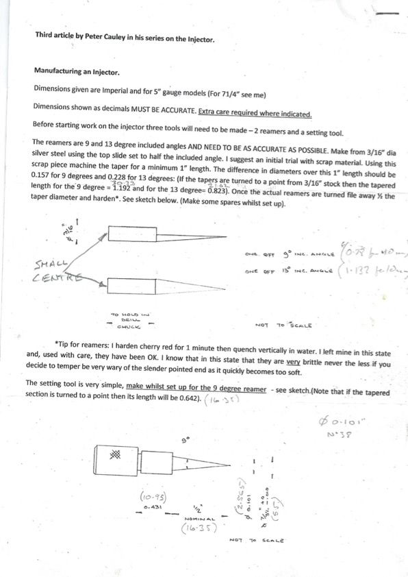

        May I ask what may be an obvious question to some?
        In the "Injector Wars" in Model Engineer (19 November 2021), mention is made of using custom-ground cheap and cheerful hacksaw blades as reamers for injectors.
        How are the reamers used? By hand? Powered and held, or done on the workbench? Blade in a tool-post?
        I'm just wondering how one would use one accurately.
        Thanks; John.

          John, when making the injectors, there are tapered holes in the cones. These are reamed with home made taper reamers. I can only assume that the author was grinding a piece of hacksaw blade to make a flat reamer however these reamers are very small and some cones are drilled with a number 80 drill 0.0135" dia being the small end of the reamer.

              Yes, these reamers could be considered a variation on the D-bit… but I too am puzzled by how to hold them concentrically, consistently and accurately without a purpose-made holder. They'd need lean over only very slightly to mis-shape the cone.

                A few years ago I started building about a dozen Derek Brown 12oz injectors, then but life took over, and the D-bit style reamers were only half made. The cones are the last thing to do before testing them, so I have to finish (or make a new design of) reamers.
                Nigel; Bob Bramson wrote of an interesting way of holding the D-bit style reamers for milling the flat – in essence, one supports the reamer with soft solder in a half-circular groove, which after machining is then melted out, so I don't think the solder bath idea (although a great idea) would work. But, what do I really know!
                I did make a Worden grinder, so I could grind HSS round blanks, I guess, but the idea of taking a cheap hacksaw blade and make a reamer out of it sounds like a nice little thing to do as an experiment. Also fits in with my Scots heritage.

                    I have made 5 of these reamers, different angles etc. Just harden the silver steel and let them down carefully with a gas torch. For one offs they seem fine, probably need to touch them up on a diamond stone every now and again if making multiples.

                      I made all the readers as per DAG Brown ,turned the taper hardened then ground in the t&c grinder and the tempered in domestic oven. They work a treat.

                        The hacksaw blade reamers in the ME article are held by hand.

                          For the education of this innocent … could someone please just let me know the approximate size and shape of these reamers
                          I am bewildered, because I thought that in “Model Engineering” circles they [injector reamers] would typically be very small
                          … Presumably there is another component part which needs reaming dont know
                          Sorry to be a dim-wit but it’s niggling me

                            Back in the day every model engineer would have had a few broken hacksaw blades and kept them as a ready source of high carbon steel. (no bimetals in the shed then) They might soften the end of a piece and cut it at a fine angel with a chisel, filed close to shape, hardened and ground on an ordinary oilstone. It would be kept on the parent strip as a handle which probably still had some of it's teeth so a bit of rag protected the hand.
                            Typical size might be 1/8 at the thick end tapering to almost nothing over an inch, remember also that the target loco would most likely have been 3 1/2 in gauge so everything smaller than common today.

                              Michael, The readers are made from 5/32” dia silver steel/ hss depending on how you are equipped. The angles in DAG’s book are 6deg, 9deg and 13deg incl. with tip sizes typically 0.015”. I suppose micro grain carbide would be a fun thing to make them from!!!

                                  For Michael's "education"

                                      The hacksaw blade as such is simply the source of a thin flat piece of steel. which is shaped to to give the required cone angle in the finished part.. The cutting edge is along the corner between the top (or bottom) and side surfaces The illustrated reamer may be just a half cone angle which would be easier to produce.
                                      This is a means of producing a reamer without needing to remove half the material from a machined cone to produce a cutting edge, and without hardening the resultant part, both of which can cause problems, From the text of the article, one was produced in about two minutes, so a considerable time saving compared to the traditional method.
