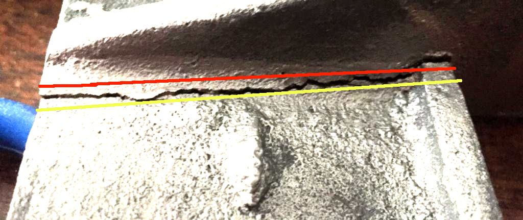

      I need to buy a grinding stone for my dremel to grind a V in a crack in a cast iron plate. Is aluminium oxide going to work? Will it last long? Is there something better I can use?

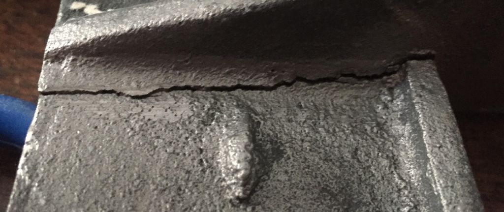

                              It's approximately 2" long in a 1/2" thick plate. Some of it is in a corner, that's why I wasn't going to go for the angle grinder option, difficult to get in there and do a tidy job. Really just wanted to know what material was best to grind cast iron. I tried one "pink" grindstone, it was from a cheap multitool and it really isn't lasting very long.

                                            crack.jpgPosted by Dave Halford on 13/02/2021 11:58:53:
                                            Might be better to use the dremel cut off disc's at an angle to the cut then snap a chuck out with a screwdriver blade. Don't push the dremel, be a shame to cook it.
                                            Dont forget some cast iron welding sticks cannot be machined easily.
                                            Edited By Dave Halford on 13/02/2021 12:00:42
                                            Can't get into the corner with a disc.
                                            Edited By pgrbff on 13/02/2021 12:36:05

                                                    Hi pgrbff, if it were mine, I would cut along where I've drawn the yellow line first, with a thin in a 4-1/2" angle grinder, aiming aim the best I could judge, to the bottom of the crack and then along the red line as best I could. Don't worry about trying to get into that little corner and you can build the shape back up with weld or brazing.
                                                    Regards Nick.
                                                    P.S. You can always tidy the V up and take any dirty bits out with a small stone or burr in your Dremel.

                                                      Posted by Nicholas Farr on 13/02/2021 15:43:10:
                                                      Regards Nick.
                                                      Edited By Nicholas Farr on 13/02/2021 15:47:37
                                                      As Nick says above and use these and clamp it to something so it can't move. Nickel is not a hard metal so will machine with HSS, note it says for hot and cold welding and they are being sold by a proper welding supply company.
