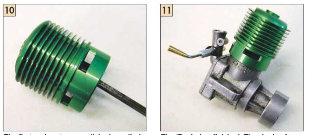

                Have a look at Ramon's article in MEW 194, gets a nice shade of green there

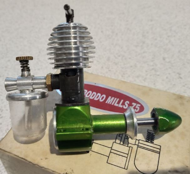

                        capture finished boddo.jpgHi Thanks for all the suggestions . I finally found a dye that worked for me. Green Ink ! It had to be ordered from China to get at a reasonable price but gives a good effect . The pic below is a crankcase I made for this little Boddo Mills as the original was made of rubbish metal and just plit open while in storage ? The spinner nut is the original and you can probably see the anodising is flaking off ! glad i didnt anodise the cylinder !!
                        Id still like to know what Ramonused on his engine ?
