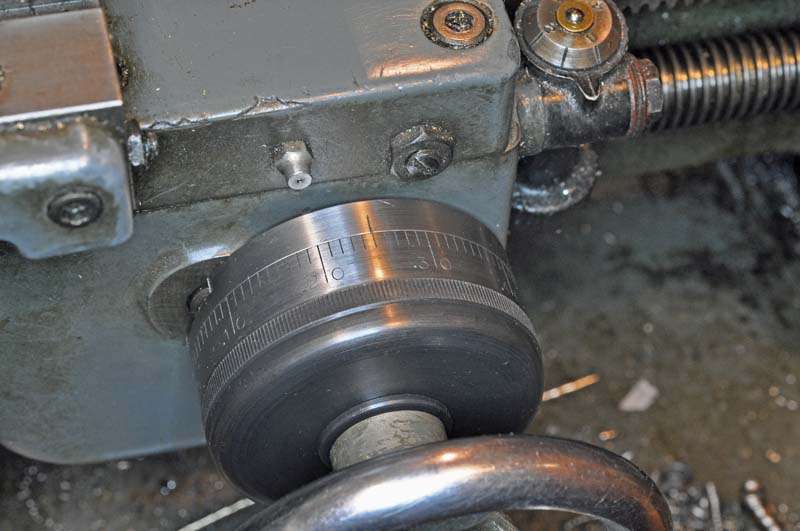

                    Here’s the one I made.  The point is that it’s on the carriage so is geared to give a known increment per revolution on the rack.
                    cw1
                    However, I have no moved on to a DRO and find it extremely useful – far fewer mistakes in mis-reading dials.

                      Thanks, very fine engraving on that but difficult to read without good lighting. The ones I like are the black on white of the Hardinge lathe – if only!

                        These are the commercially made ones for those that don’t seem to be able to search for themselves. No disrespect to Rod but their engraving looks a bit more defined, possibly filled with black. But if making one yourself there is no reason not to fit a ring of white material and fill in the engravings with black paint etc.

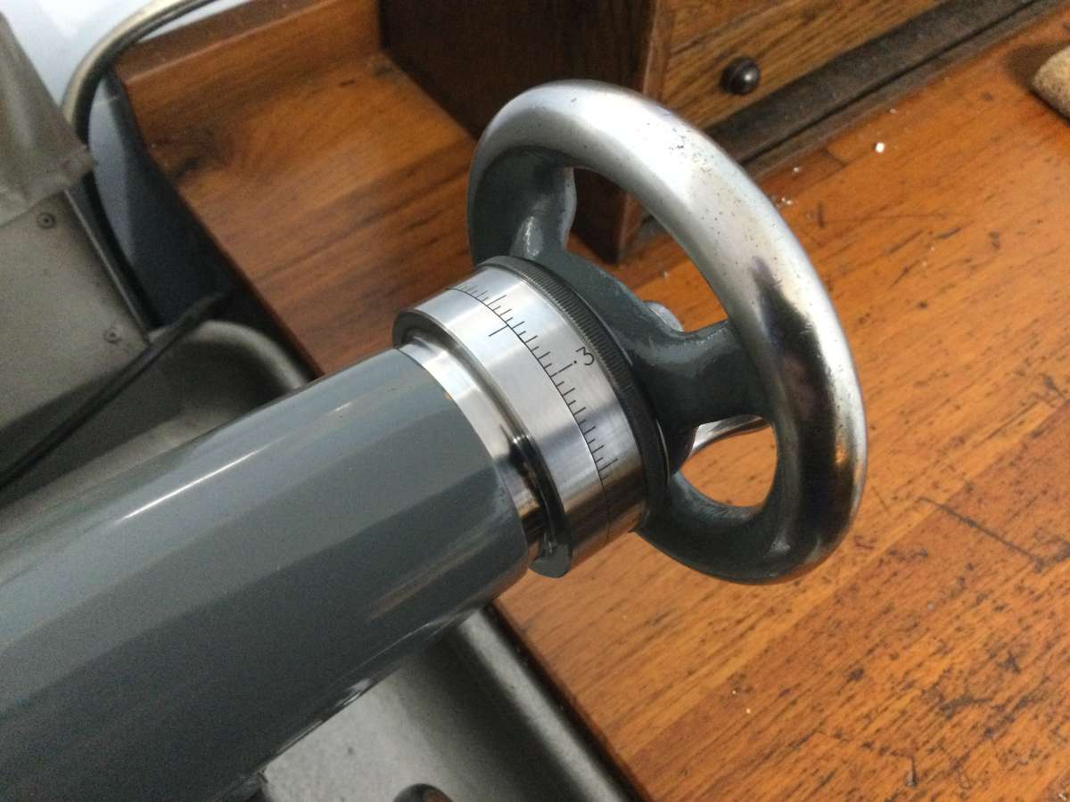

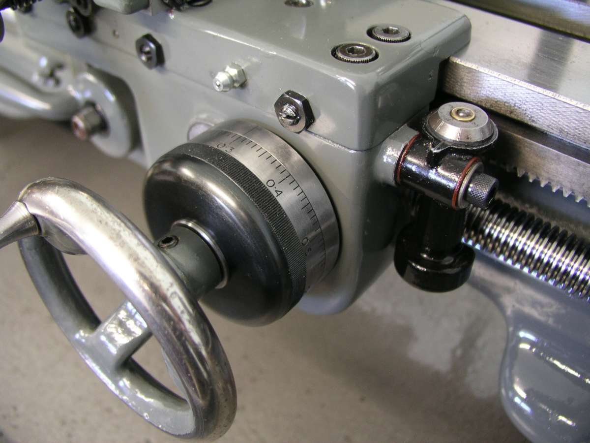

                                I made one of these 10 years ago, and it is one of the most useful accessories I have ever made. Can be made in a weekend if you have no distractions. I filled the engraving on mine with black paint, and I have no trouble reading it. I also made Gray’s tailstock micrometer dial, which is another great addition. Photos of both my dials below.

                                  Very nice wheels Mike, how did you get the numbers so nice? Punched?

                                    Nice job Mike, They look as though they were always fitted to the lathe from new.

                                    There is no backlash problem with either of the dials, internally there is adjustment to minimise any backlash. Also provided the Dials are adjusted in the direction of travel all the backlash on the Myford side of things is already taken up.

                                      I am fortunate to have a Taylor-Hobson pantographic engraving machine which I picked up very cheaply many years ago. A bit fiddly to set up, but produces nice results.
