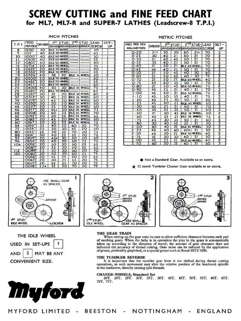

            This chart may help:
            ml7gears
            The chart shows the combination suggested by Noel at bottom left, and there’s an even finer setting.
            In principle, finishing calls for a gear combination that steps down from a small gear on the spindle to a big gear on the lead-screw.  Using Noel’s example:
            • 20 teeth on spindle (small) drives 65 (large) on  compound
            • 65 turns a 25 toothed gear (small), driving 70 teeth (big) on the next compound
            • 70 turns a 20 toothed gear (small), driving 75 teeth (big) on the lead-screw
            The diagrams show how the gears are arranged. I don’t own a Myford, but I think you want arrangement 3.   Someone will correct me if the guess is wrong, or try it and see.

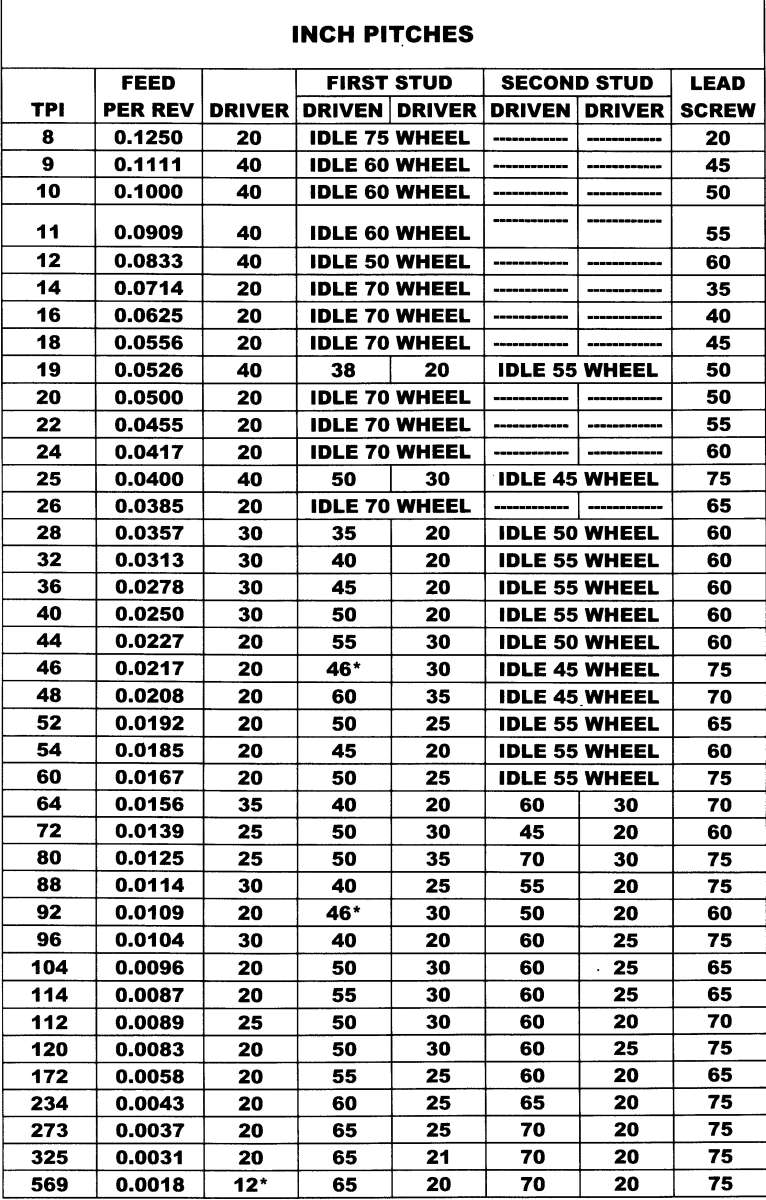

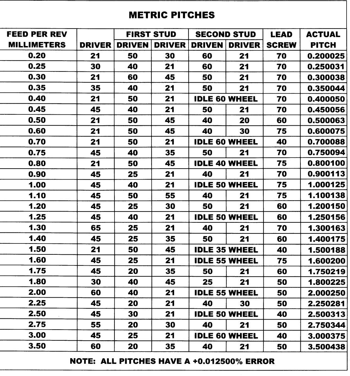

                  I have made these charts that hang on the wall behind the lathe. They are printed off 8 1/2 X 11 and laminated. They are a lot easier to read than the ones in the gear cover. The last 5 or 6 entries are the turning fine feeds. I have them as PDFs and JPEGs. If any one would like a copy to print off for their OWN USE send me a PM.
                  Change Wheel Chart Imperial
                  Change Wheel Chart Metric
                        Does that mean I cannot have fine feeds in metric?
                        The 0.2mm pitch is 127 tpi, which is within the last six of the other chart.
                        It could be useful to extend the metric one upwards as far as possible.

                                  The charts I included above are just a copy of the Myford charts that were made to alleviate bending down and trying to read the small ones in the gear cover. They were never intended to include all possible pitches/feeds available with the normal set of Myford gears. If someone wants to expand on them, please do. The originals were done in Excel.
